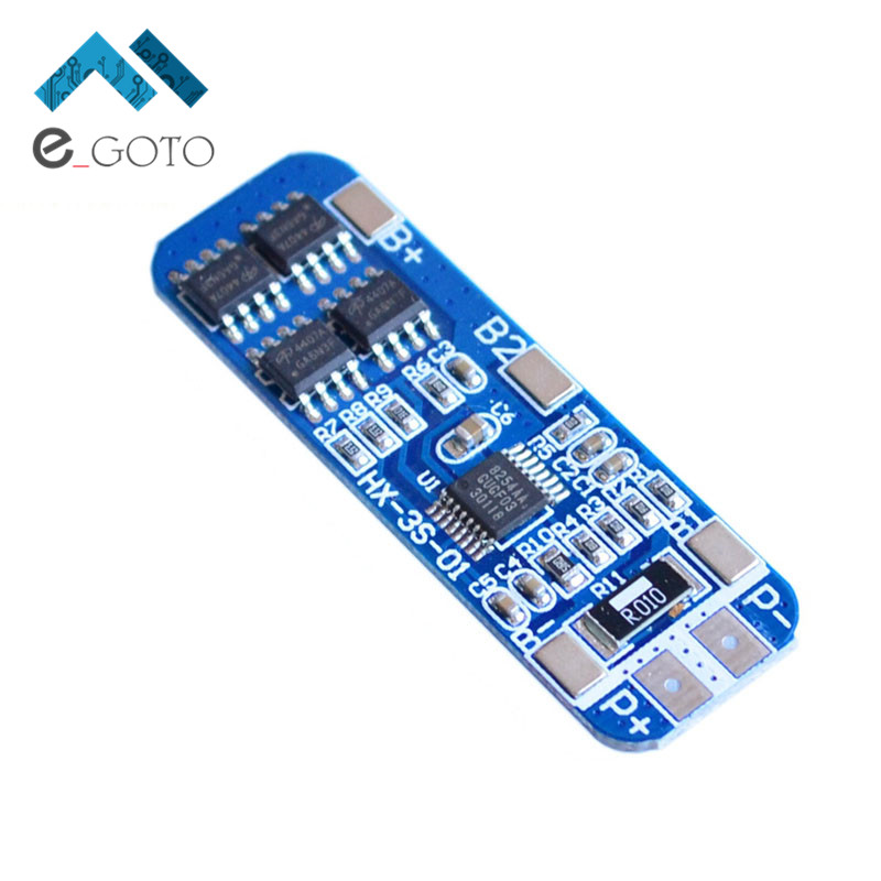

    Hello, is there a module thanks to which I will be able to charge a pack of 3 li-ion cells?
    I found one, but I'm not sure if it has charging options (you can't see any LEDs indicating the charge level).

    The catalog card says:
    Technical parameters:
    Voltage: DC charging voltage: 12.6V CC / CV
    I am not sure if I understand correctly ...
    So the module has cell charging options yes?
    In that case, how do I know when the loading process has been completed?

    There is a LED description on the board, it looks like two LEDs, probably to indicate the charge status.

    The specification sent by "zbigniewsk" concerns another module.
    What does it look like with my module? He has only understood the protective function so?
    3S Li-ion Charging Module: Find a Suitable Module for Charging 3-Cell Li-ion Battery Packs
    Why is P- and P + signed as "charge"?
  • #6 16620763
    kwazar
    Posts: 929
    Help: 150
    Rate: 121
    How is that why? After all, you connect the charging adapter and load there. The system is a safety device against overcharging during charging, and against excessive discharging with connected load.
    He keeps an eye on the battery.

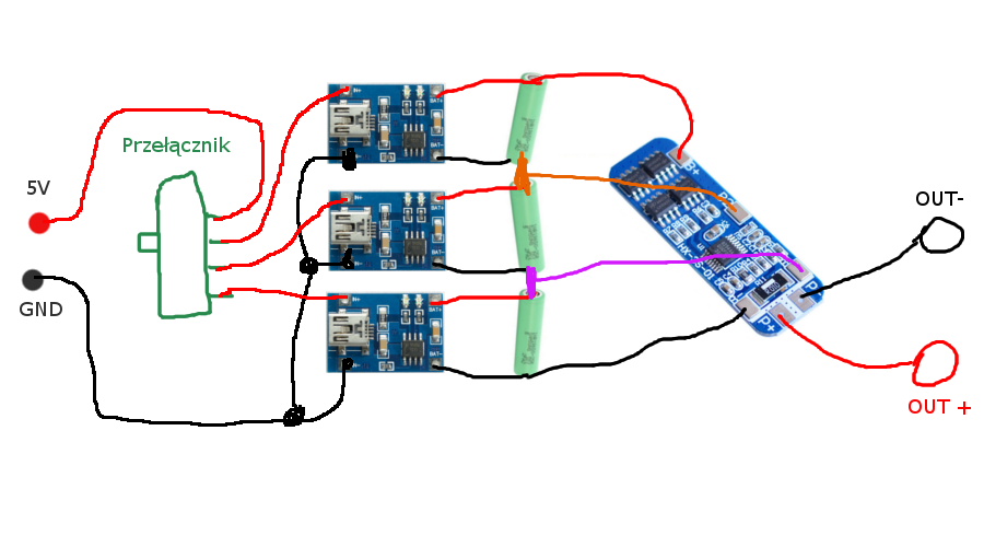

    I understand, I have one last question.
    Could such a scheme work correctly and safely charge the cells?
    #12 16621369
    goldi74
    Posts: 8058
    Help: 1367
    Rate: 1539
    Unfortunately, this arrangement will not work. For it to work properly, each TP4056 module would have to have a separate 5V power source or the switch used had 2 sections so that, in addition to plus, it also switched minus power supply. Power cons and pluses cannot be directly connected to each other permanently.

  • S-8254A is a protection IC, not a charger
    #17 16634185
    LED5W
    Posts: 2302
    Help: 264
    Rate: 162
    @gumisie Zajrzyj do noty katalogowej układu scalonego to zobaczysz, że to układ zabezpieczenia ogniw, a nie ładowania.
    http://datasheet.sii-ic.com/en/battery_protection/S8254A_E.pdf
    The S-8254A Series is a protection IC for 3-serial- or 4-serial-cell lithium-ion / lithium polymer rechargeable batteries and includes a high-accuracy voltage detector and delay circuit.
    The S-8254A Series protects both 3-serial or 4-serial cells using the SEL pin for switching.

    Look at the integrated circuit catalog note and you will see that it is a cell protection system,
    Layout, layout, module, module. Buddy, what do you think the protection of links is :?: . Read and understand the specifications of this module. https://abc-rc.pl/modul-ladowania-ochrony-ogniw-li-ion and do not provide links to any page from which there is a problem.
    Best regards.
  • #19 16634243
    LED5W
    Posts: 2302
    Help: 264
    Rate: 162
    @gumisie I corrected the link. Protection consists in cutting off the cells when the voltage or current exceeds the permissible values. There is no other system there, so what do you think, what is the limitation of the charging current in this module? And where is the charging current in this specification?
