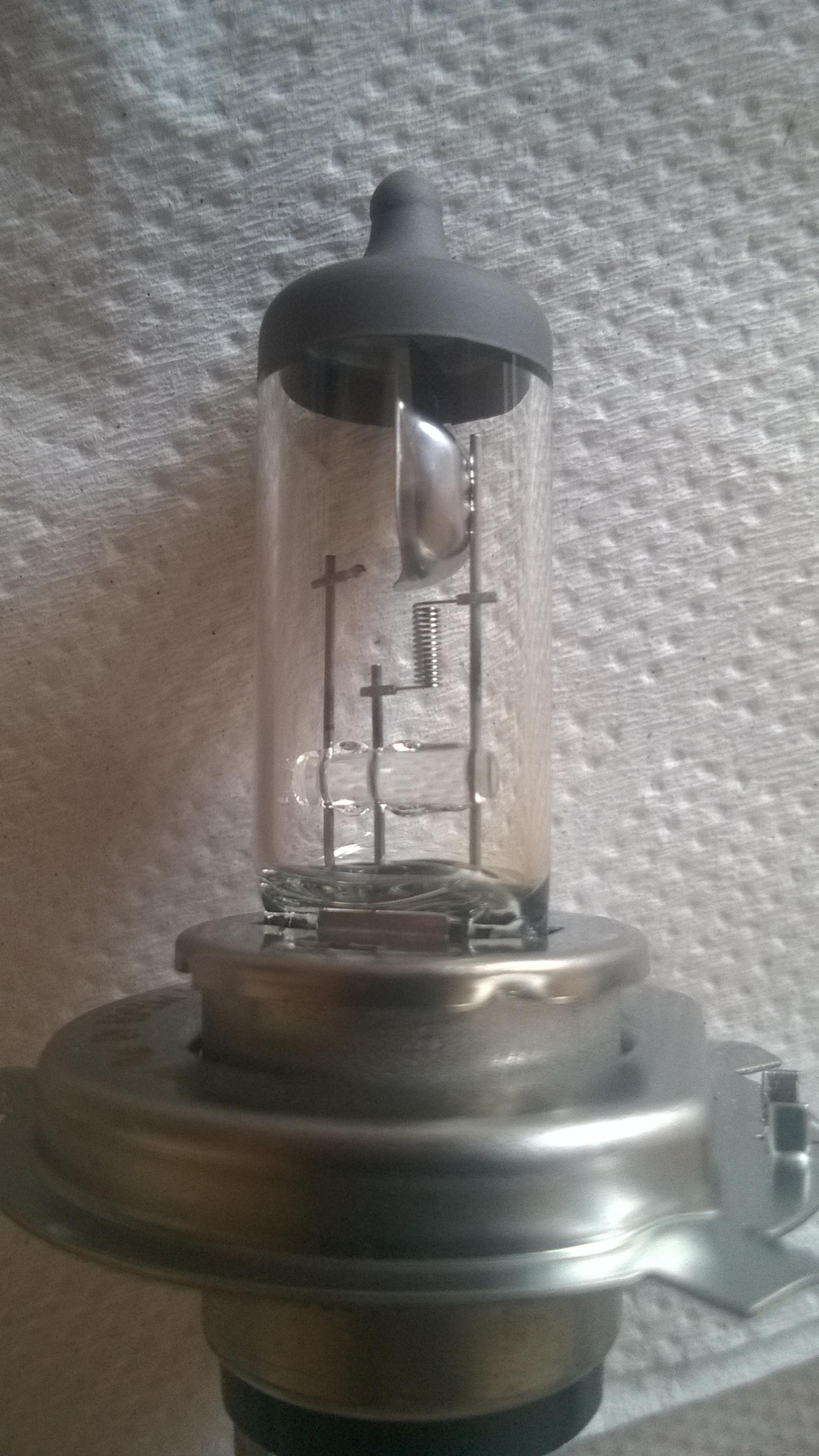

    The dipped beam headlights have gone out while driving. The rest of the lights (parking, road), indicators, etc. are working properly. Only the low beam does not work. Fuses checked. One was slightly burned. I replaced it. What could be causing the lights not to work?

    Adds a picture of a bulb. Burned out?

    Hello .
    You can check the bulb (s) with a piece of wire attached to the battery. If good, check the power supply at the lamps, with a lamp made of, for example, 12V / 4W.
    Best regards.

    szpoak wrote:
    The bulb is burnt
    Seicento 900 - The dipped beam does not work, the rest are approx
    Thanks. So both burned :) I will buy new ones and let them know ;)

    Problem solved ;) I changed the bulbs and it's ok ;) . Thank you for your help
