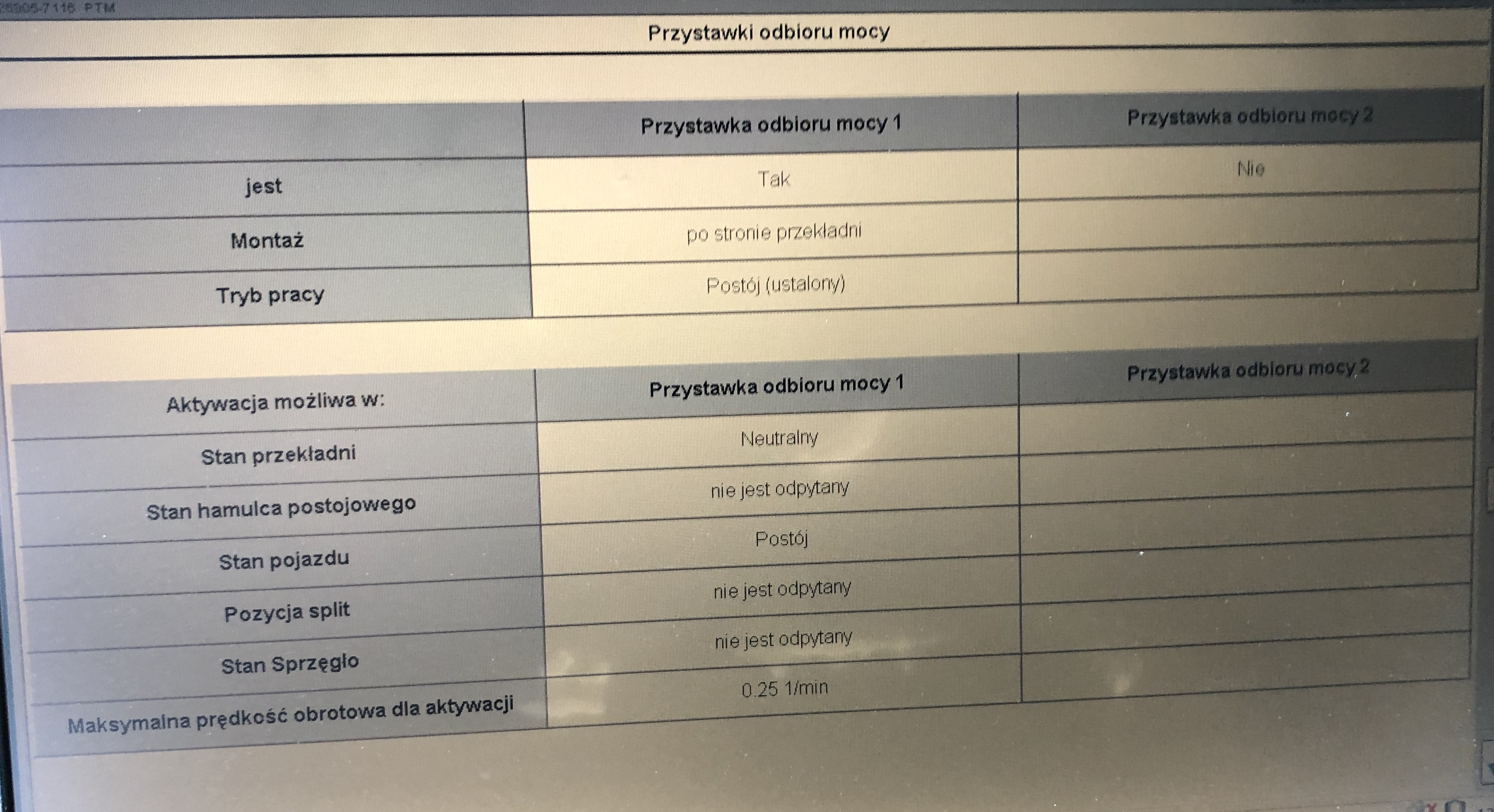

    The problem is that there is no PTO in this car. Maybe she was and is gone and the computer doesn't know about it? is it programmable? How do I add an appetizer?

    Yes, it's optional and can be removed if you don't have the snap. MAN Cats can handle it.

    As for the error, invest in a valve or prepare a suitable resistance connected to the default PTM output and the error should disappear.
    Where is the option to disable this in mancats? I only see the VU test options.
    I only have a preview that it is active (power take-off 1 YES)
    I found the harness cut, but are these 4 cables. (marked 70 157 70 391+permanent after the ignition switch 70 393 and brown.
