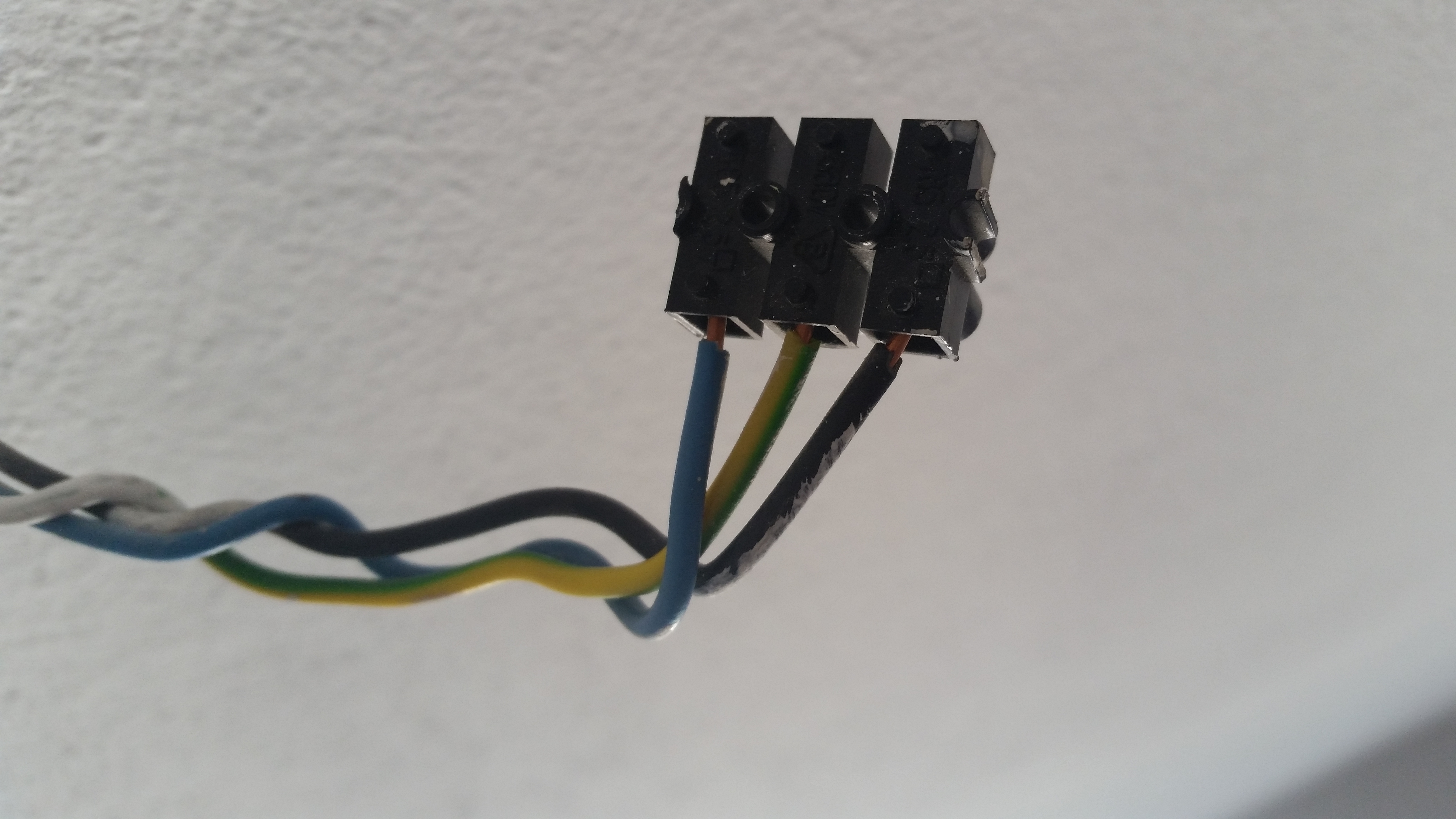

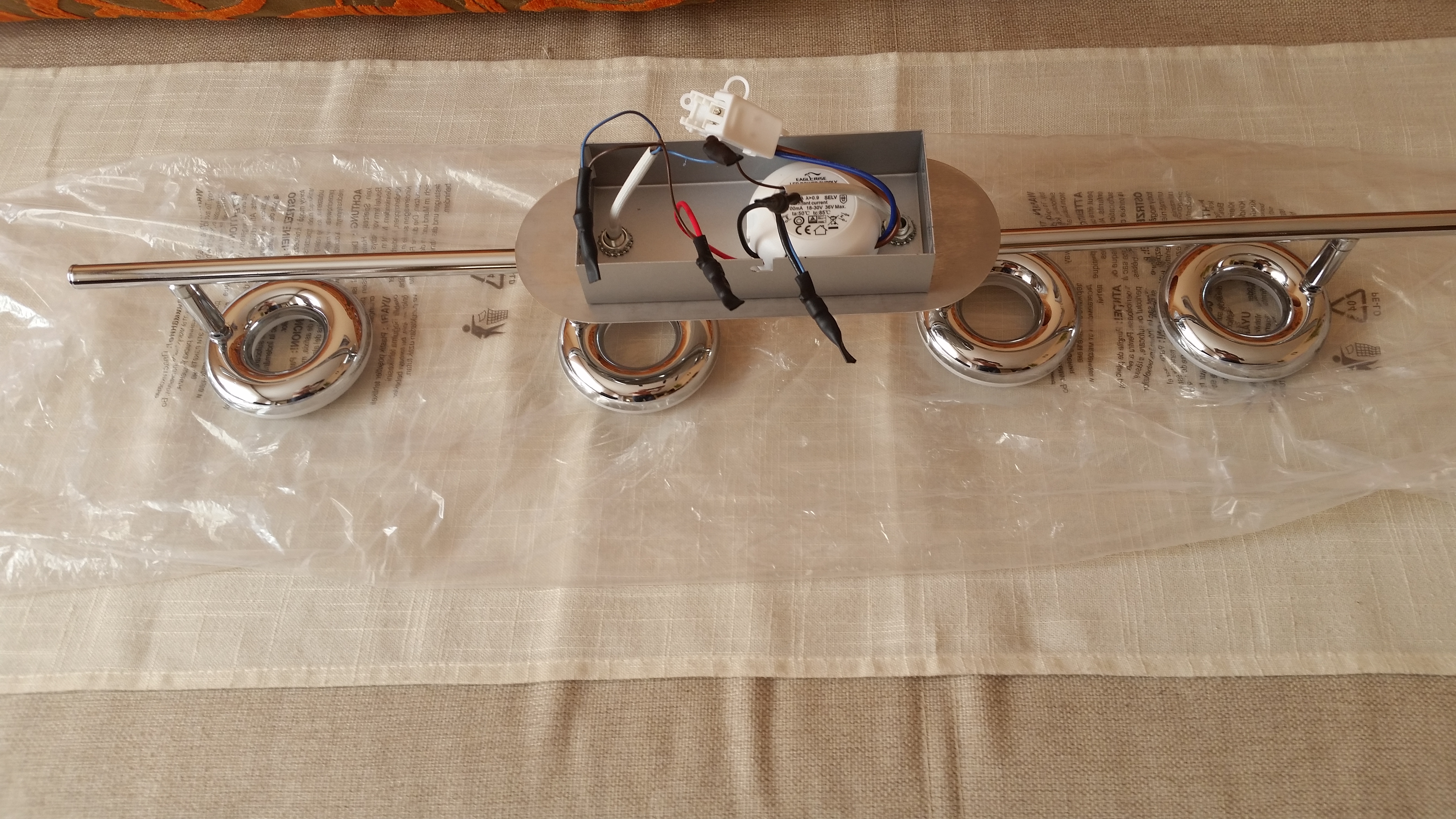

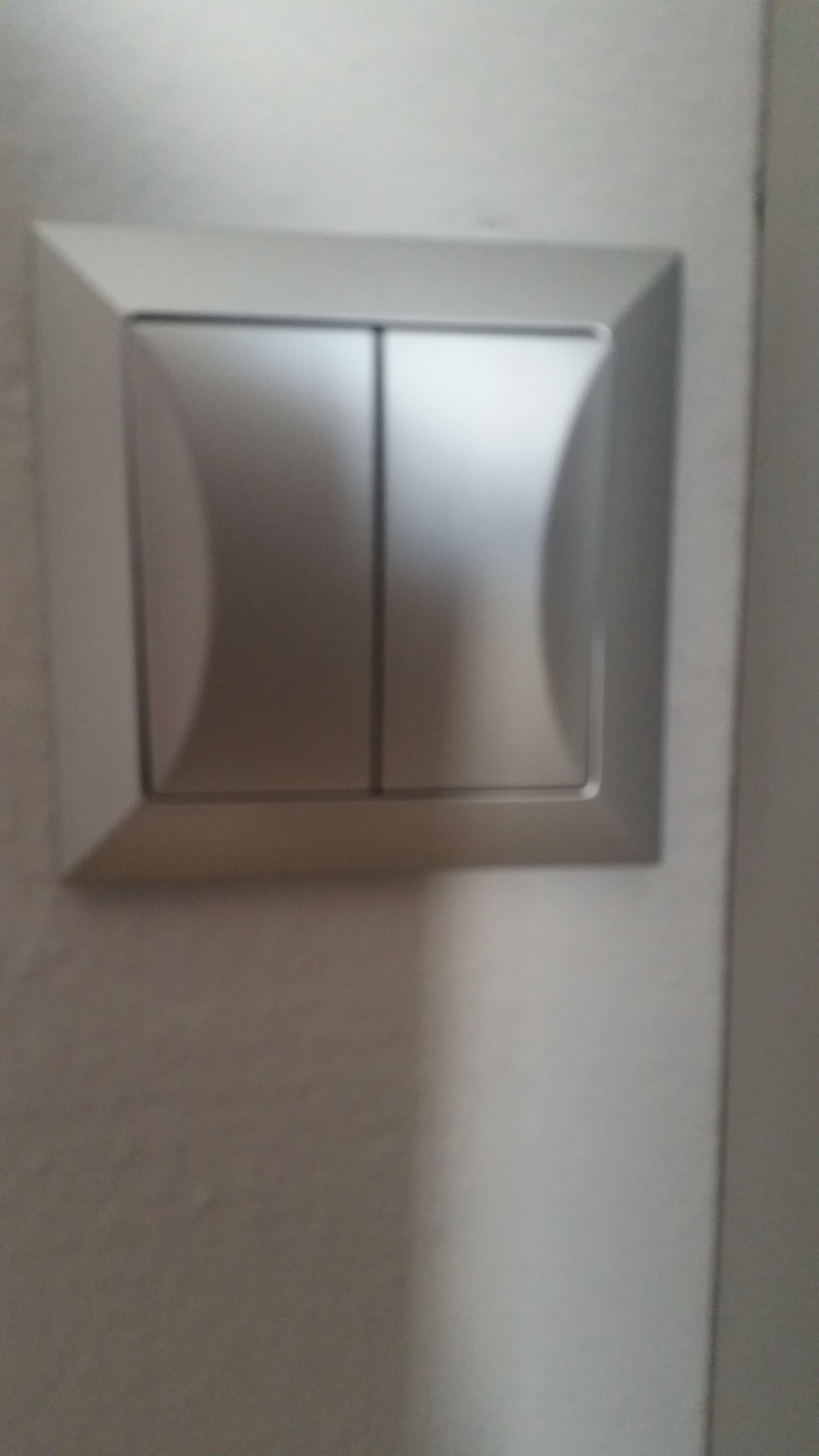

    Hello, If someone would help me and indicate how to connect this ceiling, 3 cables come out of the ceiling, switch 2, it is best for me to light on one switch 2 middle and on the other switch 2 side, or how it goes in turn 2 and 2, nowhere I can not find and somehow marked or numbered as to what it would be cool, if anyone can help, please, I am still mixed up with these blue and brown cables.

    Do you have a single or double switch? Give me a picture.

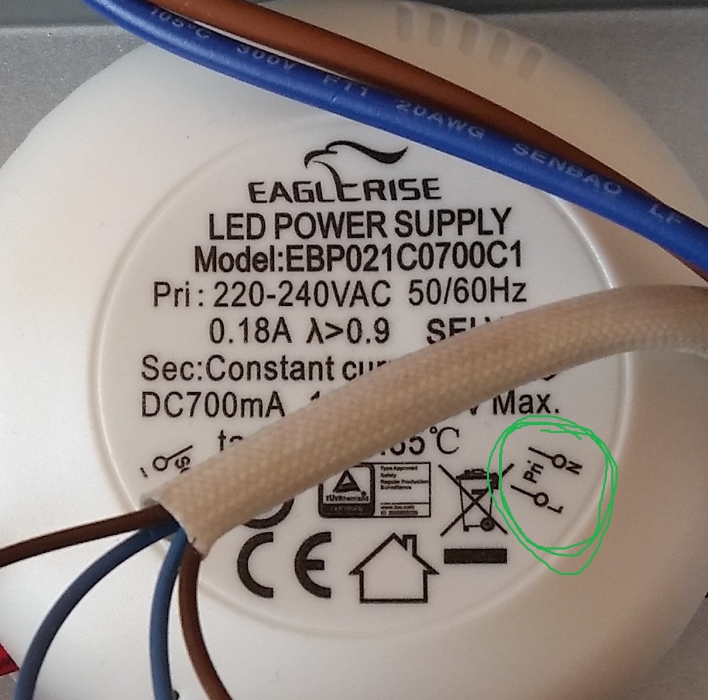

    This lamp probably the entire network at the same time because the white cube has two power cords.

    Connecting 4-Section LED Ceiling Lamp with 3 Cables & 2 Switches: Wiring Blue & Brown Wires
    Phase and zero so you control a single key switch.
    Inside, all 4 lamps are connected in series - they light up simultaneously.

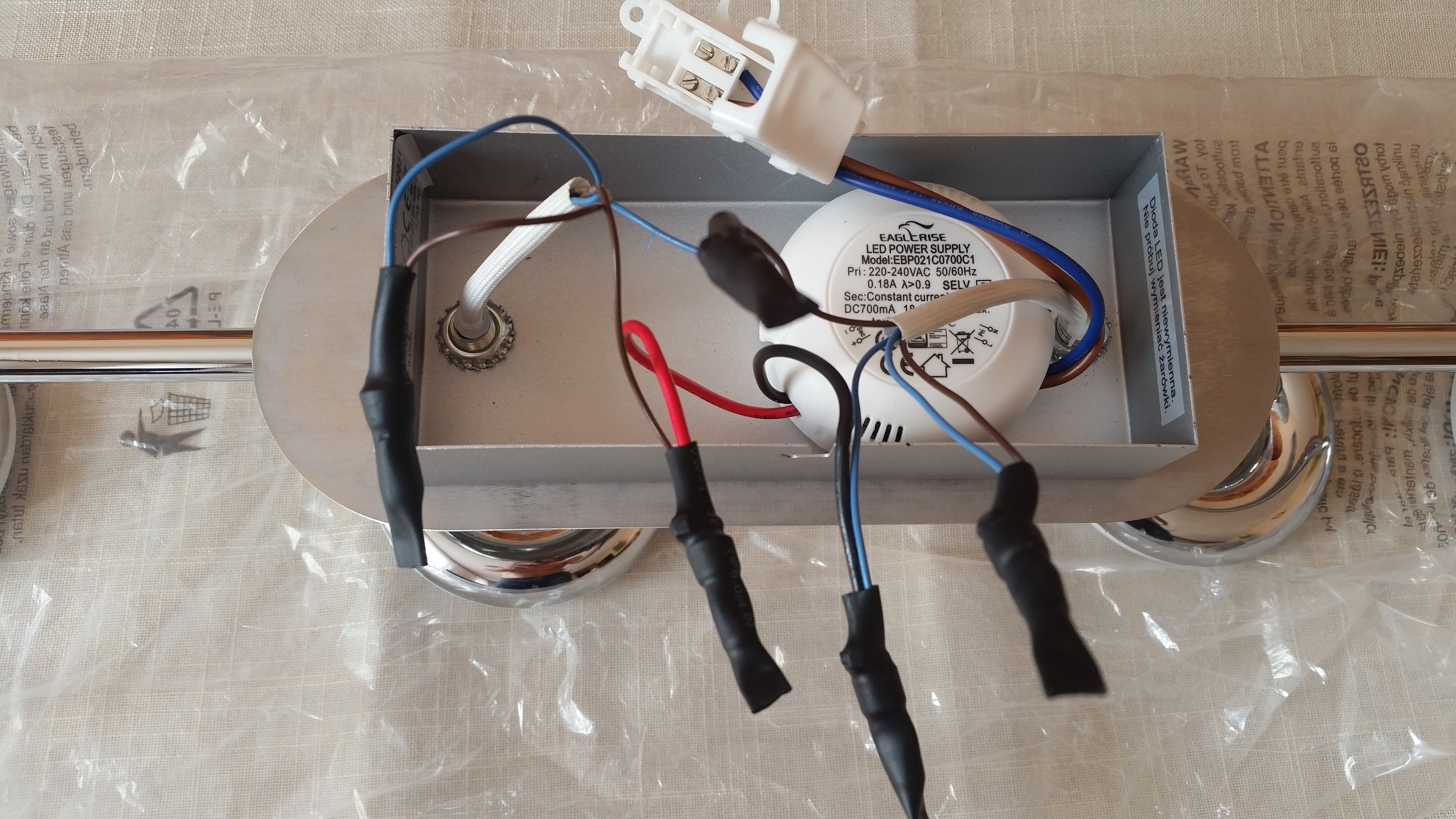

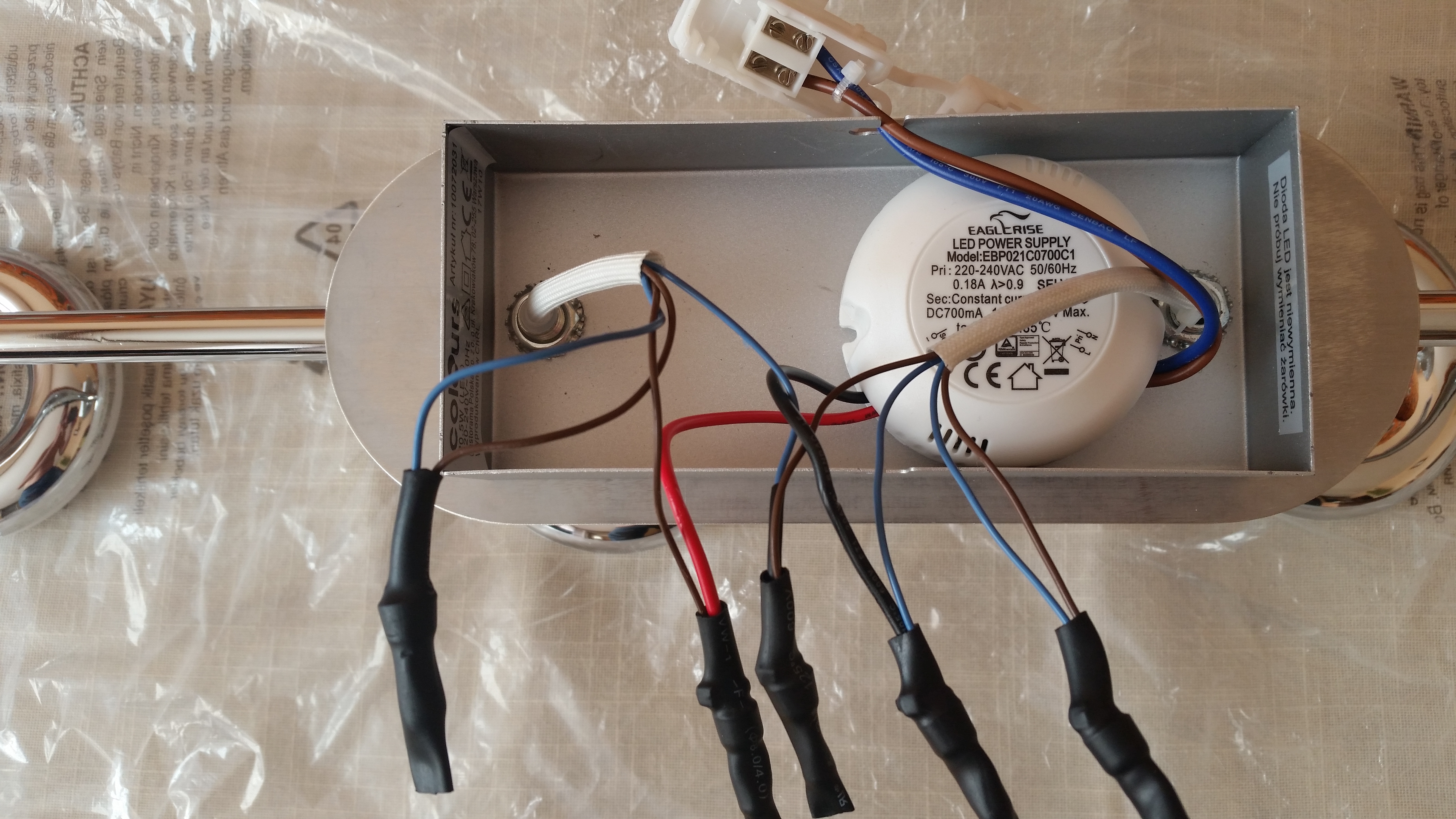

    I want 2 keys to light 2 and 2 as I described well and these are brown and blue cables and then mixed with those thin red and brown thick
    sorki with red it is black and all thin ones
    Added after 3 [minutes]:
    I think there is a possibility of such connection, but you probably need to mix something in these cables
    So it would only be connected to this cube which is blue and brown and nothing can be mixed up so that it shines after 2 LEDs. There must be a way

    Installation does not allow it, the lamp does not allow it, there is no such option.

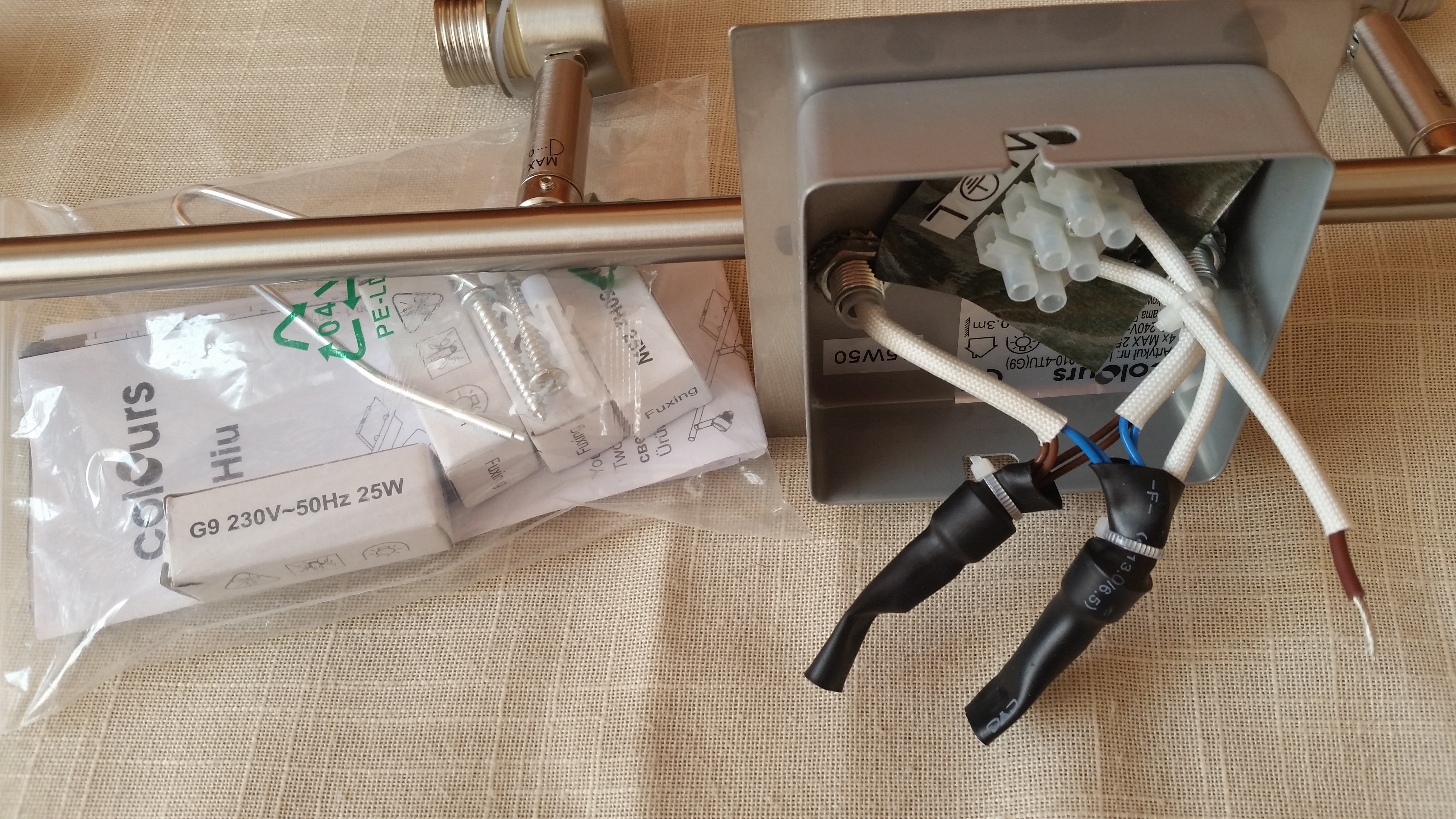

    Thank you very much for the information, but I am disappointed because I asked when buying in Castorama at the lighting stand and they said it was possible.
    I will ask again, and if this lamp can be connected so that they have 2 leds lit, here are but G9 bulbs 4 pcs.
    This brown cable probably came out of the brown ones because I haven't seen it before.

    dkristofer wrote:
    this brown cable probably came out of the brown ones because I haven't seen it before
    Not probably and certainly. The fitting is damaged in this condition. Under these black heat shrinks is a crimp terminal, which is probably badly crimped. Cover for complaint.
    By the way, with this luminaire you can't do "two" without wiring modification.

    Only you are not allowed by the electrical installation in the apartment to use a candlestick switch (double).
    The only solution to use the above-mentioned switch is to replace the cable with 4x1.5 mm.

    No measurements can be done but there may not be protective, only L, L, N since the switch is double and the colors of the wires may be misleading.

    But in the wire from the ceiling there can only be L, N, PE so there is no right to be a double switch. If it exists, it must be replaced by a single one and the installation must be connected to a new house.

    Just removing the switch will do nothing if you have no PE with the lamp in the ceiling. If this is the case then you can use another luminaire in insulation protection class 2, i.e. with double or reinforced insulation marked on the rating plate with the symbol:
    This luminaire can be used without PE and the yellow-green ceiling cable with L is marked with a black or brown T-shirt ...
    However, someone who can check the continuity of the cables should get on with it.
