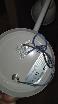

    I would like to connect the lamp, but my knowledge of electrical issues is negligible, so I am asking you for help.

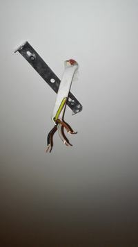

    Going to the point: the lamp has 3 bulbs (I enclose a picture of the cube), and four cables come out from the ceiling (I attach a picture) - black, brown, gray, yellow-green.
    - Connecting Lamp with 3 Bulbs to Ceiling with 4 Cables: Wiring Diagram for Dual Switch Setup
    I was looking for information about the connection and I already know that if everything is properly connected in the installation, the black and brown cables should be phase, yellow-green protective, and neutral gray (should probably be blue, but apparently there are also gray).
    The switch has two buttons and if it is possible to connect so that one bulb is on one and the other two on the other, that's how I would like to connect. I do not know if the lamp is adapted for this (I have serious doubts about it).
    After searching the internet, I am coming up with the idea that the yellow-green cable should be connected to the central "input" in the cube, because it is "connected" to the housing. So brown and black probably to the other two. But what about gray? Can you connect it together with the yellow-green? I will be grateful for your help.

    On the lamp strip you can see that each socket is led out.
    For the independent switching a longer slat or an additional one (basically one additional clamp) is needed.

    You would have to separate from the terminal strip one of the bronze wires of the lamp and connect it with the black from the ceiling.
    That's right.
    Gray connect with a blue lamp.
    Connect brown with brown lamps and insulate black.

    I plugged in as you wrote, unfortunately I did not have what to insulate the black wire at the moment, so to test the action I just bounced it as far as possible from all the metal elements, and the lamp shone. So it comes out that if I connect everything again the same and insulate a black cable, it should be ok. Thank you :)

    Currently, it works so that all the bulbs shine simultaneously. I did not want to combine with splitting the cables by the lamp, because I do not know it completely and I did not want to mess it up. According to the tester, gray is neutral.

    And that had to be checked at the very beginning. The second case, the black wire, which is offended by a colleague Mawerix can not be insulated with insulation because it is energized when switching on the light. That's not how it's left. it would be best to disconnect this wire from voltage, but if the author can not do it, add the insulated cube and connect it to the cube.
