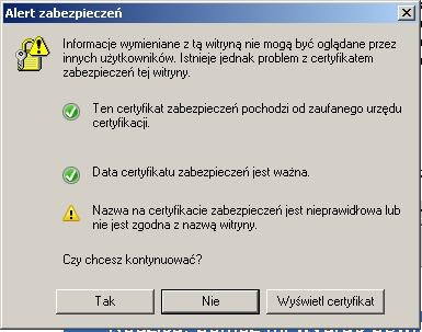

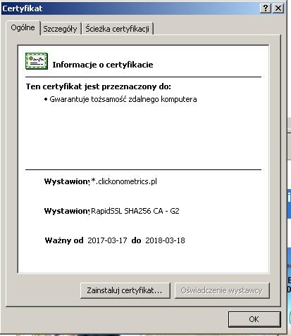

    Have you displayed the certificate?
  • #3 16686661
  • #4 16686669
    Kolobos
    IT specialist
    Posts: 85164
    Help: 17165
    Rate: 10442
    What is the certificate?
  • #5 16686781
    Robert B
    Posts: 22594
    Help: 2027
    Rate: 1412
    eurotips wrote:
    I will not install certificates because why,
    Then decide if you want to install the certificates or not and keep whining.

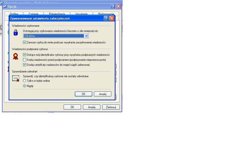

    eurotips wrote:
    Which I have not been able to get rid of this message when opening some messages
    And you tried to change the "reference checking" setting :?:
    I set it up as in the screenshot
    Eliminating Security Alert Pop-up in Outlook Express OE6 on WinXP SP3: Suggestions?ustOE.JPG (57.81 kB)You must be logged in to download this attachment.
    and i don't have any messages from OE :D

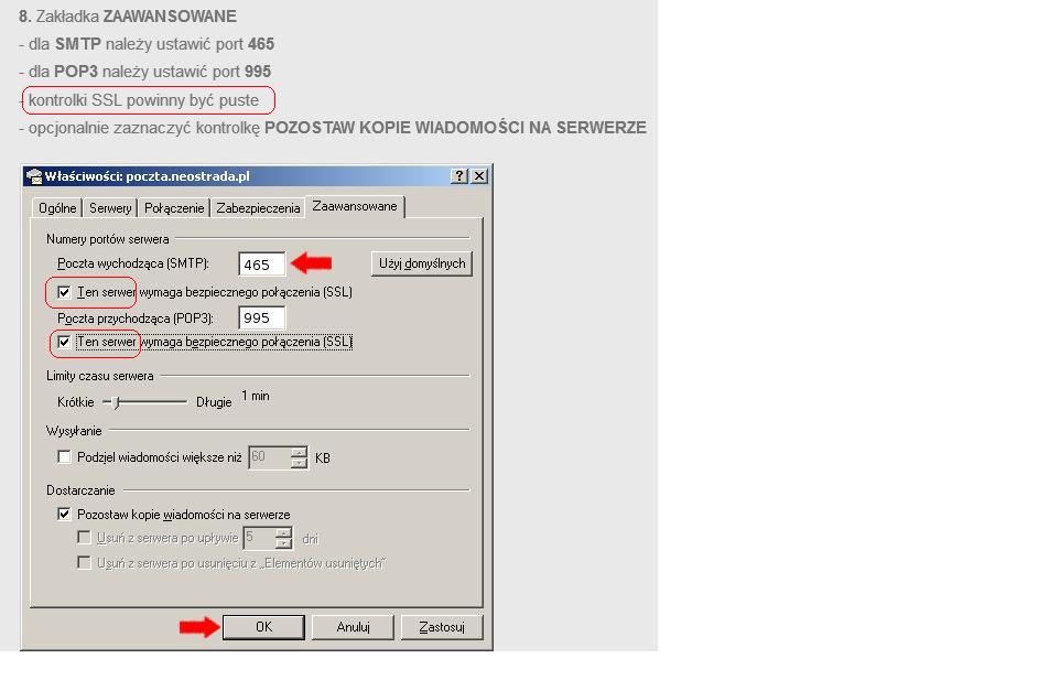

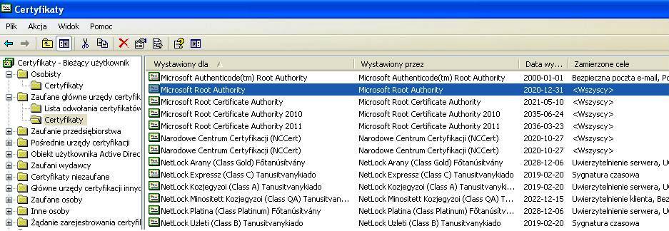

    I don't understand why you don't want to try Colobos's hint :?:
    In my opinion, it is worth checking in the console certmgr.msc what the certificates look like in your Windows XP installation.
    Especially those Microsoft certifications
    Eliminating Security Alert Pop-up in Outlook Express OE6 on WinXP SP3: Suggestions?koncer..JPG (106.06 kB)You must be logged in to download this attachment.
    If the certificate store is fine - I would look for the reason for OE behavior in its advanced settings. Site wp.pl incorrectly provides an illustration of the advanced settings for OE.
    Eliminating Security Alert Pop-up in Outlook Express OE6 on WinXP SP3: Suggestions?ustzaaw...JPG (56.48 kB)You must be logged in to download this attachment.
    I have the current certificates, settings for wp.pl as described :!: (ie without SSL) and I have no such warnings for any mail coming from this server.
  • #11 16688575
✨ The discussion revolves around eliminating a security alert pop-up in Outlook Express 6 (OE6) on Windows XP SP3. The user experiences persistent certificate warnings when opening certain emails, which disrupts bulk deletion of messages. Suggestions include checking and displaying the relevant certificates, adjusting reference checking settings, and updating root certificates. A user successfully resolved the issue by installing the necessary certificate, leading to the disappearance of the prompt.
