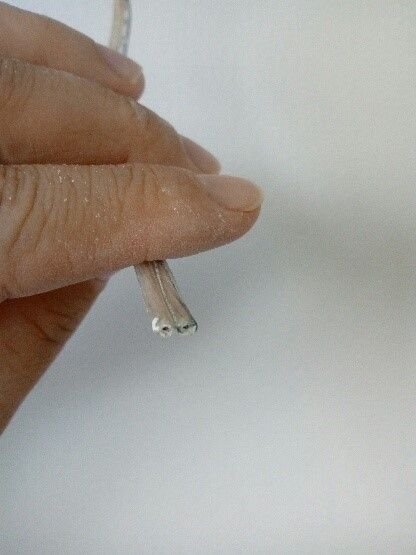

  • #12 19722909
    JAJKO2121
    Posts: 8
    SONY HT-RT3 5.1: Satellite Speaker Cable Extensions, Tips & Plugs - Names, Availability
    I meant a regular speaker cable, this is what I have in the wall, or how to connect it with a thin black cable from the speaker as in the topic, the cable in the speaker is probably thinner, does it matter? I think it is also double / wired - I do not know because I am before buying this Sony set.
    greet

    #13 19722967
    DjMapet
    Posts: 16301
    Help: 2137
    Rate: 1719
    You can easily connect these cables coming from the wall with the cables coming from the REAR loudspeakers - here it will definitely be a two-wire cable. You just need to keep the polarity, i.e. + the cable from the wall + the column cable and the same with -.
    How you combine them is a matter of your invention and skills, but according to the easiest way for me is to remove the original plugs from the column cables and connect the cable from the column to the cable from the wall using ordinary, twisted electric cubes, for example: https://www.gotronik.pl/kostka-elektryczna-12-pol-r6mm2- white-p-5812.html
    Of course, you can use a more sophisticated connection, e.g. a banana plug and socket for a cable, and if you do not like the disassembly of the original plugs from the speaker cables, for example, fit a model of male connectors to their female connectors. But as I wrote above: "it is a matter of your invention and skills". :-)
