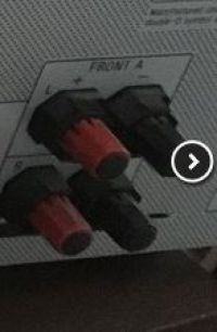

    And I see there that the column is connected to SPEAKER B. Connect under A or change the configuration to play on output B.
    Connecting Sony Amplifier and Speakers to TV: HDMI Connection Not Working .
    There is probably no front A. I can't see. With the rest it was always connected like this. The receiver had previously walked with speakers in the premises and was connected via HDMI to DVD.

    What is this? Connecting Sony Amplifier and Speakers to TV: HDMI Connection Not Working
  • #10 16514221
    kseroboy
    Posts: 26
    I never connected to it. No less - it doesn't work.

    1 - the photo of the amplifier display clearly shows that both speaker outputs are turned off.
    Depending on where a colleague connected these columns, the speaker output should be turned on - the "Speakers" button on the amplifier panel.
    2 - select the "TV" input and then check if the input is in "Auto" mode - the "Input mode" button on the amplifier panel.
    That's it for now - please check it out and write what effect these suggestions have brought.
