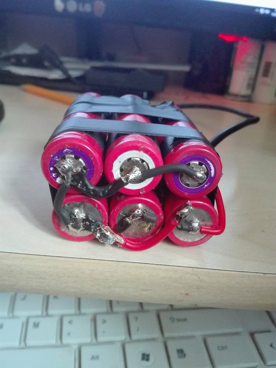

    I have a bike lamp powered by 18650 cells. 4 cell package.
    Can I use a 10V 3.5A or 12V 1A power supply to charge the cells? and if none of them is what should I buy?

    Write how the links are connected.

    Just like here, only 4 batteries.
    The picture no longer has these middle links.
    In this photo, the links are connected in parallel.
    You need a charging module with 4.2V output voltage and 2-3A current efficiency.

    Hmm, I just asked a friend who soldered it to me with a soldering iron because I would not solder anything into it, he writes that after subtracting these two middle links I have a type connection: 2 cells in series 2 in parallel ... Yes?

    Yes, a mistake on my part. You have a mixed connection. You need a circuit that outputs 8.4V. 2A current efficiency is enough.

    And if I charge them with a 10V 3.5A power supply? Because I have the closest one for now. I have to look for another ...

    This power supply is not suitable. You will damage the links.
