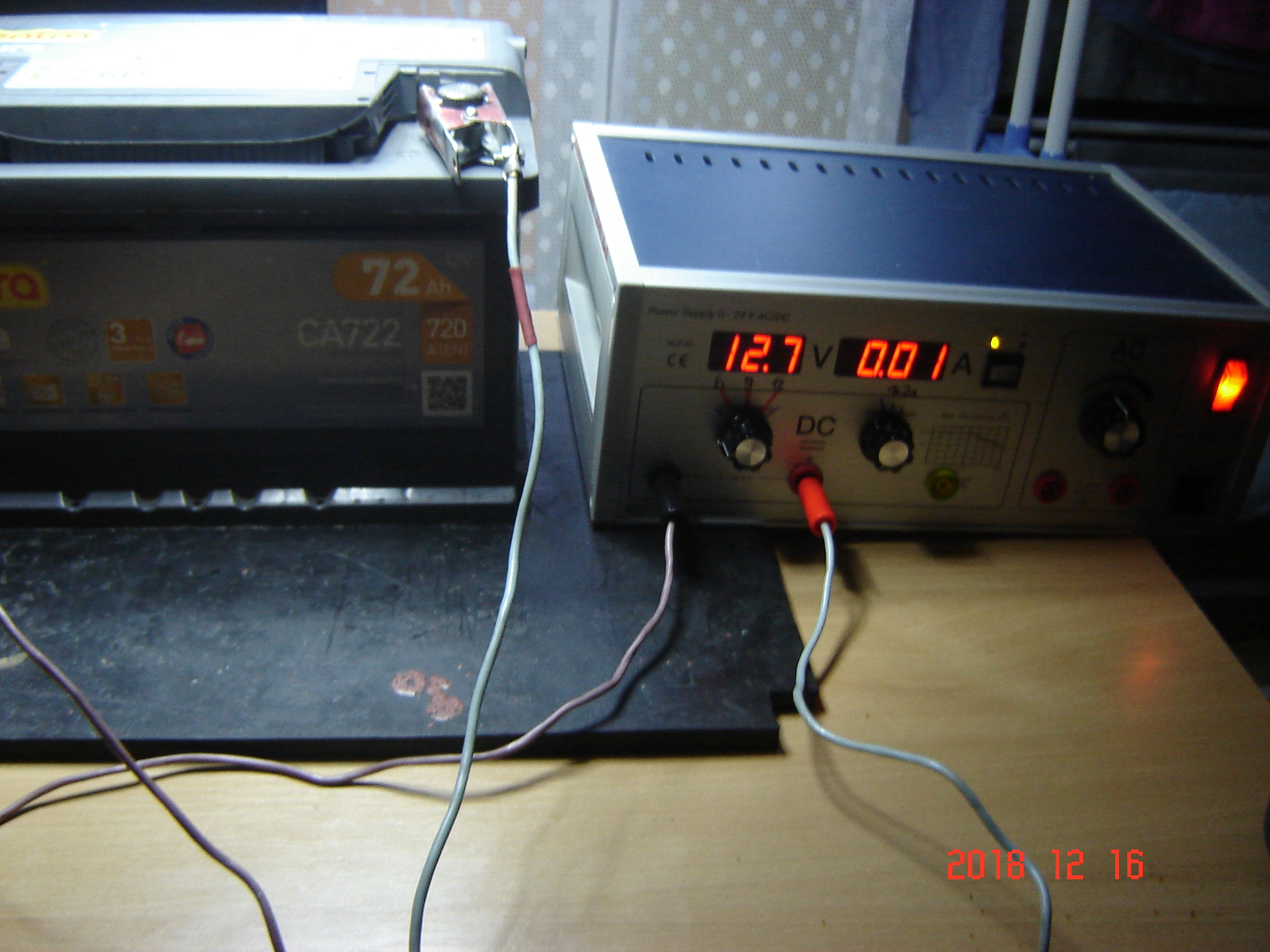

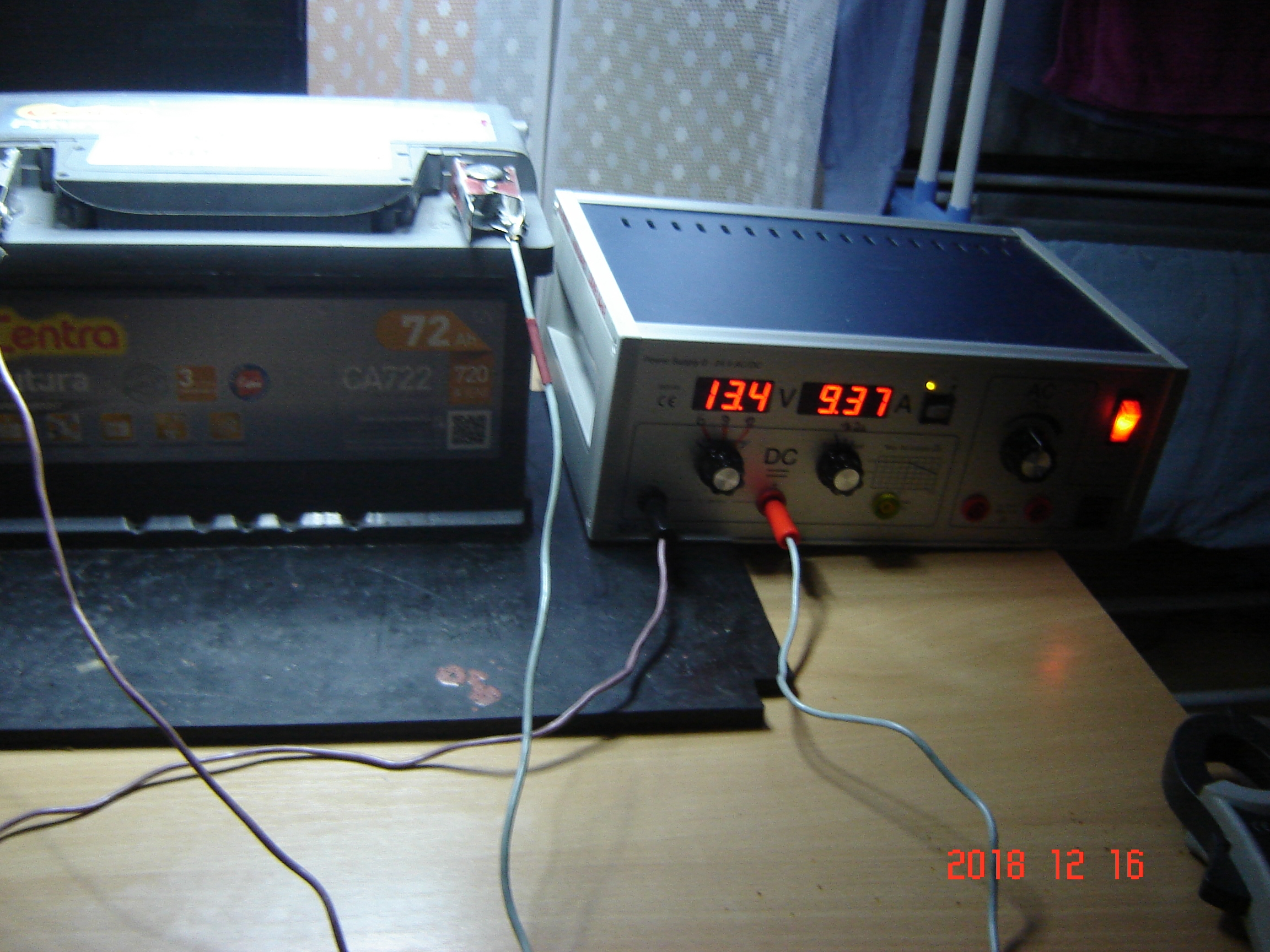

  • #11 16716554
    Sniezynka
    Posts: 1508
    Help: 199
    Rate: 841
    I charge this way for a 70Ah battery, I set the short-circuit current of the power supply to 7A and the no-load voltage to 14.6V.

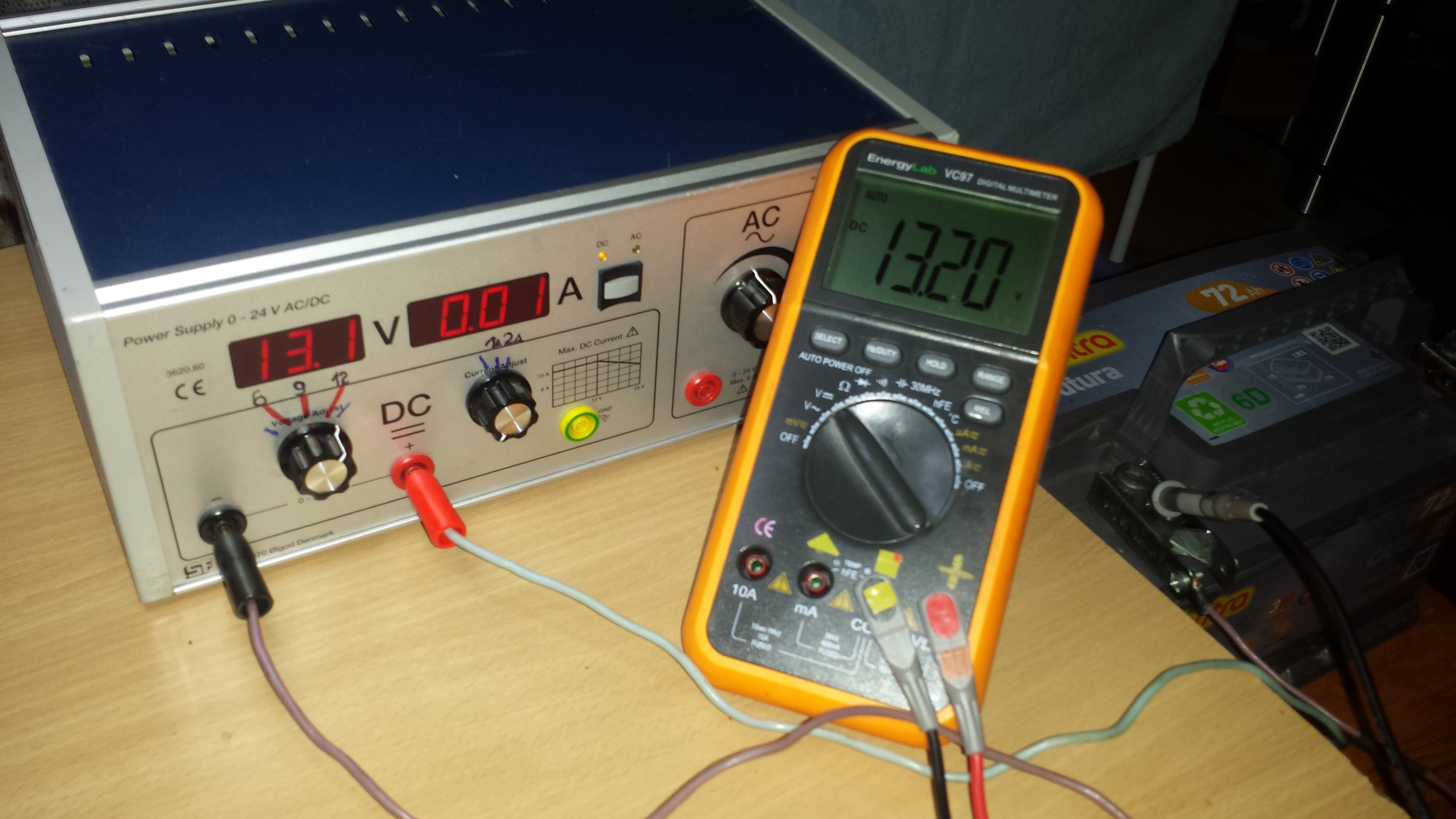

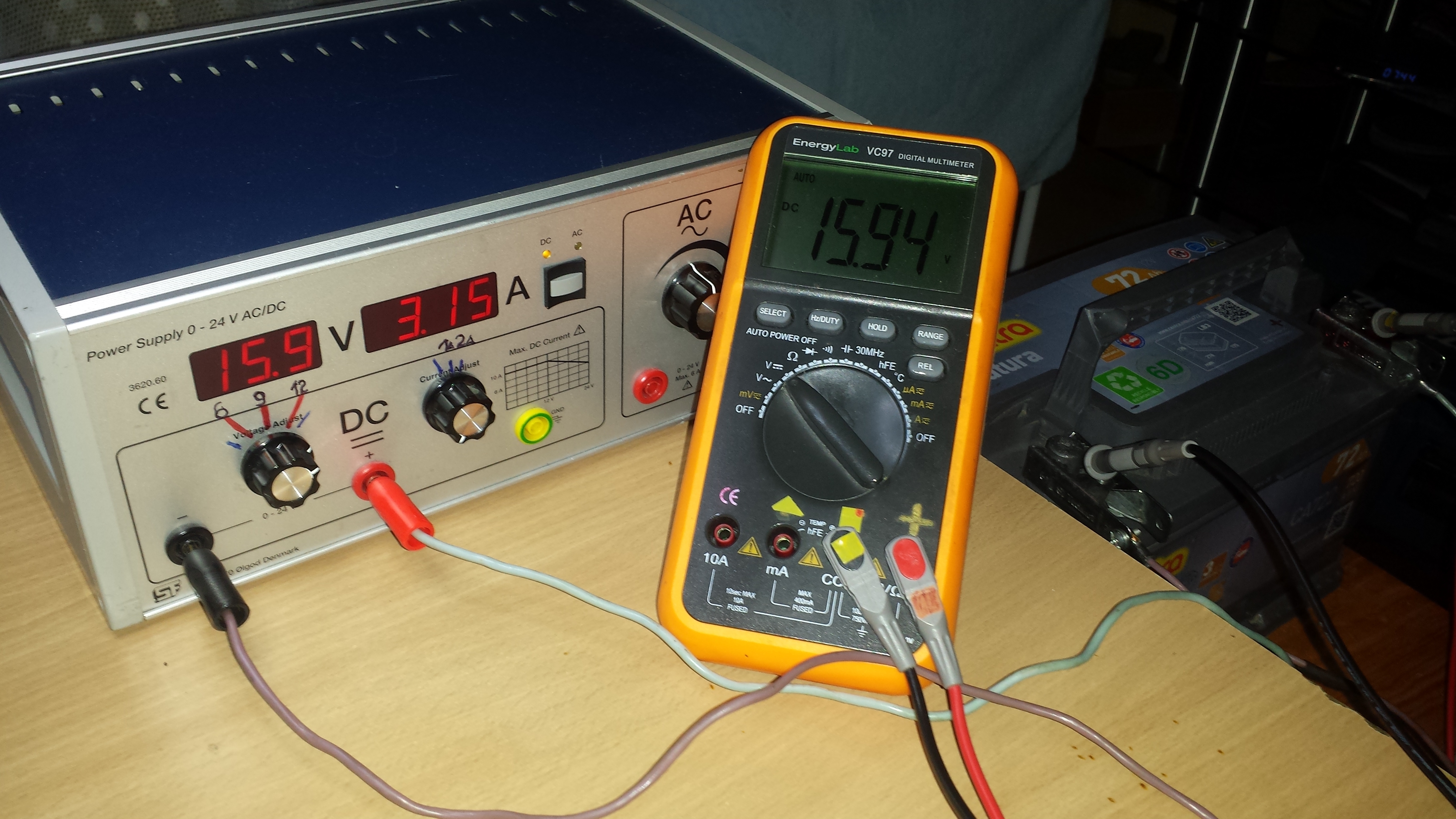

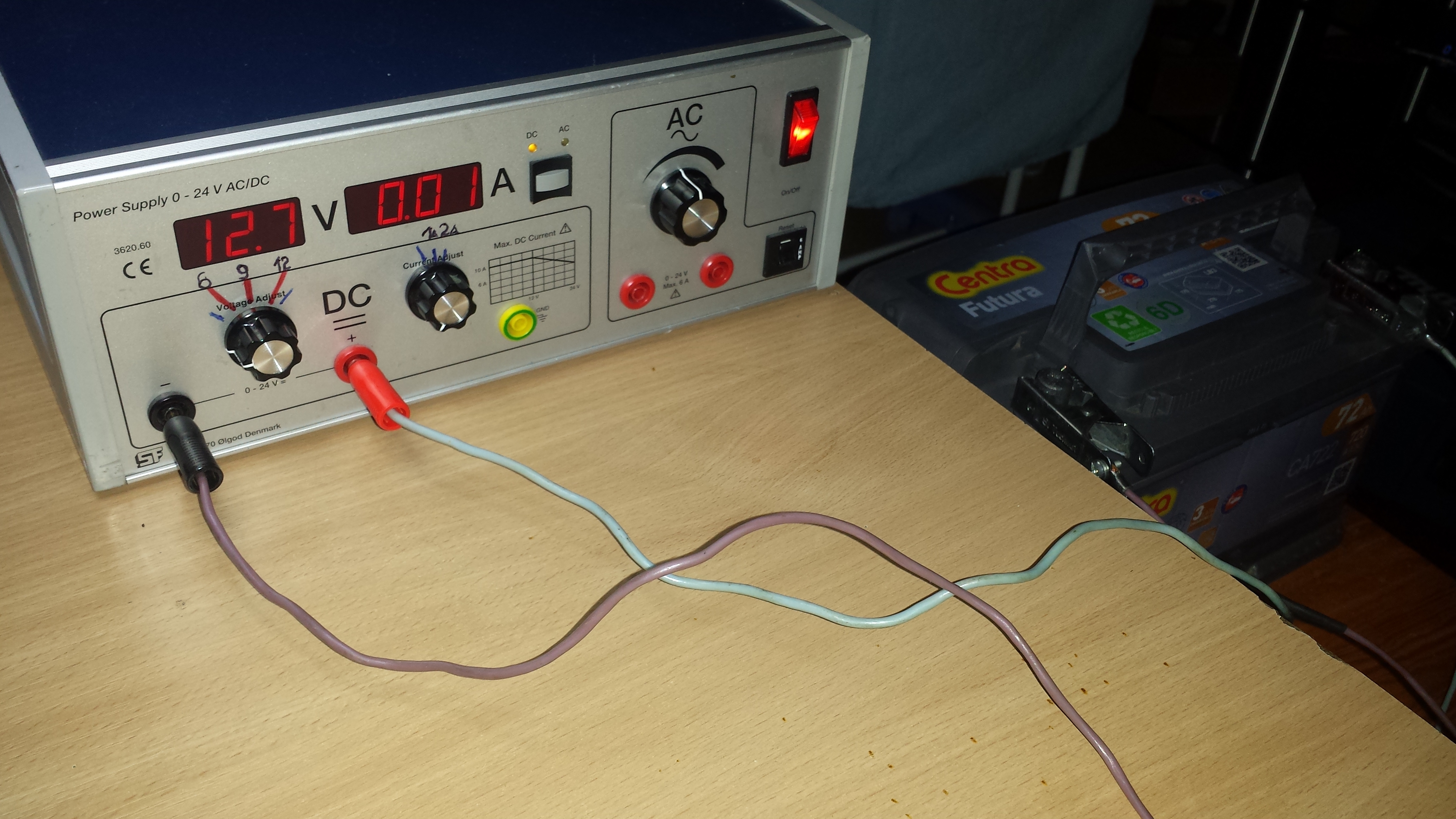

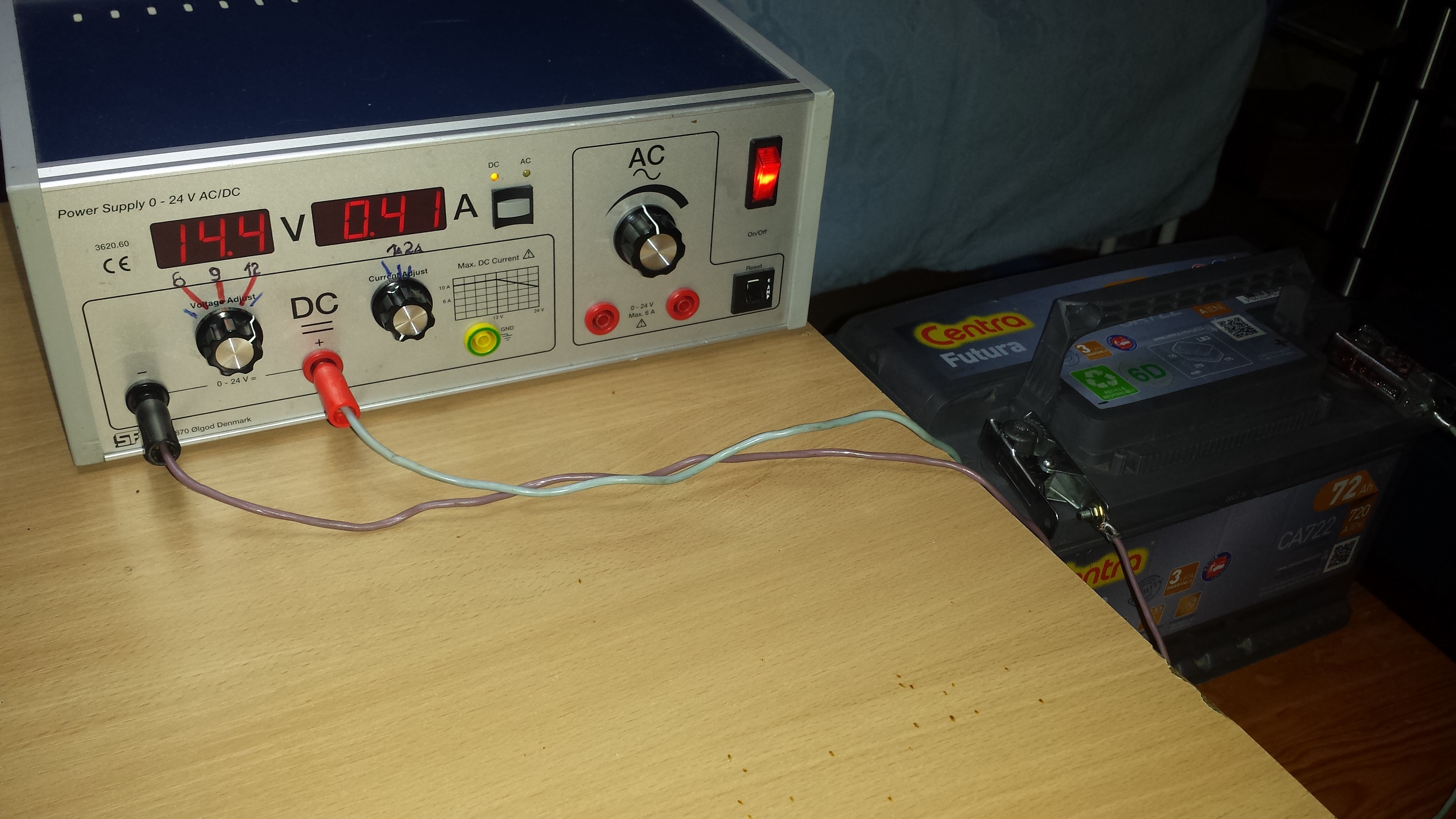

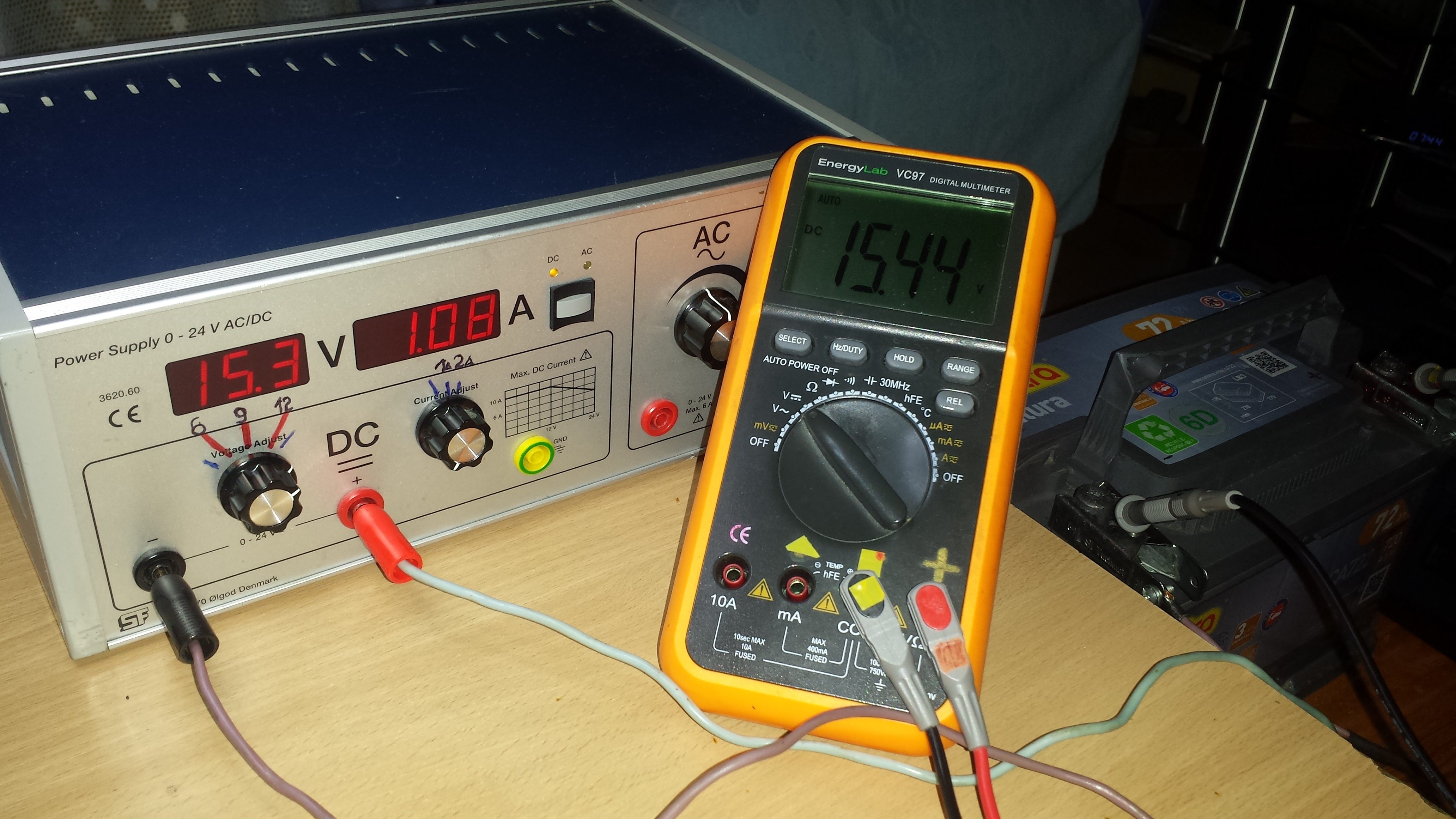

  • #13 17632631
  • #14 17632707
    gimak
    Posts: 6229
    Help: 614
    Rate: 1678
    marianek70 wrote:
    These are my observations and I do not want to prove anything to anyone or perhaps impose my ignorance.
    And these are correct observations, just check it out for full knowledge
    marianek70 wrote:
    As I gave 15.9 for a moment, he started taking 3.15 A.
    what voltage, with the same settings, will be given by this power supply loaded with only a capacitor, because this is the actual value of the voltage to which it would aim if it were not for the electrolysis of water.
    marianek70 wrote:
    After about 3 hours, the ammeter on the power supply stopped at 0.40 A. The battery started to hum slightly
    This humming is probably due to the electrolysis of the water. I have not encountered this humming noise in my batteries.
    If it is a switched-mode power supply, it will not increase, but if it is transformer, it will increase.
    And by the way, this starting current of 3.15 A, with a switching power supply, would drop quickly and in the end it would be a maximum value of 300-400 mA.
