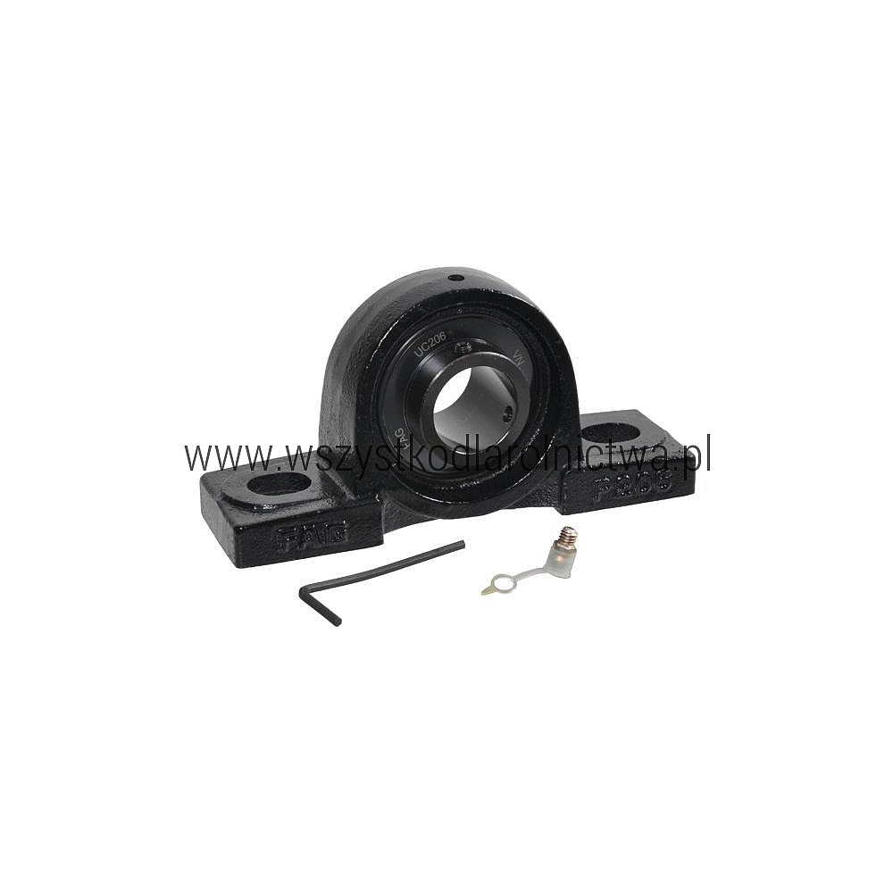

    1. As a drive I intend to use a DeWalt 12V two speed screwdriver - or two screwdrivers.
    https://www.google.pl/search?q=dw907&client=o...ved=0ahUKEwj43IXHycLWAhVDmbQKHQGTBKQQ_AUICygC
    The screwdriver has two gears and 0-350 rpm or 0 - 1200 rpm, respectively
    I'm going to use a stronger gear - lower speed.
    I intend to drive the rear using 26cm wheels
    http://allegro.pl/show_item.php?item=6680219694
    I hope that the moderator will not remove the link but unfortunately I have not found a photo of these wheels anywhere else on the Allegro
    Max load up to 40 kg per wheel quite light, of course you have to knock out the bearing and mount a rigid threaded rod fi 20mm with the sleeve and on the outside squeeze with washers and tighten well
    Outside, I will use a cap nut closed on the other side, i.e. a bearing with a housing will be attached from the car side
    https://www.wszystkodlarolnictwa.pl/moduly/sk...les/big/15705/-/Lozysko-z-obudowa-UCP213-.jpg
    Of course, the bearing for a threaded rod fi 20 also bolted to the rod from two sides and screws housing to the chassis - welded from angles, but more on that later.
    The second rear wheel is mounted in the same way on this rod - the shaft rigidly and through the bearing to the chassis between the wheels will be a gear wheel also bolted to this threaded rod (rear shaft)
    http://allegro.pl/listing/user/listing.php?st...ch=ss-base-relevance-floki-5-nga-hcp-uni-1-4- 0905
    Gear wheel with 20mm inner diameter and another one with a 10mm inner diameter on the bolt and also bolted
    http://mixstor.pl/1340-home_default/101smgn6x40.jpg
    The screw will have its head cut off and screwed tightly to the screwdriver - if necessary some of these elements will be lightly welded to avoid unscrewing.
    So we already have the back and I see it more or less so I ask for opinions if it can be like this or possibly how to do it better and from what.

    I would use a scooter engine for propulsion.
    By buying 2 scooters you have engines, a chain, gears.
    Simple and cheap.
    In the case of screwdriver engines, mechanical work is a bit
    - engine mount
    -mounting the rack on the motor axis and it would be appropriate to support the axle from the other side.
    See the steering system in the original.

    Two screwdrivers will exceed the value of the finished car, as I would have used wiper motors. After that, seeing the materials you want to use, it looks like it would be an armored car. For example, screw No. 20, it probably doesn't even have a passenger car.
    Is it not better to buy ready e.g. damaged or not complete and then tune it?, There would be some base.

    Engines are left from screwdrivers for 30 PLN on scrap metal, you can buy a box of screwdrivers for batteries - of course efficient without battery so the drive will be like for free.
    Mounting as I wrote the mode on the main shaft + the other on a small shaft 10mm screwed from two sides into two screwdrivers, unless I use one on the other supported on the bearing. The screwdriver will be called an amortized surface, so the forces will act more on the main shaft than on the screwdriver shaft - I will probably make some housing for these two modes in such a way that I pour oil on the bottom to lubricate the modes. In the case of two screwdrivers, of course, the motors will be connected in opposite way, i.e. for one right it is for the other left and without electronics in the screwdrivers directly under my PWM system.
    As for engine mounting, they will be mounted on entire screwdrivers with gearboxes used in the screwdrivers. There will be a roller on the heads and, if needed, the heads will be slightly caught by welding to a small roller.
    As for the costs of screwdrivers I gave above where to get cheap screwdrivers cheaply, as for the whole finished Chinese car - it falls off due to trash and plastic wheels. In addition, probably two children will be crazy about it so it must be "armored" of course in the test phase daddy will be a load (about 60kg) so also must withstand I try to choose materials so that they are the lightest roller on the rear axle must be thick so that it does not bend everything especially since there will be a main load - sitting.
    Besides, as far as I know, Chinese vehicles of this type have no depreciation or are very poor - let's call it "the better"
    In summary, the costs will not be cosmic at all
    - screwdrivers - scrap
    - welded construction - angles - scrap
    - the purchase remains - shaft - bearings - bolts - springs - wheels - modes
    - I have electronics and battery.
    - Parts from the car type gas pedal steering wheel.
    A colleague Daras41 raised an important issue of the rear differential - the fact I did not think about it and you will have to think about it - on the other hand if you can't do it on the ground (ground) it should not be an obstacle - I think I lose power for swallowing and wear of larger wheels - the worst after the cobblestones would be felt well depending on the load.
    For the materials used were given as an example and probably during construction there will be one thing you will need to change maybe the cupid screws will be smaller.
    As for the steering system in the original is made on the principle of a lever turning the wheel turning strip - this solution is unsatisfactory for me - the mode and strip seems better.
    Now I have a new topic for thinking - differential system - how and what to do easily - of course with rear-wheel drive - two wheels remain front - four in total because the car must have 4 wheels ;)

    Engine life will be short.
    The load on the screwdriver is axial.
    Turning off the power will cause engine braking, the transmission will not withstand.
    Added after 16 [minutes]:
    If you use 2 motors, a differential mechanism will not be needed.
