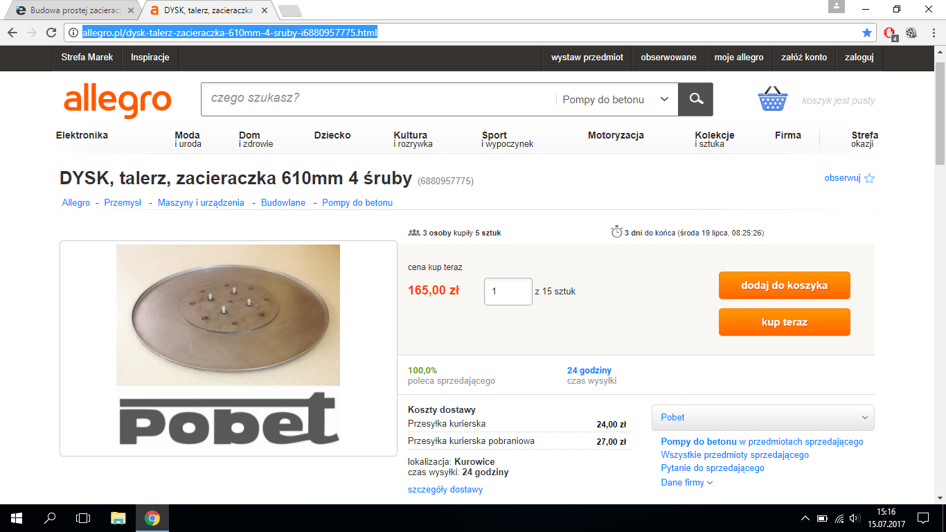

    Hey. There will be a lot of screed / floor screed in the barn and garage in the near future. I recently flooded one barn in the barn (about 1/4 of the whole area) and I do not like the surface after simply removing it and troweling it with a float. I want to make a small and simple disc trowel on a DC motor and 18V 12Ah (5s6p) li-ion battery. A special plate costs about PLN 160, DC motor from the wipers or buy a new one with a 350W magma gearbox and with the help of a rack determine the speed in the range of 60-90 rpm. Li-ion batteries have 2 pieces. What do you think about it

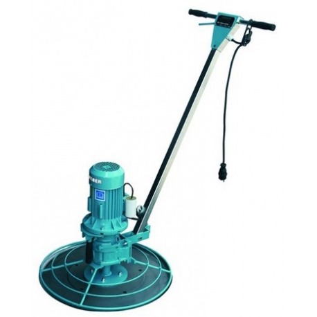

    Do you mix concrete in a concrete mixer or call a pea? Like concrete made of crumbs, I wouldn't play in building a trowel.
    The factory trowel with a 90cm dish weighs 80kg and has a 2.2 kW engine. As you want to build, no batteries are an option unless it is a dessert plate-sized device.

    Do it, you'll find out so complicated. You mash almost immediately to remove concrete milk. The cheapest plates from Allegro, laughter in the room melts nicely in concrete and makes strands. Wiper motor. Well, maybe from a Chinese toy car? I wonder why the factory has a much more powerful engine. I do not know what, what calculations did you get 350W power from.

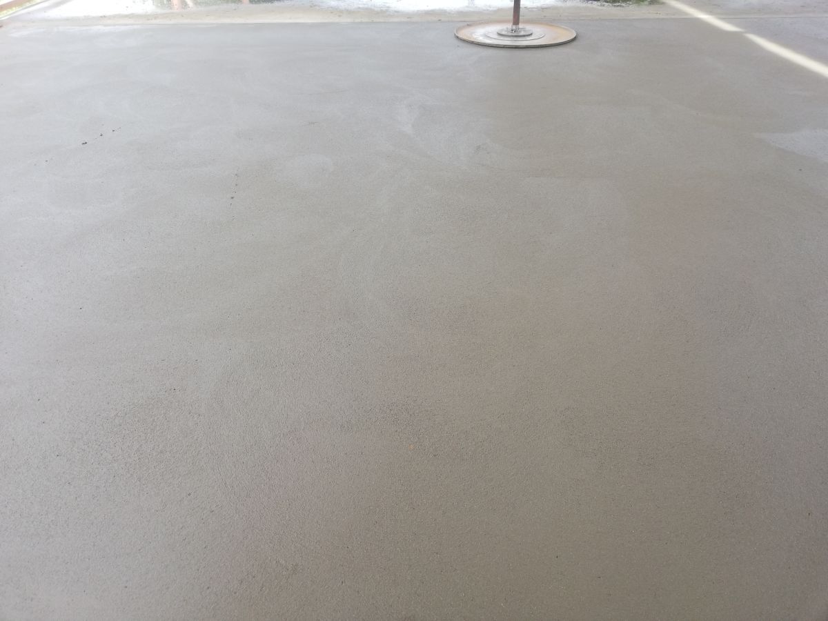

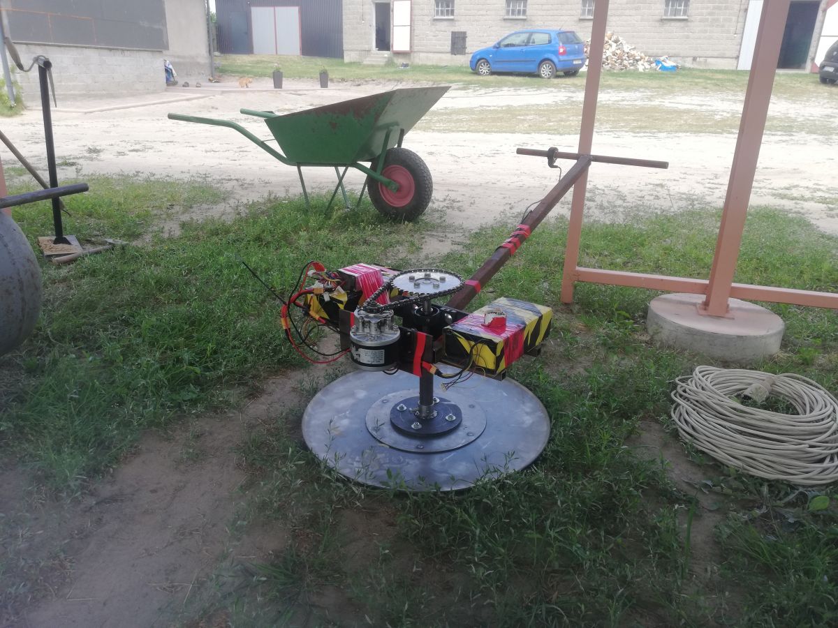

    Some time passed and I forgot to boast. The trowel made according to my thoughts and did a great job with floors totaling about 150 m? so far. I did it quickly last summer in 2 hours so don't look too much at the aesthetics.

    I did not weigh, but with batteries around 25 kg for sure. The trowel is still in operation today. It has already obliterated approx. 350 m2 of floors and is still working flawlessly. I'm just wondering if I should add additional blades to it to blur it on a "mirror".

    I put it together in 2 hours because I had to buy/find all the components first. Despite being a makeshift device, the device still works today. I only changed the gear ratio to a slightly slower one (larger sprocket) because the engine warmed up a bit after prolonged operation.
