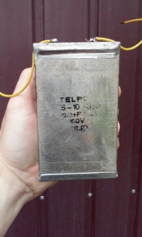

    Hello, how to check if the capacitor is working with an electric meter

    Do you have a capacity meter?

    The capacitance meter alone will do him no good, he will not measure ESR. Popular Chinese "measures of everything" at prices from 30 zlotys here will be checked, the first from the shore:
    Digital ESR Meter Mega328 Transistor Tester Diode Triode Capacitance MOS / PNP / NPN / LCR METER TESTER
    http://s.aliexpress.com/BjIfqIzM
    Added after 5 [minutes]:
    I'm sorry, I assumed in advance that it is about electrolytic capacitors. If not, just a simple multimeter with capacitance measurement, as suggested by the previous speaker.
    Nika76 wrote:
    how
    You set on the measurement of capacitance and probes you apply to the capacitor leads ;)

    Such a small reminder:
    Before the measurement, discharge the capacitor because it may be uninteresting. How to Check Capacitor Functionality with Electric Meter: Testing Techniques & Tips

    1. You will only check the capacitance with a capacity meter, you will not measure ESR.
    2. Using the method suggested by Marian B you will check the capacity "by eye" and whether the capacitor is compact, you will not measure the ESR.
    3. To measure the ESR, you need an ESR meter, just Chinese. Of course, you can also use an oscilloscope and mathematics, but I assume that the author does not mean it.
