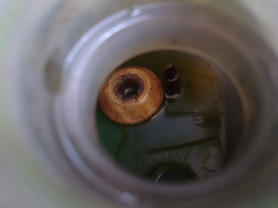

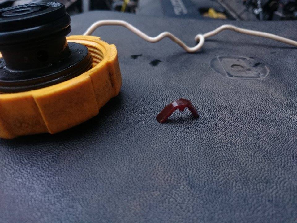

    At 6 o'clock in the morning somehow I got to the car in the city, in the tank empty as in the Sahara desert, I added the liquid as needed and moved, for some 3km I stopped at the station to check the level, I lost a lot .... I poured, I went on, behind about 3-4km I stopped again and again I topped up, I was already afraid that I would not get home, I was topping up the last time and somehow I got there. Turning the heating on to the max, it was cold.
    At 12 o'clock I go to the car and I see that the fluid is in a state like 6 o'clock so nothing has dropped, during the car's operation the level grew up almost to the cork itself, I slightly opened it, it hissed and the liquid poured out the nozzle which is on top reservoir and sometimes the level was also falling. Under the car a puddle of liquid has formed and now I do not know if it was because it flew a connector or somewhere else. I went to a mechanic's friend, he checked a special tube for coloring, it's not a head, it did not tint from blue to green so the head was ok, the bayonet was ok, the car was not kicking. The car was still going and it was well-heated, as the anger of the fluid did not diminish as it was in the morning when I came back from work. Surprisingly, I made 4 km to warm up the car even though it was already 90 degrees and attention .... it warms up, flies hot until it's nice, maybe the system has somehow vented? Tomorrow I'm going to him and we have to check the tanks under pressure and then we'll see if there is fluid going somewhere, I also check the pressure on the cylinders. I have such a suspicion about the cork from the reservoir, he has such a spring that under pressure is supposed to shirk and the pressure pipe escapes, I think well? Maybe yesterday the stopper got jammed and the pressure got under way and under its influence the liquid was flying out on the hose under the tank because it was wet under it. In spite of everything, the control from the coolant is still on the dashboard. Ports on the bulkhead, tees from lpg dry. I marked the level with a marker on the tank to be able to compare for a while. Now I dread to ride because I do not know the reason why yesterday the liquid disappeared and I have to know: /
    1. Does my thought about the cork make sense? is it worth replacing?
    2. Under what pressure is it best to check the system tomorrow to not damage anything? What pressure prevails during normal pump operation, how many bars?
    Added after 4 [hours] 42 [minutes]:
    On the photos, as you can see, something floats in the tank, what role does it play? in addition, I was swimming a small element that probably broke down but I do not know what, maybe from the sensor that can be seen in the tank and maybe that's why now all the time I light up the control from the liquid on the dashboard ??
    Tomorrow I check the system under pressure and see if the liquid will go out in some place and put a new stopper.

    Today I came back after a car ride under the house, and looked under the hood, the nozzle on the reservoir could hear how the air escapes, I moved the tank slightly upside down and the intensity of this hiss slightly changed or the cork drops too much pressure and probably it is ok, with the old I have not heard anything like this, but in both of them the force I used to push something thin on the spring seemed to be the same.
    For the peace of mind I would like to change the fluid and flush the system, does anyone know if a good specialist will connect the coolers or the entire system under the appropriate pressure and check whether there is no air, for example, from a cooler? The tank also needs to be replaced also would combine it with a fluid exchange.
