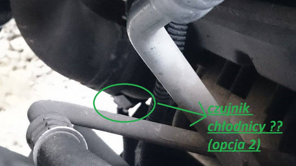

    Some time ago I was ejected coolant from the tank, yesterday I changed the tank, earlier the plug and flooded the new liquid, it turned out that the radiator fan does not turn on at a given temperature (probably 97-98 degrees Celsius), it was checked for a short time and works, turns . Attached are several photos with the description. I found out that I have two temperature sensors, one in the radiator, the other one behind the thermostat. In the hidden menu as I was driving today the temperature went up nicely like on the clock behind the wheel but the menu was already 95 and more and even 101 (as I stood 100-101, when I was driving 96-97, the fan did not turn on) and on the clock no more than 90-91, apparently this sensor in the radiator could have fallen, do you think? And the second sensor behind the thermostat is responsible for what? For opening him? On the photos I marked where the sensors are, but I'm not sure about the radiator, please correct and help. Greetings.
    Ps. unfortunately the familiar mechanic is closed until Monday, so I drive only short routes, for a long time I am afraid that it will heat up and it will crash again: /, Fuses from the fan are ok, there is 1 fan.

    Hello, both temperature sensors in this engine are connected directly to the engine controller. They are two because they control the operation of the thermostat which is also controlled by ecu (it is not true that one is for the fan and the other for the ecu counter etc.). Unfortunately, the temperature on the counter does not show actual engine temperature only calculated and this engine usually has about 100 to 105 degrees in normal operation (pressure system so everything is ok - the engine is to be warmed up to eliminate emissions) and why the meter shows a lower temperature - that's how it should be. This is best seen in Astra and Insignia where the counter shows how killed 90 degrees and in fact the temperature is swimming well.

    The sensor switching on the fan is in the radiator, besides what problem to check the sensor?

    It's best on tech or mdi to check the data list and everything will be clear ..

    My friend's computer was not found, due to lack of time tomorrow I replace the sensor in the radiator in the morning. I noticed that after switching on the air conditioner, the fan switches on periodically, so when I am in traffic jams I have to ride the climate, then the temperature drops :)
    Added after 17 [hours] 55 [minutes]:
    I replaced the sensor in the radiator today, pouring slightly (on a cold engine, unscrewed the old one, clogged the hole with a finger and screwed in a new one, the screw to screw in was of a different size than the previous sensor), refilled a little liquid, heated up the car and in the hidden menu at 101-102 degrees C fan turns on, I do not want to come in but I hope it will be okay, because when at the station they changed my fluid and checked the fan, I do not even know at what temperature, I have to ask them out of pure curiosity. I don't remember the temperature to which I previously warmed up to the maximum, I was afraid to check or maybe it was good? I don't know myself anymore, the fact is ok for now. In addition, even turning on the klime turns on the fan and this way you can also save yourself in traffic jams like something.
