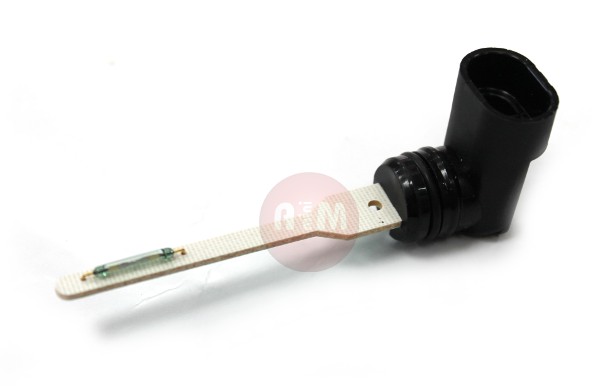

    I finally got ready to check this sensor in the expansion tank.
    Unfortunately, after dismantling it, it turned out that it is different than what is sold at auctions on the Internet.
    The sensor shown in the example photo.
    My question, how does it work? The more so because it is completely disconnected from the fluid, after removing the sensor, the tank did not lose any fluid.

    The sensor itself, as you can see in the photo, is an ordinary reed switch and there is a magnet in the float, the sensor is not directly inside the tank, but in a sleeve on which the float moves.
