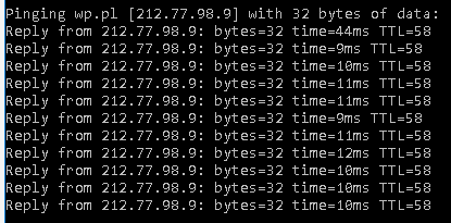

    Good evening, I am writing with a problem that I have been struggling with for about a month, namely high ping in games, but only in the evening. In the morning or late in the evening (around 23-24) ping is low, it does not cause any problems (jumping or maintaining high ping as it is in the evening). I called the network operator (radio internet) with this problem, the service provider checked the range and announced that it was at the level of 100%, also damage to the antenna can be ruled out. I tried to connect the Internet directly to the computer via cable and router, but it does not change anything. Can you suggest a solution?

    If the ping is high only in the evening hours, which I understand in peak hours, it probably does not make the connection / equipment on the side of your ISP. Unfortunately, wireless links have it that they quickly clog up and ping starts to grow. There is probably only one solution to this problem - changing your ISP to the one that provides a copper or fiber optic service in your location. Unfortunately, the radio Internet for games is average.
    1 Play online in non-evening hours.
    2 Force the current operator to increase the overhead (bandwidth) on his network.
    3 Change supplier.
    There is no other way to do it.

    The thing about wireless links is that they quickly clog up and ping starts to grow
    This is not entirely the case, it all depends on the operator and the infrastructure. If the operator has a base to which 30 clients will connect, and this base is powered by a poor-quality radio, or poorly tuned, or worse, it is a 3 or 5 jump on the skeleton, the bridge does not work and the pings jump. Rarely, the operator decides to use decent shipments to remote bases.
    It all depends on the provider and the willingness to provide a good quality service.
    Copper cable or optical fiber is still not a panacea for all ills. It should be remembered that between the ISP and the game server there is often a whole number of internet sites :) and intermediate networks, and no one can guarantee the condition of the network further downstream.
    I wonder what everyone insisted on complaining about this unfortunate radio, I currently have over 200 clients on the radio and a lot of players, especially "CS" and no one complains about high pings or poor quality internet, I think I managed to cure radiophobia with them . :)

    Well, that's the problem. There are two radio suppliers in my area. One of them (the bigger one I once bought internet). As it turned out, during peak hours it was not possible to load pictures on websites (max 24Mbps connection). As I went with the complaints it is standard text. "Everything is fine with us." "probably the processor is not working for you, or the disk just read a lot", "possibly the switch loses packets". The Komp was connected directly to their mikrotika with a 6th category cable with i7 3gen and ssd samsung pro 840. But the hour of war with the owner only led to the fact that the gentlemen took off what they had put on with a huge grace and a waste of money for the assembly service.
    So, in my opinion, my colleagues are right, the option to change ISP is probably the only one. I doubt there would be any chances of persuading the operator to change the equipment :)
