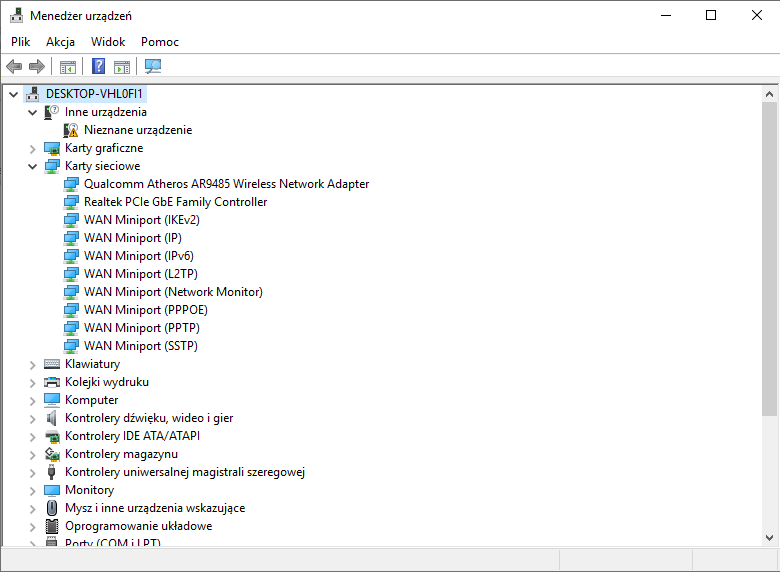

    My ping in games is in the range of 80-110 with no "packet lost" though sometimes it does but rarely. On the speed test, the results are correct, i.e. within 30-40 ms (checked several times).
    Nothing unusual. Speedtest searches for the nearest server, so usually there will be low pings on the speedtest. And the servers you use are in what country, on what network? Are they burdened or do they stand and get bored? What connections do they use and what is the route between your point and such a server? Because the ping to such a server will depend on all of this. And there are no irregularities in this. Manually select a server in the USA or somewhere in Japan on the speedtest and check what the ping is then.

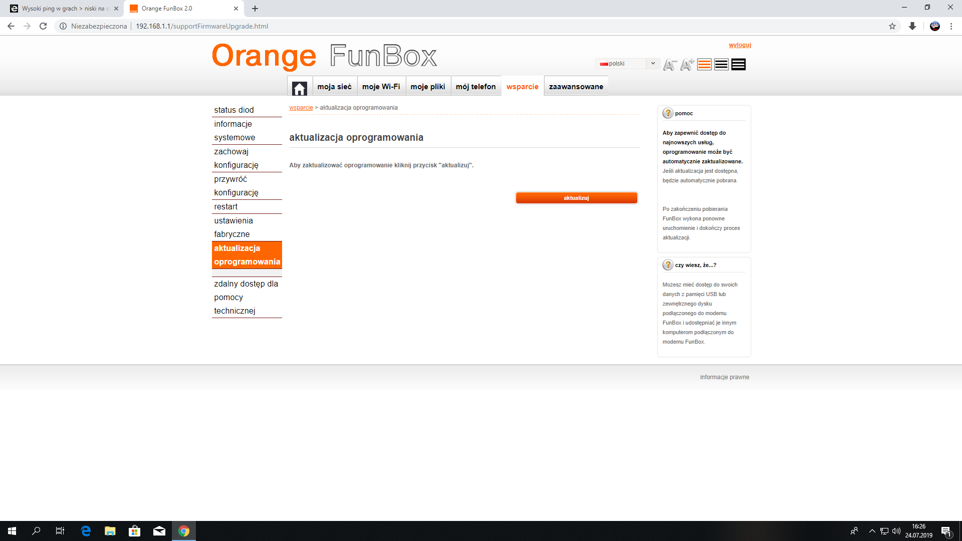

The discussion revolves around a user experiencing high ping (80-110 ms) in online games despite low ping (30-40 ms) in speed tests while using Orange Polska Neostrada. The user has taken several troubleshooting steps, including switching from IPv6 to IPv4, resetting the modem, and performing virus scans with CCleaner, Anti Malwarebytes, and AVG, but has seen no improvement. Responses suggest that high ping may not solely depend on the user's internet connection, as server quality and game settings can also affect latency. Recommendations include updating router firmware and manually testing ping on different servers. The user confirms that the issue persists across multiple games and servers, and notes that friends with lower internet speeds experience better ping.
