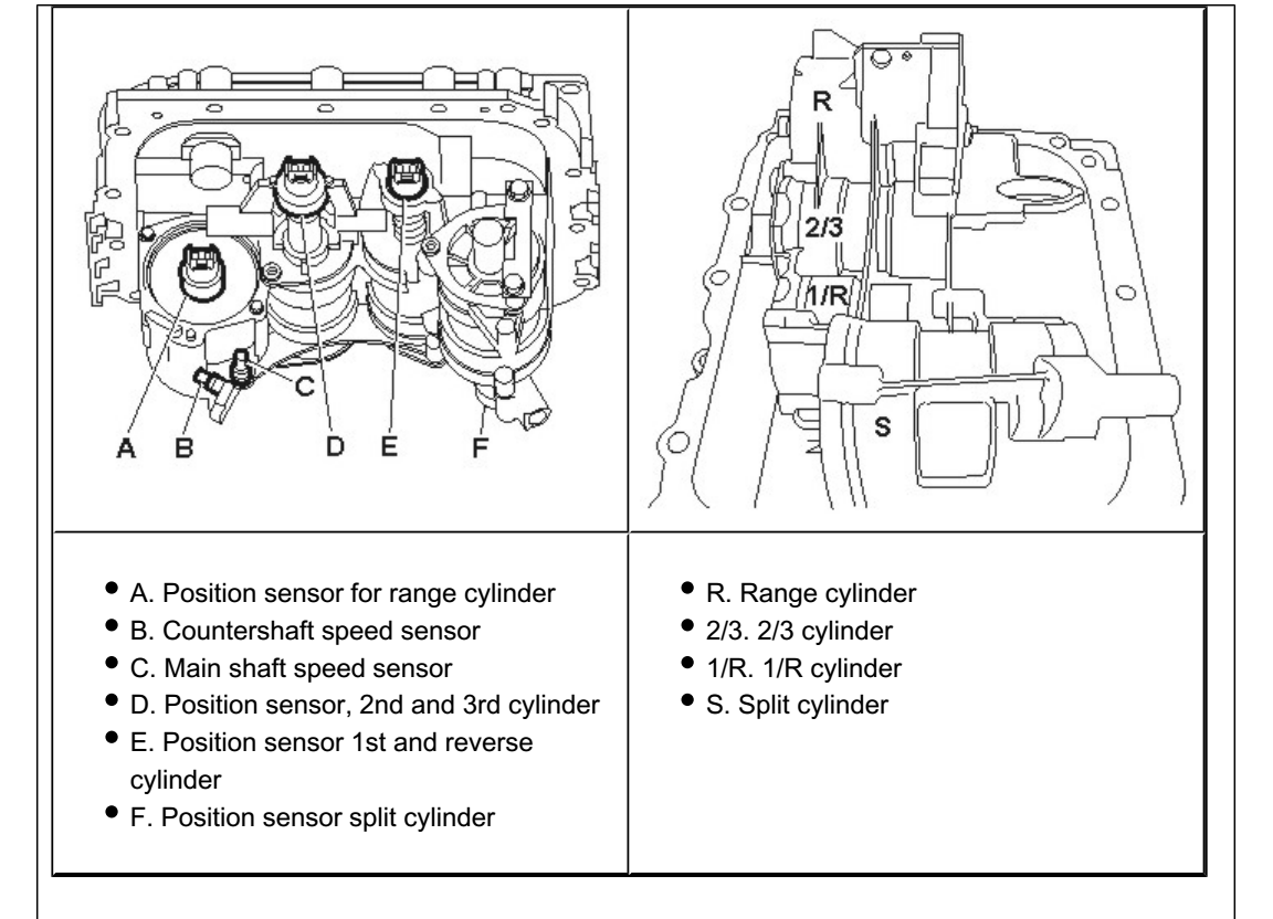

    Hello, help please, the car is on the road and during driving a Mid130 Psid15 Fmi5 error was given. No gear could be engaged. After switching off the engine and restarting puts in 1 gear and sometimes shifts to 2 and higher does not want. I read that it is a broken solenoid valve for cylinder 2. Where to look for this? Is it one of the 9 coils under the lid of the box? I am asking for quick hints

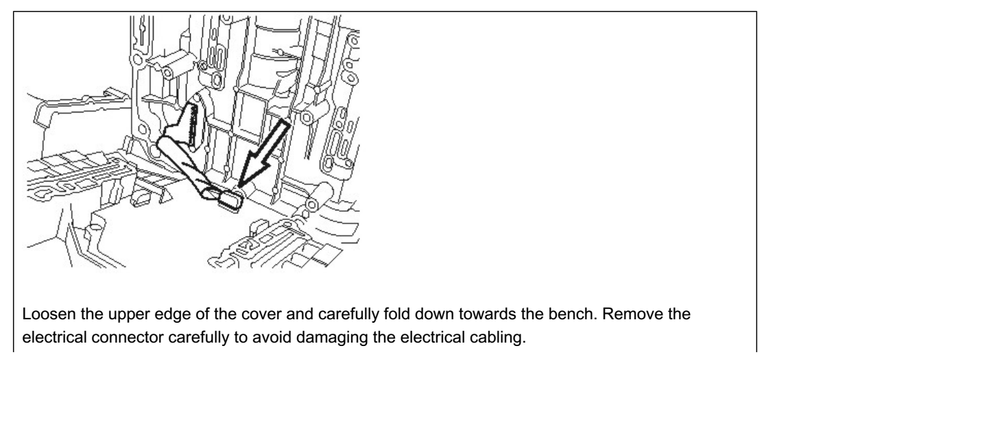

    The selector to remove, you must look at the inner piston rod because it may also be cracked. Watch out for the tape that connects the electronic and mechanical parts.

    Here is some more data.

    Which of these diagrams is the external solenoid valve exactly?

    In the figure it is 2. As for the safe mode, unfortunately Renault does not have this option. In the manual there is only a description of the safe mode when the selector is disconnected or damaged, and it sounds like this:
