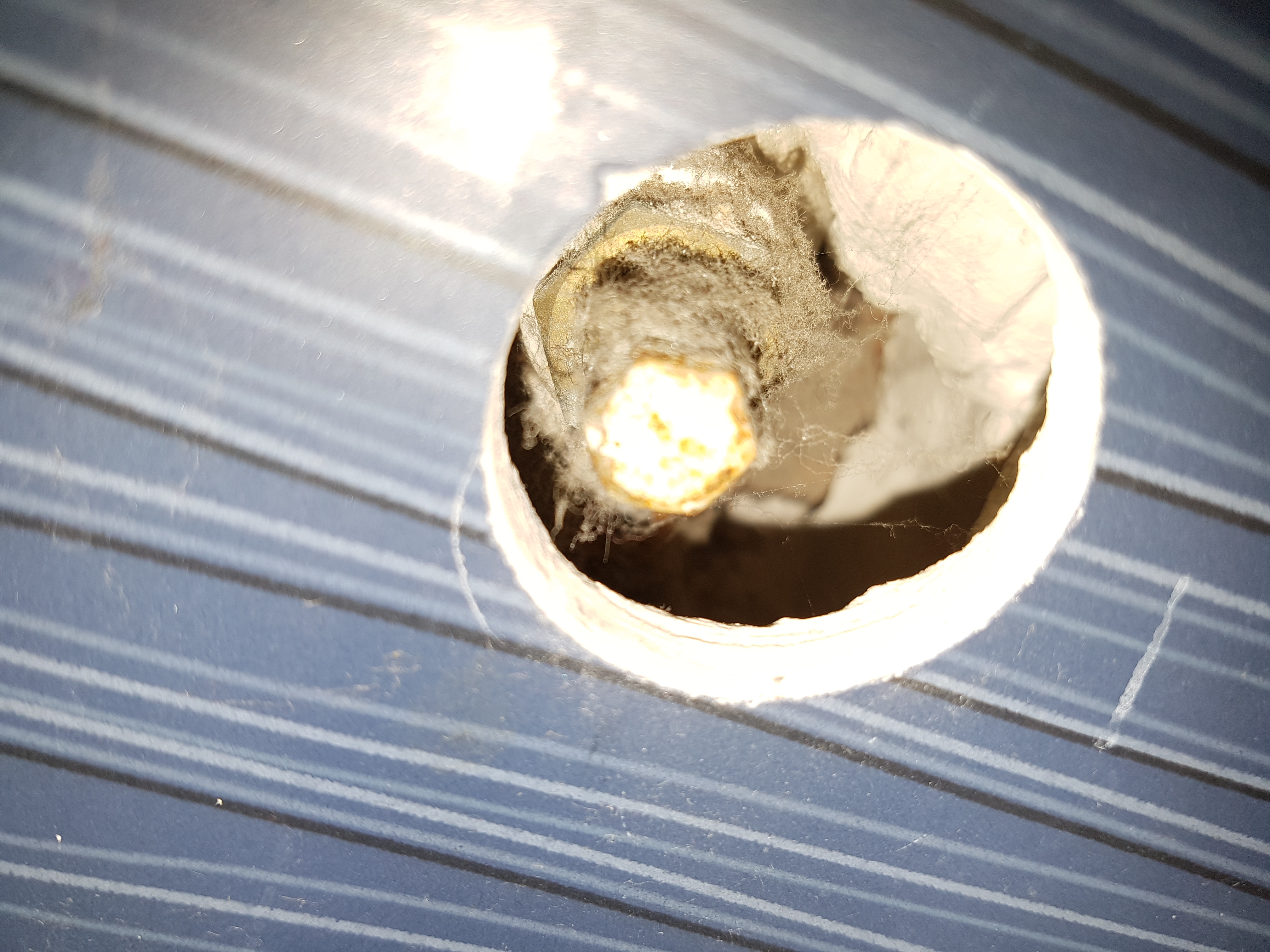

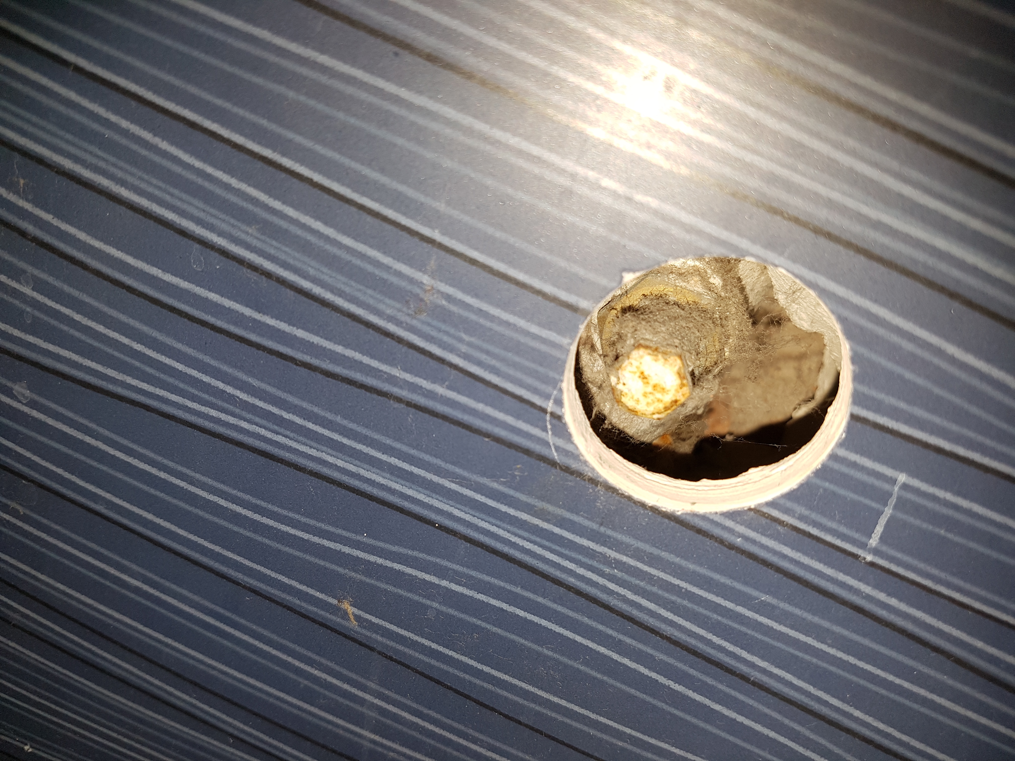

    Posts: 8
    I have a flat to take care of, without the possibility of asking about technical matters of the person who previously lived there.
    I found something like this (as pictured) and I wonder what is it? My first idea is that it is the main water valve (I haven't found another candidate for the main valve, but maybe there is something else somewhere behind the cupboards).
    Unfortunately, I did inquire at a few plumbing stores, and a few people said it didn't look like a valve, rather a clogged tee / muff.
    I would be grateful for your thoughts, what in your opinion could it be? And if the water tap, has anyone seen a similar one (I would then like to buy the same one to have a handle)?
    Main Water Valve or Clogged Tee/Muff? Identifying Flat's Plumbing Component (Photos Attached)
    Thank you in advance for your help!

    Maybe if you scraped it a little and dug into the right shape, you could recognize something more. So far, it is more of a tee with a screw-in cork, wrapped in tow, slightly plastered ...

    The valve is not 100%, keep looking ;-)

    Where is this item located? Kitchen, bathroom, low to the floor, or maybe at the level of the sink?
  • #5 16824612
    wiliwi
    Posts: 8
    The element is 15 cm above the ground, behind the toilet. 40 cm. on the left is a wash basin. There is a wall on the right and a kitchen on the other side.
    I'm going to do it, but it requires removing the toilet and perhaps removing the tile.

    Dust it a little before taking another photo.
    There it looks like it has a head, it can be a valve, but also a radiator ;) .
    What water do you have (hot you heat yourself), maybe you should have two from warm and one second from colder?
    You got a meter out there somewhere. Maybe the main valve and the meter is outside the apartment.

    I got the water and sewage plan from the administrator and it looks like the riser goes directly after this valve from the photo, so it's probably the main valve ...

    It seems to me that someone simply could not close the valve with a standard lever and screwed a hexagonal screw into the head.

    It looks to me like a "former" water valve with a brass plug on a hexagonal key.
    The valve was no longer needed so someone blinded it.
    However, as already mentioned, dusting and taking a picture would help :)
    best regards
    Edit:
    It was not needed or it was leaky.
    If you need to get to know the details of the installation, it will probably not be without a visit from a decent plumber.
    Somehow I can't imagine an apartment without the possibility of shutting off the water supply only to this premises, closing the water to the entire tenement house in the event of a failure in one apartment is a bit pointless :)
