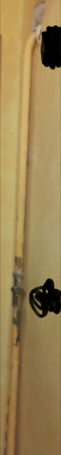

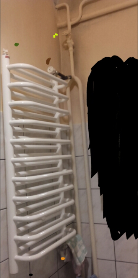

    Yesterday I started draining the water from the radiator. I turned off the valve (brown color - attachment 1) and unscrewed the valve (black color - attachment 1). The water flew and flew. I didn't let it go all the way. I suspect that I may not have turned off all the valves yet. For example, the valve (orange and yellow were open all the time - attachment 1).
    As for attachment number 2, it is a pipe whose elbows are just entering the radiator and there is also a half-and-half valve there in the middle (black color - attachment 2).
    Thank you.
    Goodbye.
    • Troubleshooting Gurgling Radiator on 4th Floor Apartment: Valve & Vent Tips Załącznik 1.jpg (195.54 KB) You must be logged in to download this attachment.
    • Troubleshooting Gurgling Radiator on 4th Floor Apartment: Valve & Vent Tips Załącznik 3.jpg (208.55 KB) You must be logged in to download this attachment.
    • Troubleshooting Gurgling Radiator on 4th Floor Apartment: Valve & Vent Tips Załącznik 2.jpg (56.31 KB) You must be logged in to download this attachment.

    And what are these two pipes in parallel with the radiator vertically?
    Did it ever serve as a heater?
    What does the return from this new radiator look like because it is not visible in the picture?
    Are these tubes plugged somehow, or are they still heating, because maybe most of the water flows through them?

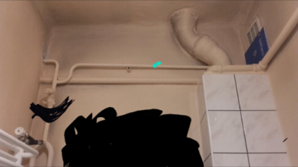

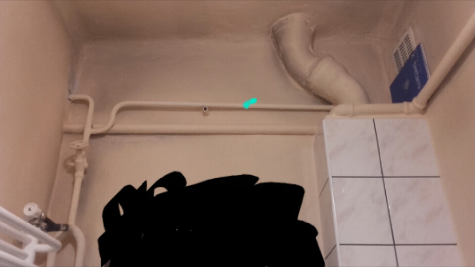

    The 2 tubes that are parallel to each other are either outflow or inflow tubes (hard to tell). They are definitely warm.
    The tube marked in turquoise (attachment 2) - it goes to the kitchen (also to the radiator). The pipe underneath is the pipe from the gas to the stove. In the past, there was no radiator in this bathroom, only pipes, and from what I remember they were warm in winter.
    The entrance to the new radiator is marked in brown (Appendix 1), and the exit (I think) - in orange (Appendix 1). From the "outlet" of the radiator, the pipe goes to the valve marked in black (Annex 3).
    In fact, all the pipes around the radiator are warm.
    I will add that on Friday I will try to drain the water again.

    Something is slowly clearing up. Write more or give a photo of the place where the return of this radiator is connected. There are probably cloths hanging there and you can't see them. And where are the lower ends of these 2 vertical tubes connected?
    Added after 3 [minutes]:
    I suspect that's the culprit here ?
    The water flows through these vertical tubes because it is easier for her than to tangle around the radiator.

    How would you show more precisely in the pictures how you have welded ends from the radiator to these thick pipes. And for the future, do not specify the points with a color, for example a number, because the color is not always displayed correctly.

    For these tubes there is only this open valve (attachment - valve underlined in black).
    The pipe in the lower right corner of the radiator is a pipe that goes only through the wall and is welded into a vertical pipe with a half-open valve. However, the upper pipe with the main valve is welded below the open, underlined valve with one end into a thick pipe, and with the other it goes through the wall and with an elbow enters a vertical pipe with one open valve.
    • Troubleshooting Gurgling Radiator on 4th Floor Apartment: Valve & Vent Tips 2019-12-12 19.29.00.jpg (224.35 KB) You must be logged in to download this attachment.

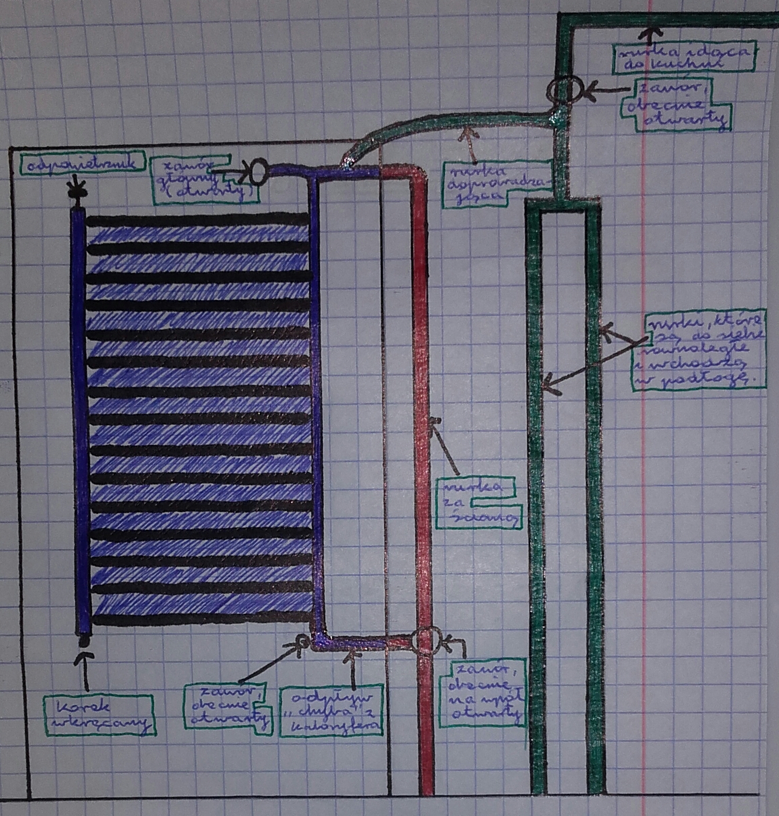

    Is it something like this?
    Download (1.8MB)
    Now describe what this red tube is. To what and how it is connected because it is not clear from the drawing what goes where.

    For complete happiness, there is still no information about what is happening with these tubes at the bottom, are they all connected together as if to one tube that can be a return? Because for now it looks like it has no right to work properly, the water flows only through these vertical pipes because it is lighter, and only a substitute goes to the radiator.
    And who installed this radiator and why doesn't want to take responsibility for its correct work ??
