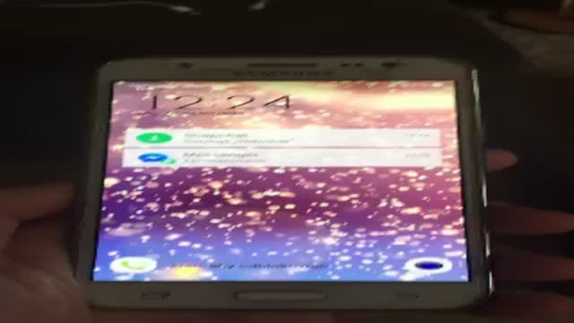

    I have a problem with Samsung J5 with andk 5.1.1 lollipop
    After the screen is locked, the screen turns on automatically and in a moment goes off and again and again as if it were pressing the POWER button itself.
    I will show it in a video how it looks.
    [Film: a51c687a62] https://filmy.elektroda.pl/11_1511868502.mp4 [/ film: a51c687a62]
    Does anyone know how to fix it?

    From what I associate it is a typical glitch for J5, specifically one of the versions (2015,16,17) definitely has this drawback.
    The repair consists of replacing the Power button, the button is soldered on the motherboard, also without the ability to disassemble the phone and soldering, and the appropriate equipment you have no chance to do it yourself ;)

    The phone probably after flooding at the bottom of the motherboard check if you can not see anything then disconnect the bottom buttons and see if this happens, if not then you have the answer.
