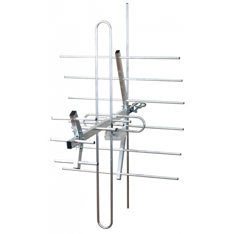

    Good day.
    I have an antenna "UHF TV antenna 11 elements Dipol 11 / 21-60 DVB-T UHF Code of goods: A1112" and I intend to modernize the installation. That is, buy one VHF antenna together with UHF, which will be mounted on the balcony, which will receive MUX - 1, 2, 3, 8, L3. Separate antennas, VHF and UHF are out of the question?
    When cars pass by the balcony, the TV is distorted at this time. I do not answer MUX - 8 as of today.
    I live on the 1st floor, where the balcony is on the street side and there is a tenement house behind the street.
    27 Bardowskiego Street Częstochowa
    Installation diagram is.
    On the balcony for now there is an antenna on UHF, where the antenna splitter for two TVs comes out. The distance to the second room is about 5-7 meters.
    Installation scheme

    My question 1.
    What components are needed to receive MUX - 1,2,3,8 and L3 for two TVs?
    My question 2.
    Which antenna should I buy for MUX reception - 1,2,3,8 and L3 for two TV sets, will an amplifier be needed, if so which one?
    Thank you for your answer.

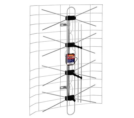

    On the balcony on the 1st floor? I am asking you ... Buy a simple grid with an amplifier. At least you won't get too wet if it doesn't work.

    The transmitter Węczyca Wielka is about 20 km away but the reception location is very poor.
    Not enough that the 1st floor, a tenement / two-story house on the road, are still large trees on both sides of the street. I see reception in this area on the directional antenna (s) in black. It will be very difficult to hit the beam of reflections. I propose an antenna with a wide field of view capable of capturing / collecting signals from scattering.
    It can be a grid or any of the asr family but not IQ. It would be good to measure the reception capacity in this location (balcony).

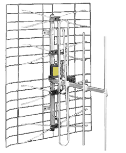

    That should probably do the trick No MUX-8, what antenna to buy for MUX reception - 1,2,3,8 and L3 on 2 tv. 2 flat No MUX-8, what antenna to buy for MUX reception - 1,2,3,8 and L3 on 2 tv. 2 flat
    - Receiving channels 6 - 12; 21 - 69
    - Energy gain without amplifier 11.5 dB - 13 dB
    - Horizontal angular visibility of 46 °
    - 27 ° vertical angular visibility

    The mesh can cope despite the complexity of difficult conditions because it also has a wide "view" angle and collects signals from reflections well, but I don't know if VHF will also be visible vertically. Similarly, our asr. Either way, you can't do without trying.
    If the author arranges a trial purchase from the seller and the possibility of returning and exchanging it for another model, it will be ok.

    This retina is TV antenna set with DIPOL 3dx MUX-8 Vertical polarization Very interesting but I haven't had it yet. Even more interesting is this one No MUX-8, what antenna to buy for MUX reception - 1,2,3,8 and L3 on 2 tv. 2 flat
    These Davbol antennas are probably just the manufacturer for now. They show themselves aledrogo. Certainly the competition does not allow because they look really solid and with a head.
