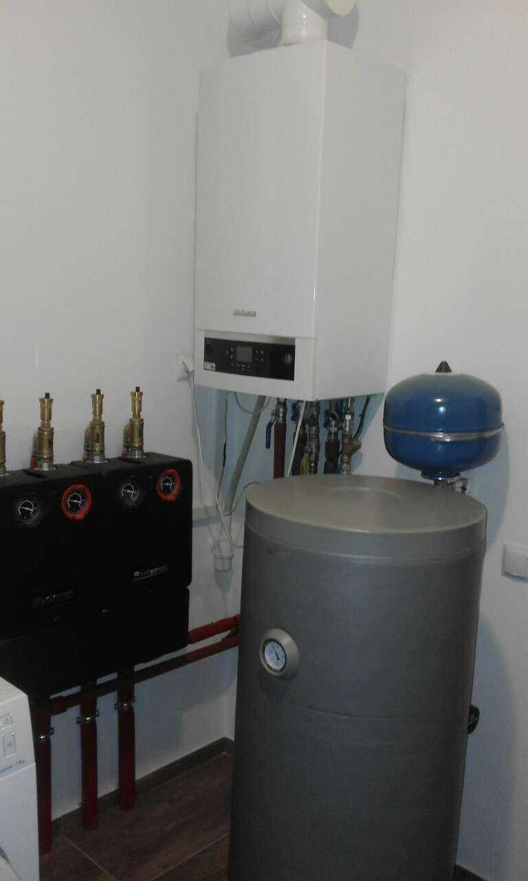

    Hello, I launched CO two weeks ago in a building completed in June. Until mid-November it was heated with a traditional fireplace. The building is made of H + H 24 cm cellular concrete, plus 18 cm foam. The ground floor has an area of 67 meters and the floor is 50 square meters. Buderus GB 072 20 kW furnace, hot water tank Galmet 115 liters, Buderus pump set. I have two separate heating circuits, each on the first floor, where the RC 300 is on the ground floor and RC 200 on the first floor + outdoor temperature sensor. I have a separate circuit in the distributors for each room. There is underfloor heating everywhere.
    After baking the screed in April, I now selected all the settings myself:
    OG 1
    19.5 day, 18.5 night
    Design temperature 48
    Maximum flow temperature 45
    4K room influence
    Room temperature correction -1k (overheating, that's why I set -1k)
    OG 2
    20.5 day, 19.5 night (higher temperatures because the controller is located in the staircase, where the heat from the ground floor affects it and thus indicates a temperature 1 degree higher than in the rooms)
    4K room influence
    Room temperature correction 0k
    Min outdoor temp -20
    Suppression NO
    Medium building type
    Optimization of switching the time program off
    Summer mode from 13 degrees
    At outdoor temperatures -1, + 3 over the last two weeks, daily burner starts are about 40-50 times, and the burner has a working time of 7-8 hours. My first request is not the burner work time too big? My second request, the stove still overheats by an average of 0.7-1.0 degrees - how to deal with it?
    The most important for me is comfort and then burning, especially since the pregnant wife is at home during the day. I have an external gas tank.
    On which circuit?
    Suppression NO
    I think it would be optimal to include.
    the furnace still overheats by an average of 0.7-1.0 degrees - how to deal with it?
    High design temperature. I think 35 * is enough, and it can still be too high.
    Too much boiler power to the surface.
    When it overheats, check the service menu diagnostics for the measured values on the heating circuit which correction the influence of room temperature the boiler has taken.
    On which circuit?
    OG1 0.5-0.7 and OG2 0.7-1.0
    Suppression NO
    After switching on, I understand that the stove will not react so often to changes in the outside temperature?
    Then the stove will not be turned on all the time? I mean here a reduction of the boiler operating temperature in relation to the outside temperature?
    In the sense, these 20 Kw is too much for this surface? Can you somewhere in the oven settings limit the power? He also heats on hot water.
    In the service menu under "Diagnosis", the room influence has a value of -4K in the monitored values OG1. OG1 was overheated by 1.1.
    I forgot to ask why for the set night temperature instead of showing this temperature, the info shows that the heating is off?
    Tonight I will change the setting according to the above and in a few days I will report.

    -4k means that the design temperature setpoint is too high.
    Heating on at night - change the setback mode to room temperature
