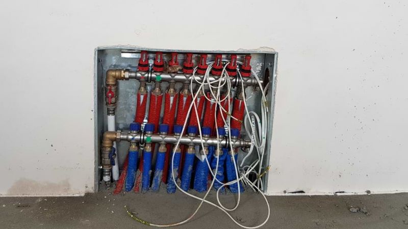

    I have underfloor heating in the house, floor and ground floor, a total of approx. 240 sq m. The heating is separated so that each room has a separate circuit (loop) fastened to the manifold (one for each floor). There is no automation on the manifolds (only valves). There is a single-function condensing oven with a weather sensor and a smart controller, but placed on the stove so far (fresh thing, the stove started on Saturday).
    I have two options to play the topic of heating control.
    Option 1
    The furnace control remains on the furnace. The furnace will control the temperature of the heating water based on the outside temperature (from the sensor) using the temperature set on the furnace but also according to the heating curve set there instead of reading the real temperature in the rooms. In the rooms there will be thermostats that will control the valves on the manifolds, if necessary, opening or throttling the flow of water in a given circuit (loop).
    Option 2
    The furnace controller is moved from the boiler room to the hall below, or a second one at the top. The furnace controls the water temperature based on the measurement of the real interior temperature, thus correcting the heating curve (and probably somehow taking into account the outside temperature). We do not install thermostats or actuators in manifolds, we set them manually on manifolds or throttling in some rooms so as to obtain an appropriate temperature distribution.
    Which of these options is better?
    Specialists in underfloor heating (those who made them) say that option 1 should be used. However, I think that option 2 may be much better, more sensible - because there is a chance for less gas consumption, especially since the house is b. solidly thermally insulated.

    Flow meters may not show flow or will not open at all. In them, the water is to flow from above, then with appropriate pressure press on the mushroom and this entails a flow indicator.
    On the bottom beam, the inflow to the stop valve head can cause a rattling because here the water inflow should be from below.
    It's best to swap the beams themselves if you don't want to rework the pipes. Only on the upper beam there must be space for the thermal actuators to fit, and you will have little space there when you swap the beams. Rather, for the sake of peace, redo as it should be.
    #13 17067573

    The distributor photos show that the power supply is the upper beam with rotameters (red dot) and the return is the lower beam (blue dot). Well, but for sure you can check the rotameters.

    Such control should look in such a way that a given temperature controller from a room or the whole level (simplified version) opens a given circuit (or the entire beam - up or down) using a servomotor and at the same time the boiler starts. If the control will be individual for each room, we leave some circuits without an actuator, e.g. hall, bathroom, and there will be no problem with closed circuits for the time the thermal actuator is activated.
    As for rotameters: at the moment they work as you turn on the boiler? if so, then the power directions are fine.
    You write that you don't have any wiring, what are those wires in the picture?
  • Rotameters indicate supply and thermostat wiring on first floor
    It was supposed to be like that, but after turning on the heating, it turned out that the lower beam did not heat up, from which I conclude that this is where the entrance is and return from the upper, which is the opposite of how it was supposed to be. Let's add that the ground floor is the opposite, that is correct, and the rotameters are completely different and I do not know how to read them.
    Added after 1 [hours] 49 [minutes]:
    It's hard for me to say this because I see the rotameter for the first time :) nevertheless they are empty i.e. steamy but not full of water. They look different from the ones I have on the splitter at the bottom, but those are also a different model (they do not have such covers).
    These wires are distributed to rooms on the first floor, they are to supply the signal from the thermostats in each of them.
