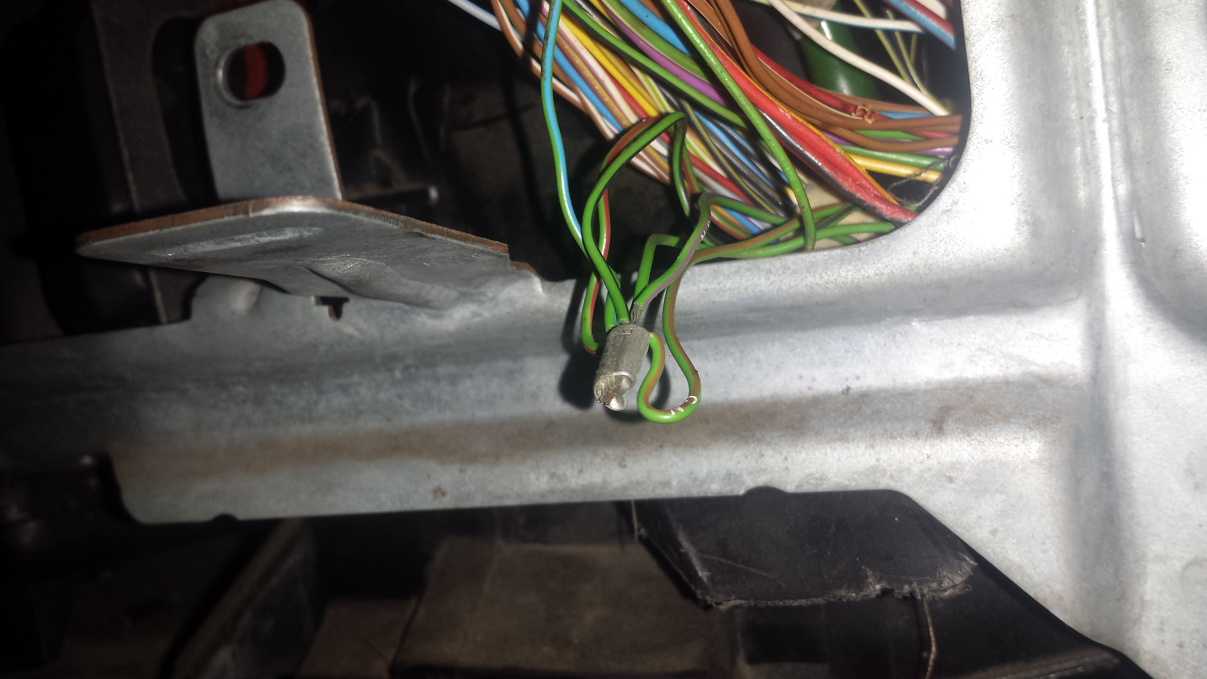

    Welcome to my audi, I can't connect through OBD with the engine. You can connect with air conditioning for it. 1.8 lpg engine. Anyone have an idea what could be? I read that it can be through lpg but how to get around it?

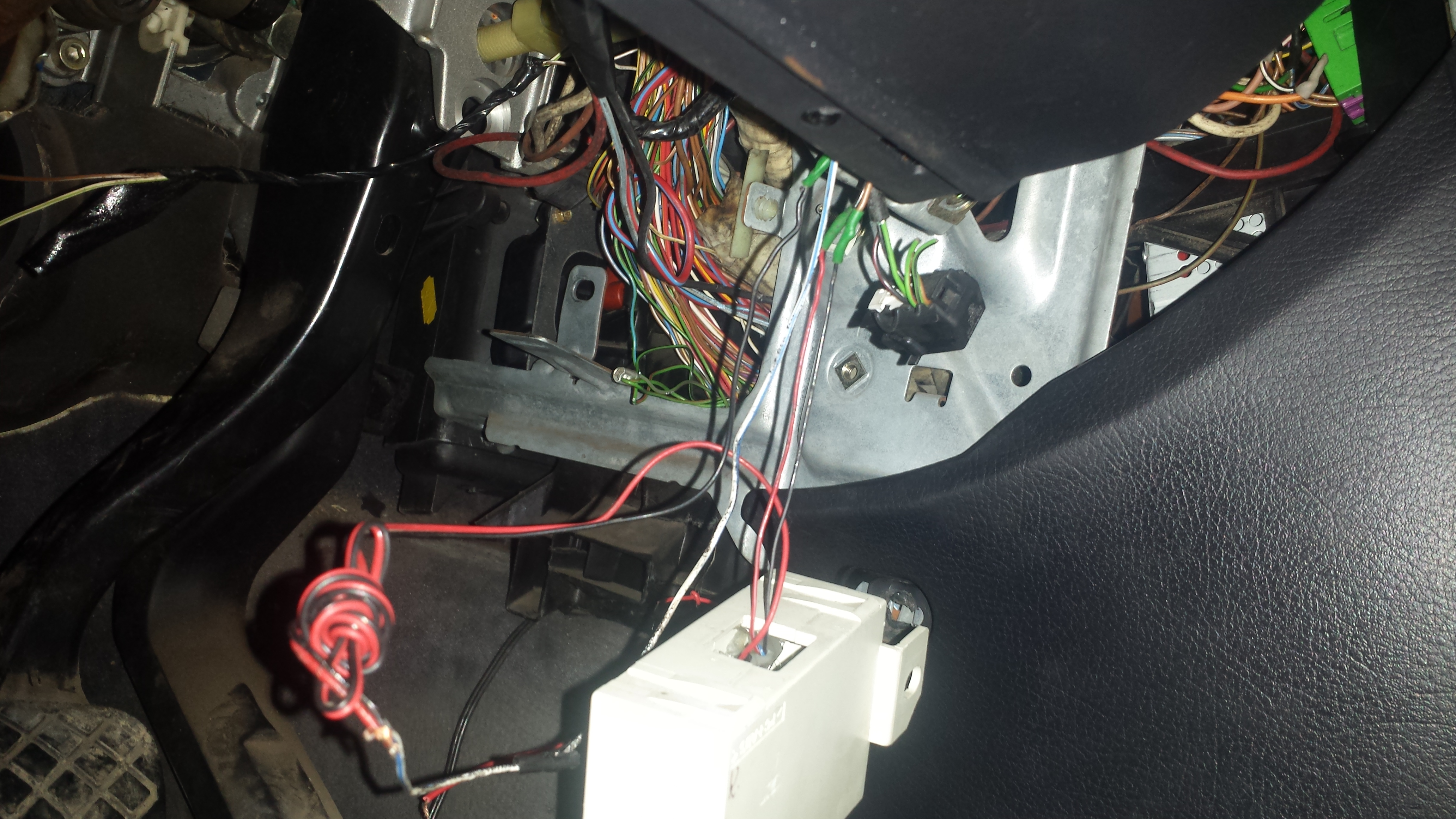

    I did not check with the key but the immo box is but only 3 cables come from it. It is also like a torn ankle next to nothing with green cables. So this will be an emulator in the immo box?

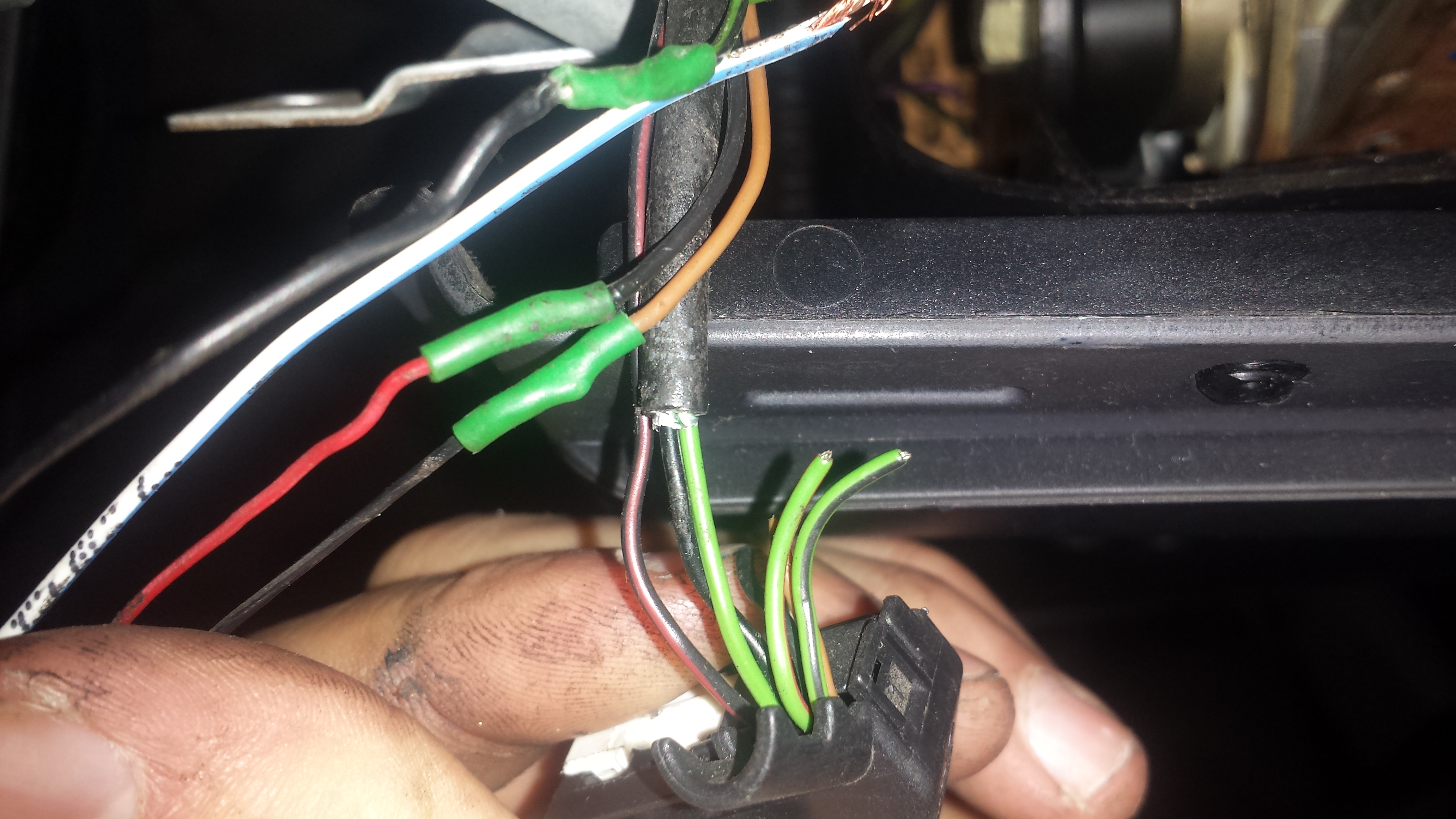

  • #15 16939759
    golabek008
    Posts: 82
    Rate: 12
    I connected the cables but nothing came of it. I noticed that it does not connect with the climate. I will add pictures of these cables because I don't know if it should be like that.

  • #16 16939771
    golabek008
    Posts: 82
    Rate: 12
    It follows that black and green combined with red from the can of immo. I closed with green-red but nothing came out. On one of the pictures is also a connection of several cables in which is red and green so I have no idea if it should be?
    #17 16940968
    spinacz
    Level 42  
    Posts: 8576
    Help: 1204
    Rate: 2654
    If you now have a compact green-black with green-red and red from the immo can, does the car start?
    If it starts, cut the red that goes from this connection to the immmo can, if the car does not start, then check if you can make a diagnosis.
  • #18 16950238
    golabek008
    Posts: 82
    Rate: 12
    I did as you wrote and can be connected. I did it on the switch and it is even possible to read errors on the firing if the switch on the running engine is switched on. Thanks for the help ;)
