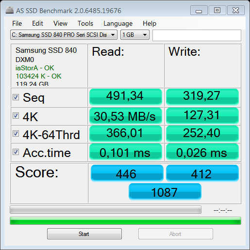

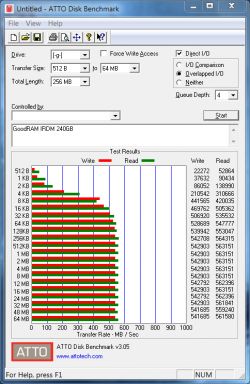

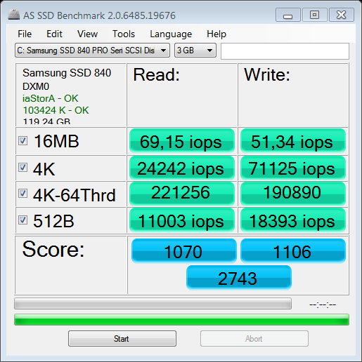

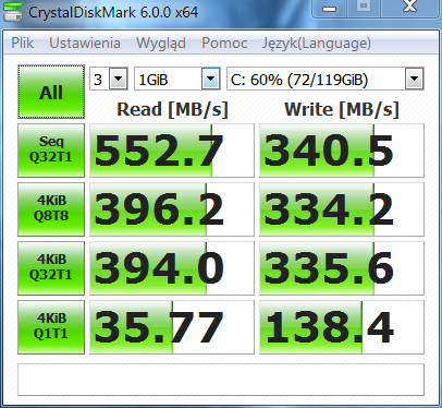

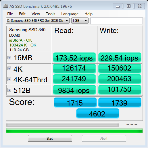

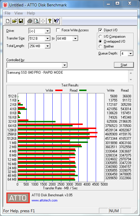

    In each test there will be three screenshots, from the left:
    1) Samsung SSD 840 PRO 128GB - Rapid mode enabled :)
    2) Samsung SSD 840 PRO 128GB - without Rapid mode
    3) GoodRAM IRDM 240GB (IR-SSDPR-S25A-240)

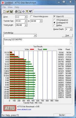

    Test # 1: ATTO Disk Benchmark , default settings.
    GoodRAM IRDM SSD 240GB IR-SSDPR-S25A-240: Phison PS3111-S11 Controller and MLC Memory Review GoodRAM IRDM SSD 240GB IR-SSDPR-S25A-240: Phison PS3111-S11 Controller and MLC Memory Review GoodRAM IRDM SSD 240GB IR-SSDPR-S25A-240: Phison PS3111-S11 Controller and MLC Memory Review
    Test # 2: Crystal Disk Mark (above: on 1GB of data, lower on 4GB of data, average data of three tests)

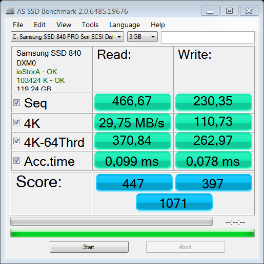

    Test # 3: AS SSD Benchmark (above: on 1GB of data, less on 3GB of data)

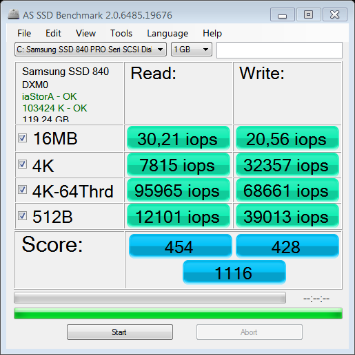

    Test # 4: AS SSD IOPS (above: on 1GB of data, less on 3GB of data)

    As you can see, IRDM, despite the seemingly weak controller, does not have any bad performance (looking at the controller's specification I expected some massacre, and it did not work out badly here). I wonder what the performance of Iridium PRO looks like compared to this IRDM. If Iridium PRO falls into my hands I will do the same set of tests for comparison (the test would be done on the same machine, on the same settings, so this comparison would be quite reliable). Maybe these benchmarks will be useful to someone, as he will think about the cheap disk ;)

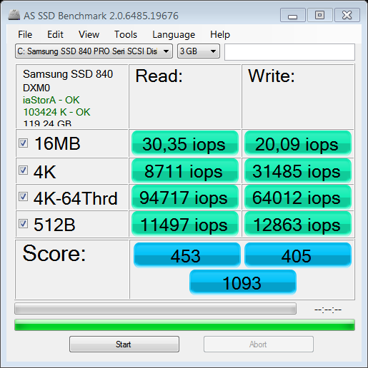

    These IRDMs generally fall out better in tests from that of Iridium Pro what happened to my brother.

    Here, I compared Iridium PRO and IRDM, this is a topic rather related to IRDM. The thread with the results of Iridium PRO is here: https://www.elektroda.pl/rtvforum/topic3434173.html
    In this thread, we do not solve hardware problems, but in one word - you can try to install your brother SATA driver from Intel, from what I see you use the driver built into Windows. My tests I did on the Intel driver (although on the desktop), you can see that 4K I have a tad better (although it is not a gigantic difference).
