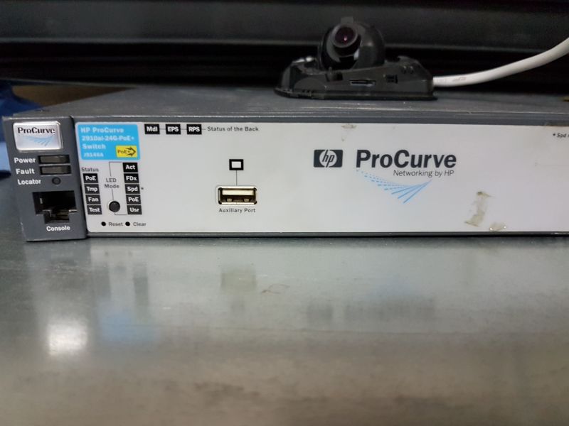

    I have at my disposal:
    10x ip cameras powered by a poe system
    1x 24 port poe switch
    1x Win7 server, which is to fulfill the functions of a recorder
    1x internet modem
    The basic question is what cables should I use online simple or crossover.
    Server (recorder) for Switch I understand that the cable type is straight.
    Switch cameras?
    Modem for switch?
    A camera register will be kept on the server but it must also be possible to view cameras online from a smartphone.
    Thank you in advance for all relatively simple and not too deeply arising issues.

    I agree that it is better to buy a set for this purpose but I have the above equipment and I would like to use it. Hp 2 x 3.6 4 core server with 16 Gg RAM memory, Switch HP ProCurve and 20 MB / sec internet of course in theory.
    Configuring and Connecting 10x POE IP Cameras with Win7 Server and 24-Port POE Switch Configuring and Connecting 10x POE IP Cameras with Win7 Server and 24-Port POE Switch Configuring and Connecting 10x POE IP Cameras with Win7 Server and 24-Port POE Switch Configuring and Connecting 10x POE IP Cameras with Win7 Server and 24-Port POE Switch
    Added after 3 [minutes]:
    The picture shows 3 servers each with a similar configuration. However, as for the system is currently Win 7 but you can change it because the server will only be used for monitoring supervision. Let me just add that I've never dealt with Linux.
