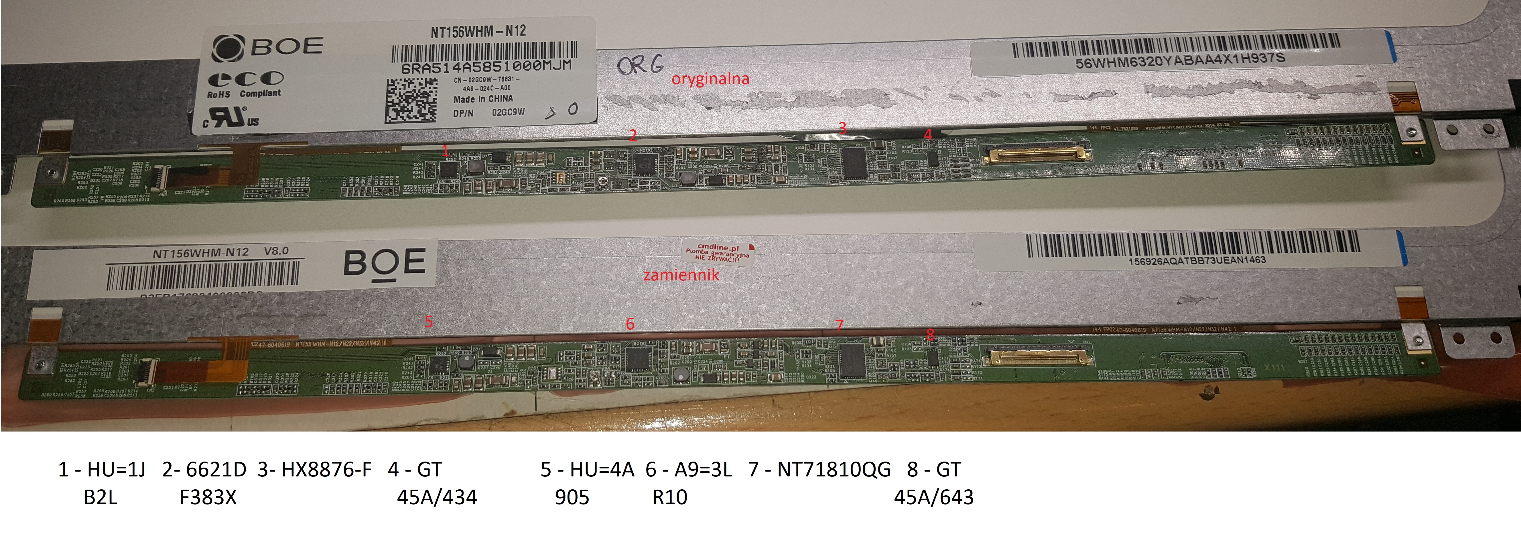

    Hi. I replaced the matrix in this Dell and the backlight adjustment does not work. I learned from the seller that this is the fault of incompatible eprom memory. He recommended me to either program it with the correct charge or solder it from an old LCD.
    Fortunately, I have an old LCD. Please write me which systems should be moved, because they all differ from the replacement. Thank you in advance for your help.

    Replace 4 with 8.

    Unfortunately, it did not help. Laptop does not turn on after replacing this item and beeps (POST). After soldering the old system, it turns on normally. Do you know what the problem is?

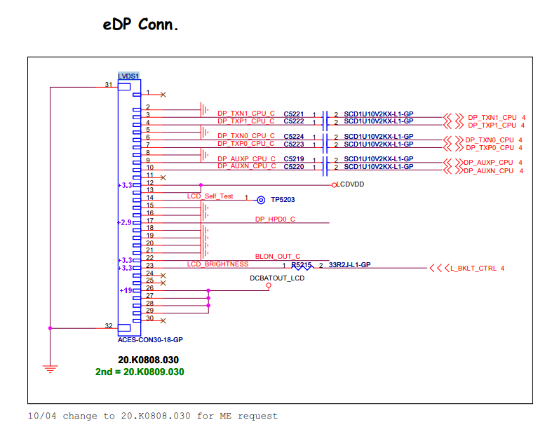

    NT156WHM-N12 is a BOE 30-pin eDP matrix!
    LED control driver HU = i.e. RT8510 (datasheet available) Link
    - pin 5 of RT8510 is backlight control
    How do you have:
    - data exchange between the eeprom and the RT8510 (oscilloscope), and
    - BLON signals, DP_HPD0 flap closing sensor (LID)
    then look for damage (no voltage or ground) on the LVDS connector, ribbon or matrix
    Dell Inspiron 3453: Backlight Adjustment Issue After LCD Matrix Replacement - Eprom Memory
    :idea: Signals necessary for the backlight to work
    DCBATOUT_LCD
    GND
    BLON_OUT_C
    L_BKLT_CTRL
    Such a matrix NT156WHM-N22 (* WEBCAM ver.) Used to be in Dell Latitude E5510 (Fonseca 15 MB 48.4EQ10.011)
    * or normal eDP, 30-pin LTN156at08

    I have programmers, can you tell me what kind of eeprom is sitting there?

    If it were that simple, I wouldn't be writing. You have the name "GT 45A / 434" on the chip. Damage the system is the moment ...
    Ps. all names are in the attached photo :)

    How is the board described in this Dell Inspiron 3453?
    How many pin. has "lvds" connector on the disc?

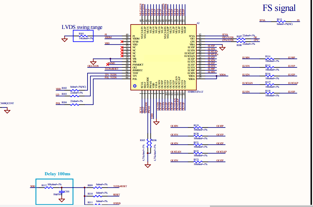

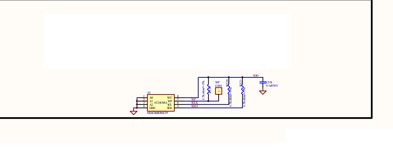

    Because the layout 3 and 7 look similar, the name HX8876-F is the Timing for matrix eDP controller
    HX8872 for HD resolution matrix I / O: LVDS / MLVDS (eDP) / 2 Lane eDP1.2 / MLVDS
    1366 * 768, CABC, 6 + Hi-FRC / 8bit, 25-90MHz 3.3V TQFP-64 / QFN-48
    other
    * HX8894 FHD LVDS / MLVDS 1920 * 1080, CABC, 8bit / 8bit + Hi-FRC
    30-90MHz 3.3V TQFP-100 / QFN-68
    then they cooperate with Eeprom eg AT24C08
    Compare the pins of this board with the At24c08 application
    See page 4 of the appendix (I recommend reading the whole one), i.e. the NT156WHM-N12 datasheet
    GT 45A Link
    * matrix b156xw04 v.7 30 pin eDP, with IC: GT41 / GT45A
    _______________
    The HT156WHM-N10 matrix has: HX8861-H QFN46
    The HT156WHM-N12 matrix has: HX8876-F
    HX8861-say it's the Novatek NT71263fg-300 counterpart
