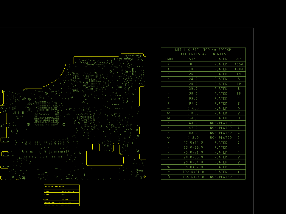

    I have boardview only I can not open it any program. It has a .brd extension but nothing moves it. Removed from vinafix.
    I do not have time to search. Write how to attach it to the post I throw it. It has 11.1Mb.
    Edit.
    I have already opened the allegro program and I will put a screenshot right away.

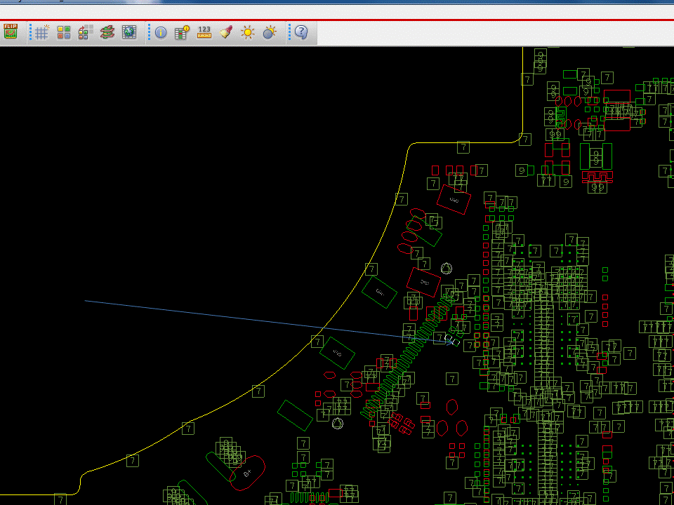

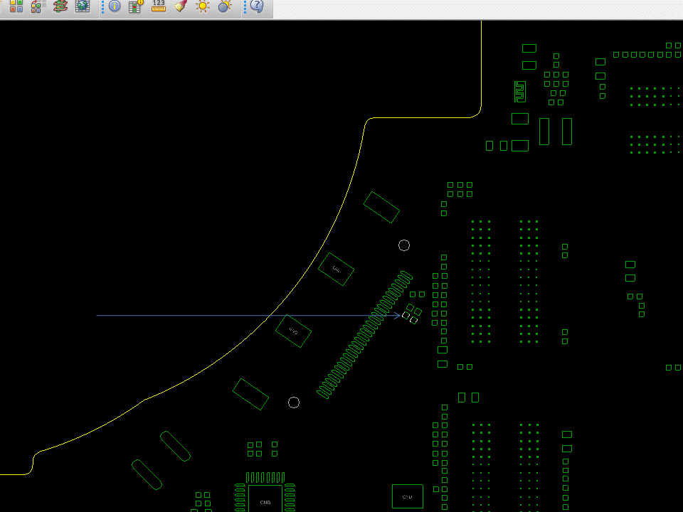

    At the beginning p Lenovo G510 - LA9641P No Voltage TL_INVT_PWM After 3V Inverter Replacement & Matrix Backlight Issue I am asking for info or such a disc shape.
    I found the R441 resistor. R431 no. I did not watch the diagram so I do not know if it is represented.

    Lenovo G510 - LA9641P No Voltage TL_INVT_PWM After 3V Inverter Replacement & Matrix Backlight Issue The arrow indicates R441. Lenovo G510 - LA9641P No Voltage TL_INVT_PWM After 3V Inverter Replacement & Matrix Backlight Issue
    Added after 37 [minutes]:
     You do not answer anything so I do not know if you already have everything or something missing.
