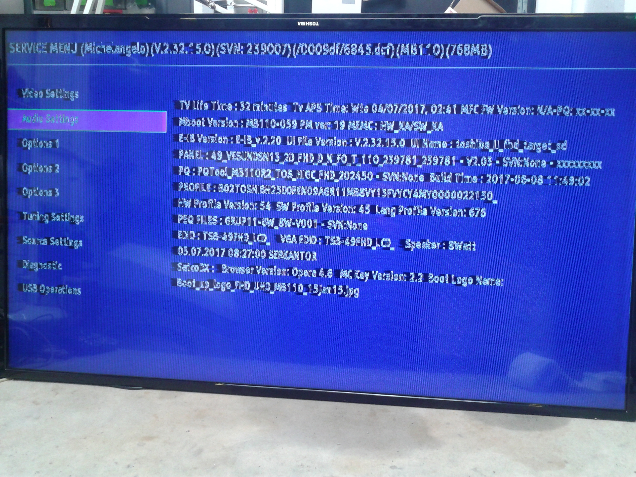

    Reflow unfortunately beat the record to the end. I also ordered another one from Toshiba. Yes, it even took off with the Toshiba logo, but with the image upside down and like in a thermal camera. So a different matrix. In addition, the original remote control did not work, but the original one from the old Toshiba worked. After consulting with the seller, I soldered the NAND memory from the old original disc. The TV does not move, only the green LED is red blinking. After returning to the original NAND from this album, the effect is as at the beginning. It only turns on the backlight and reacts to turn it on, turn it off from the remote control. A slight heating of the disc and, of course, a bad image starts up and upside down. strange that there was a fault like in the old record. Unless, while heating the disc, I also slightly warmed up the power supply ...
    Application:
    The 17MB110P NAND memory is paired with the processor :cry: .
    Since getting a plate for this matrix will be a miracle, the question of the service mode to change the matrix will be a miracle. And since there will be another pilot, it is difficult ...

    Darek.S wrote:
    question about the service mode to change the matrix.
    Unfortunately, there is not much that can be done in ordinary MS.

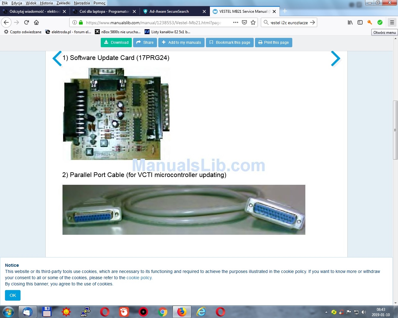

    Maybe after I?C, having the right software, something could be done? Once upon a time I made an interface on Max232. Original also available.
