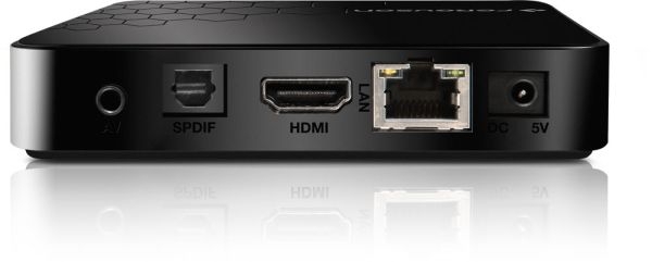

    Ferguson FBOX ATV is a small inconspicuous box measuring 10.5x10.5x2cm, weighing only 200g and a set of useful inputs and outputs. The device is passively cooled and does not emit any sounds, so it can work in the living room or bedroom. Also, the diode signaling operation of the device has been dimmed accordingly, thanks to which it remains visible, but it does not illuminate the interior of the room at night.
    Ferguson FBOX ATV with visible USB, HDMI, and Ethernet ports. Back of Ferguson FBOX ATV device with AV, SPDIF, HDMI, LAN, and DC outputs.

    Also in terms of the richness of the offered connectors, the FBOX ATV stands out from similar devices. FBOX ATV offers the following connectors:
    o 2 USB ports (including one USB 3.0)
    o microSD card reader
    o SPDIF digital audio output
    o HDMI 2.0 output
    o 3.5mm AV output (thanks to it you can watch Netflix even on old "bubbles"!)
    o RJ45 Ethernet connector
