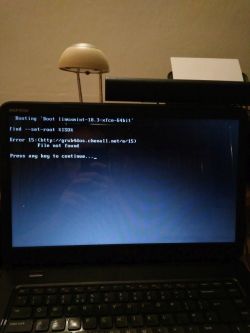

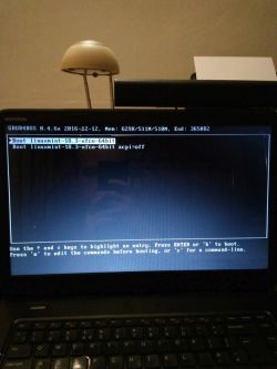

    @piterrr_ I am trying to install using Universal USB Installer 1.9.8.0 on a pendrive (14,3 GB of actual capacity) Linux Mint 18.3 (x64) from Xfce. I do this using such settings:
    Simple Linux Distro for Windows User: Install on Pendrive, Driver Compatibility & Size Tips
    After completing the installation and starting the computer with the pen, I can see:
    When I choose any of the two options above, the effect is:
    Question: what am I doing wrong? NTFS format or too large file size in step 4?
  • #4 17016171
    dt1
    Admin of Computers group
    Posts: 48258
    Help: 7315
    Rate: 8292
    Show the contents of the menu.lst file, it should be in the main pendrive folder.
  • #5 17017988
    rostov84
    Posts: 924
    Rate: 213
    @dt1
    # This Menu created with Universal USB Installer https://www.pendrivelinux.com
    default 0
    timeout 30
    color NORMAL HIGHLIGHT HELPTEXT HEADING
    foreground=FFFFFF
    background=000000
    title Boot linuxmint-18.3-xfce-64bit
    set ISO=/linuxmint-18.3-xfce-64bit.iso
    set CASPER=/casper-rw
    find --set-root %ISO%
    map %ISO% (0xff)
    parttype (hd0,3) | set check=
    set check=%check:~-5,4%
    if "%check%"=="0x00" partnew (hd0,3) 0 0 0
    if NOT "%check%"=="0x00" echo ERROR: third partion table is not empty, please delete it if you wish to use this method && pause --wait=5 && configfile /boot/grub/menu.lst
    partnew (hd0,3) 0x00 %CASPER%
    map %CASPER% (hd0,3)
    map --hook
    root (0xff)
    kernel /casper/vmlinuz file=/preseed/linuxmint.seed noprompt persistent boot=casper iso-scan/filename=%ISO% quiet --
    initrd /casper/initrd.lz
    title Boot linuxmint-18.3-xfce-64bit acpi=off
    map %ISO% (0xff)
    map --hook
    root (0xff)
    kernel /casper/vmlinuz file=/preseed/linuxmint.seed noprompt persistent boot=casper iso-scan/filename=%ISO% quiet acpi=off --

  • #8 17022517
    rostov84
    Posts: 924
    Rate: 213
    @ rtj71 , unfortunately, the effect is the same: Error 15, File not found.

    Ultimately, I decided on Linux Mint 18.3 (x64) with Xfce. First, I recorded the ISO image on a DVD-RW disc, and installed it on the pendrive. It's so nice. :)
