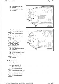

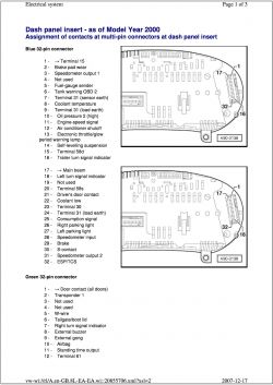

    I found such cube diagrams from the counter: check to 14 pin in the green cube, and which pin is from the green position / dipped beam indicator?
    Audi a3 8L - Problem with the meter and indicators in the audi a3 Audi a3 8L - Problem with the meter and indicators in the audi a3 Audi a3 8L - Problem with the meter and indicators in the audi a3
    I also found the pinology from these position lights except that from passat and there it is written that pin 3 in the green cube T32b only is it the same in a3?
    http://www.vwgolf.pl/porady/passat-b5-1996-2005-pinout-licznika/
