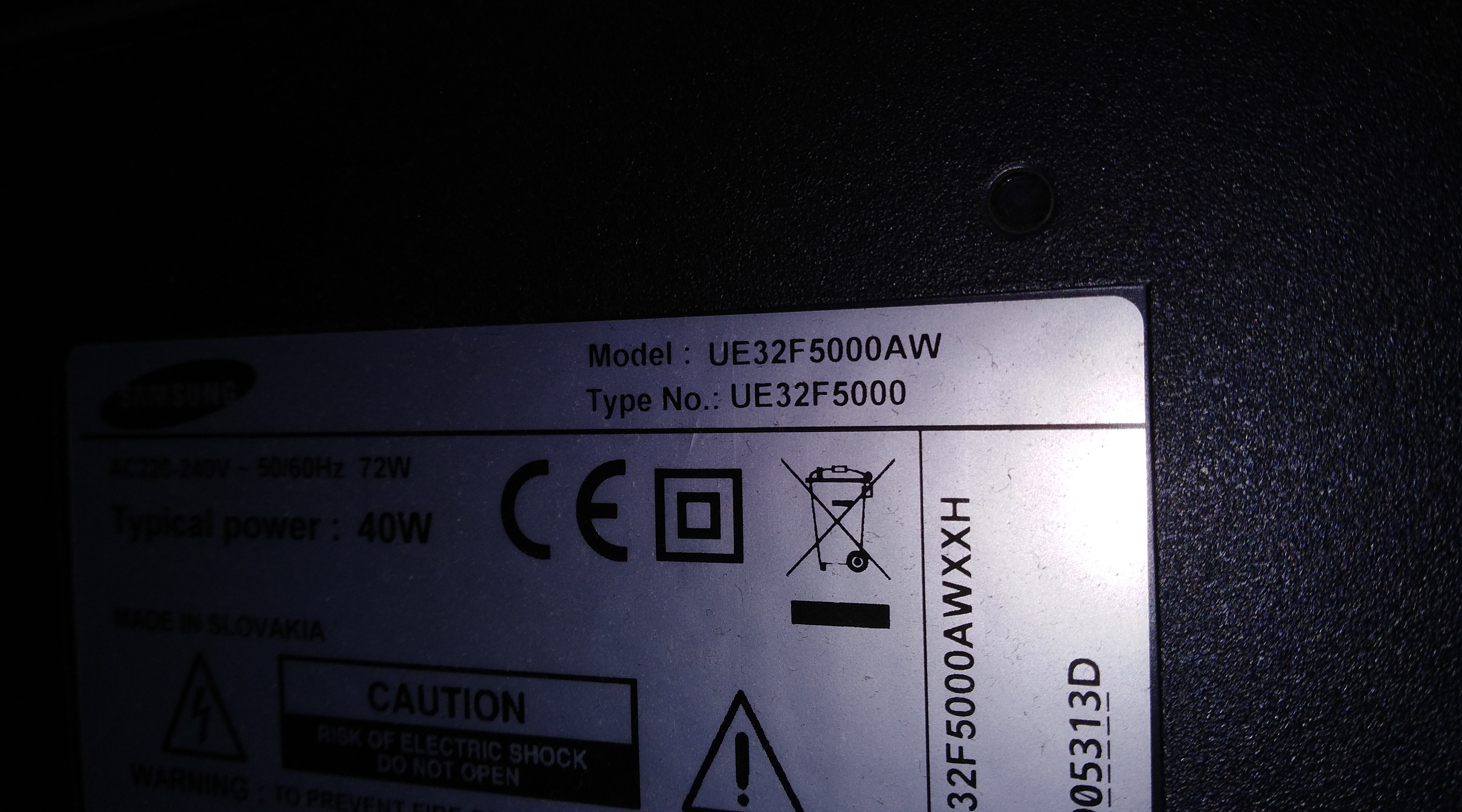

    Hello, I have such a problem this morning, I turned on the TV, the picture appeared for a while and went out, all the rest works only the picture does not and I will add that as candles, flashlight under the appropriate account on the TV, you can see the content of the image I combined in the settings restored the factory and unfortunately I do not know the tv model thanks in advance for your help.

    Is there a way to check it because I don't have a box, unfortunately? And what about the cost of repairing it
    I already found it

    You need to unscrew the TV and check the voltage on the cables going inside the matrix, it should be within 70V, if it is necessary to lay out the matrix and check the LEDs in the strips individually or they are lit.
