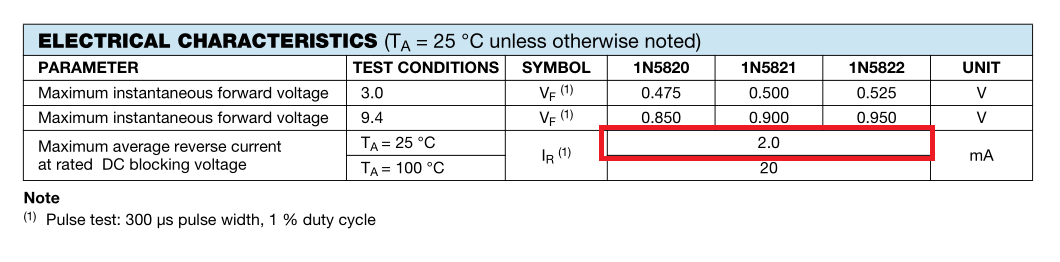

    Is there any test to be sure to exclude diode damage?
    Compare with the catalog parameters, after all, the manufacturer writes this documentation for something
    1N5822 Schottky Diode Reverse Direction Voltage Drop Test: Is 3V Drop and LED Glow Normal?
    If the manufacturer states that there will be no more than 2mA at 40V, then any LED with more is defective.
    2mA is a lot, but high reverse current is typical for Schottky diodes. Usually in these diodes it is so that the better the parameters in the forward direction (lower voltage drop), the worse in the reverse direction (reverse current). In these 2mA, the manufacturer has left some reserve, so it is very unlikely to meet a diode with as much as 2mA.
    In pn diodes, the reverse currents are much lower (nA) and there are also diodes so good that they have less than 1pA, of course, it also depends on the size of the diode structure, and thus indirectly on the catalog maximum current.
    As a curiosity, I can say that LEDs have one of the lowest leakage currents, provided that no light is falling on them, sometimes peak detectors are built on them (with an amplifier that eliminates a large voltage drop)

    Don't taxi a young adept. The diode is ok in the directory. The table is not precise. Again I refer to the chart (link in my first post)
    This reverse current has no practical significance in this application and you can safely use this diode.
    The table is not precise? - do you know what you are talking about? the documentation contains typical and guaranteed parameters, in the chart they are typical, in the table guaranteed. If someone asks what current to expect, look at the graph. However, when asked how to check if the diode is not damaged, you need to look at the table. Because although the typical value is in the order of 0.05-0.1mA, the manufacturer only guarantees that it will be lower than 2mA.

    I understand it as follows: To check the diode, we look at the table. We measure the reverse current and compare. If it is higher than in the table, the diode is defective according to the manufacturer.
    And now we take the graph. We measure the diode, the diode has a deviation from the graph. According to our own whim, we define whether such a diode is still useful for us or not. Because even if it has twice the reverse current, it will not interfere with most applications.
    Both methods are appropriate, only the contractual limit is included in the table. Unfortunately, the table contains only two temperature values. So we have to bring the element to this. Using the chart, we can ignore heating to 25C or 100C. This is the advantage of the chart, at least from my point of view.

    I did not want to lower your self-esteem so much, it is not a matter of handicap but the number of read notes and application notes (there are also such "how to read datasheets"), which you can easily make up for.
    It seems that with the present state of semiconductor technology, the production of repeating diodes and transistors should not cause major problems, but the production to some extent will always be influenced by various factors, aging machines, human errors, quality of materials or ordinary statistical dispersion of parameters, so it is difficult expect all LEDs to be the same.
    In most cases, the typical data from the chart carry much more information, but when we want to design a reliable device, we have to rely on the limit values, the data sheet shows that there may be a diode with a reverse current 10x greater than the typical one. The same applies to checking - such a diode checked in the factory will be classified as good and can be delivered to the customer.
