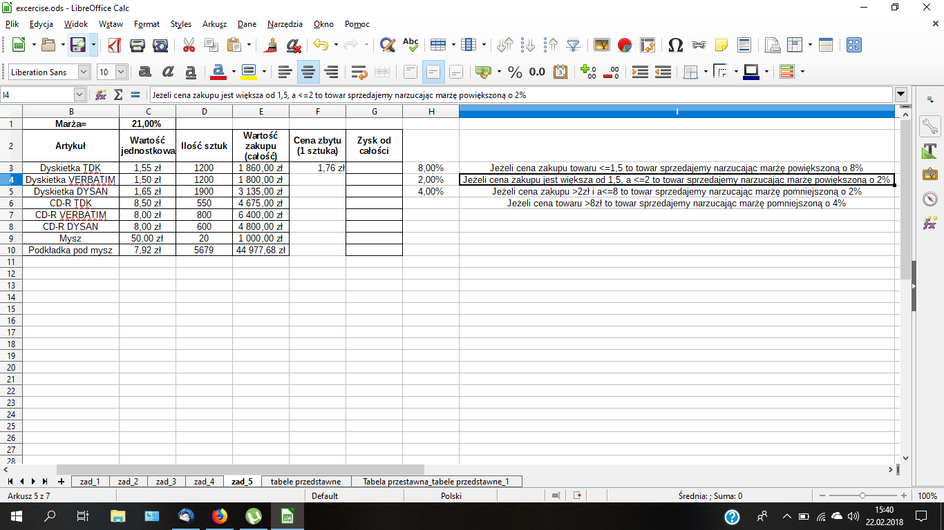

    I need help entering a few conditions using the IF function. I have one condition, but how to add additional conditions ...
    In the attachment I add a file in LibreOffice Excel. This is very important to me, please help.

    You are giving a nested function. If the first condition of the function, if it is met, inserts the value if not then it goes to the next one etc.
    = If (a = b; PrawdaB, if (a = c; PrawdaC; .......

    Prot
    Posts: 2580
    Help: 574
    Rate: 297
    Paste the formula into cell F3 and drag on the column: [syntax=vbscript]=JEŻELI(C31,5;C32;C3
