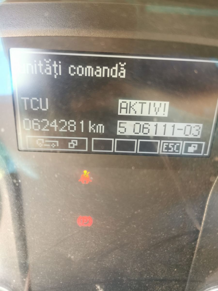

    simona_urda
    Close-up of the TCU error screen in a Man Tgx Euro 6. Man Tgx euro 6
    Errors TCU 06111-03 at Man Tgx euro 6
    the first time it appeared, it didn't go into R, then I took the terminals from the batteries and it worked, and after a few km, after a short break, it didn't go into D anymore, but now it goes into R
    there is definitely a problem on the electrical part of the gearbox, it writ Scania on the gearbox

    #2 20715725
    ROKADI
    Level 22  
    Posts: 388
    Help: 43
    Rate: 194
    SPN 6111 CAN data bus message from electric clutch adjuster -
    Clutch wear information
    Monitoring strategy
    Clutch wear monitoring
    Customer reception/description of symptoms
    Central warning light illuminates continuously yellow while driving and while vehicle is stationary
    Failure Mode Identification (FMI)
    FMI 3 Unreliable
    Display indication
    Priority 5 Text
    indication
    Control device conditions
    Setup conditions
    CAN data bus message from the electric clutch adjuster control device
    unreliable
    Reset conditions
    CAN data bus message from the electric clutch adjuster control device is
    received and contains reliable information
    Symptoms
    System response/possible consequences
    The transmission control device sends the clutch wear value "Error" via the bus. CAN data bus
    Substitute reaction
    As internal clutch wear value is set to "Error"
    Cause
    Possible causes
    ► Transmission control device receives a CAN data bus message with unreliable wear information
    clutch wear
    ► Clutch calibration is incorrect
    ► Clutch inoperative (uneven wear / burnout)
    SPN_6111_CAN-.Datenbusbotschaft vom elektrischen Kupplungssteller -
    Informationen Kupplungsverschleiß_GTR-SGC-Scania : 2018-02-01 : 2/2
    Inspections
    Possible inspection steps
    Visual inspections
    ► Perform a visual inspection of the electric clutch adjuster
    ► Perform a visual inspection of the mechanical components of the clutch (clutch engagement disc,
    coupling release forks, clutch release bearing) by opening the maintenance cover
    ► Check the clutch carrier disc thickness in the "Powertrain systems
    > Transmission > Monitoring > Clutch" menu of the MAN-cats system
    ► Check the clutch carrier disc thickness with a special tool
    Clutch carrier disc thickness Setpoint: Maximum difference
    Value in mm 0.5
    Measure
    Possible remedy
    ► Replace the clutch if necessary, Replace the clutch fluid using the "Procedures >
    Clutch setting" menu of the MAN-.cats and calibrate the new clutch using the menu "Actions after
    replacement of components > Installed new clutch / Installed used clutch" of the MANcats system
    ► If the maximum difference is exceeded, calibrate the clutch using the menu "Actions after
    Note
    Additional information/advice
    ► The electric clutch adjuster consists of an electric motor connected to a hydraulic module
    containing a transmitter cylinder and a receiver cylinder
