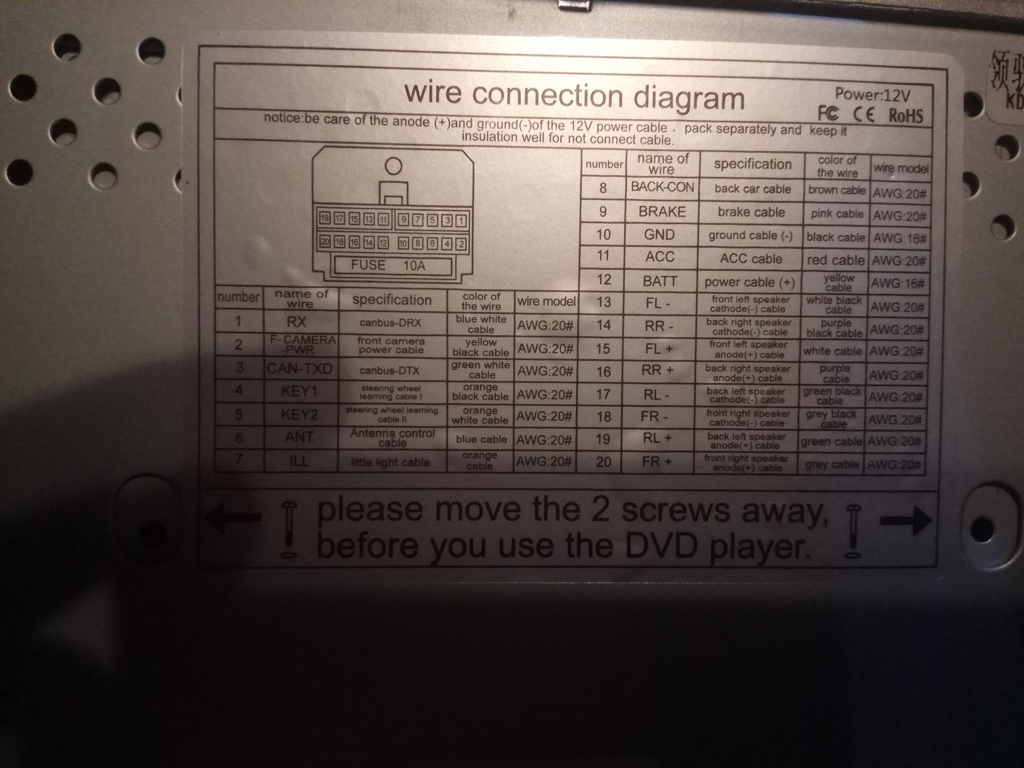

    I bought a radio from china dedicated to vw. The problem appeared after connecting. The radio plays well on one side. After removing the key from the ignition, it does not turn off and the car cannot be locked with the central lock. Error when connecting?
    The description of the numbers in the picture is what I figured out
    1 current after turning the key
    2 ----
    3 continuous current
    4 continuous current

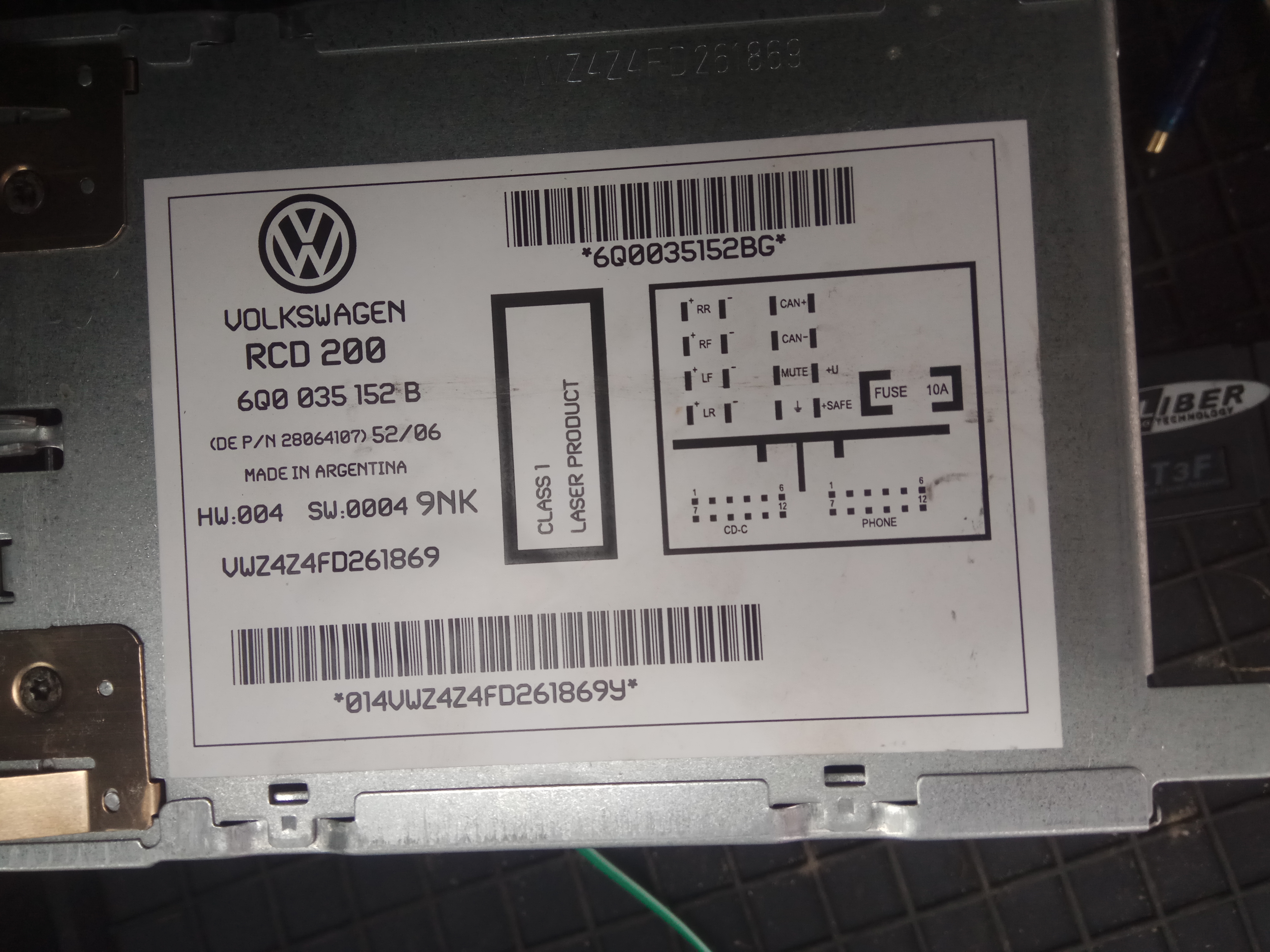

    The first photo is a description of the old radio

    Bad connection. See the drawing from the original radio and the one from China? The same outputs of supply voltages and CAN +/- and speakers?

    In the attached photo of the cubes, the part on the right is probably some orange color under the speakers. And black from the rest.

    You have iso2 can in the car and you bought the radio for analog installation.
  • #5 17108099
    Wojtek9745
    Board Language: polish
    Yes, but there is a signal changing module (can-bus decoder)

    The orange one is described on the instructions for the wires of this radio that it is the ILL No. 7 lighting. And there comes 12V either after the ignition switch or only after turning on the lights somehow.
