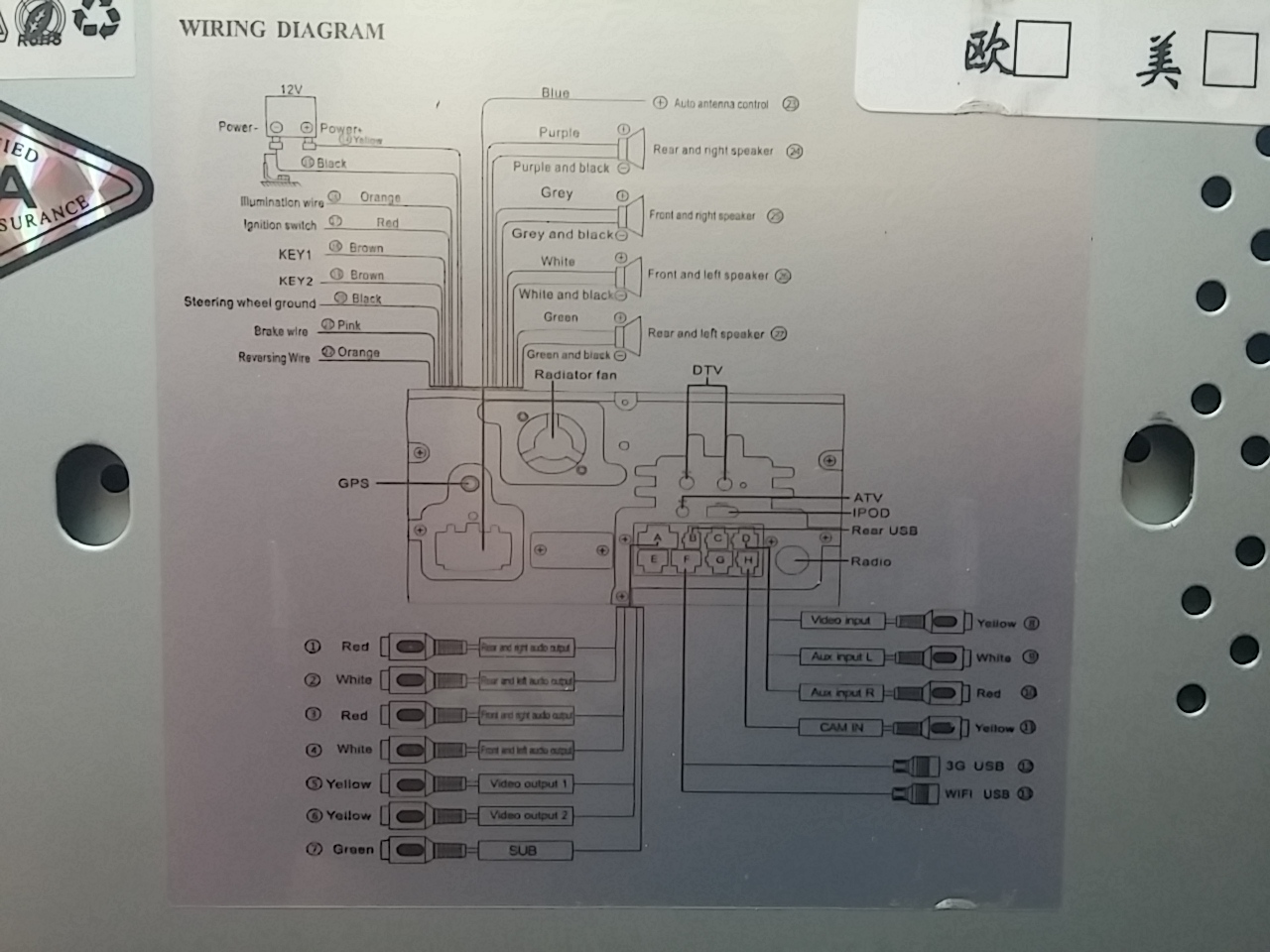

    Hello, I have a problem with the connection, please for a diagram, pictures of the radio and cube diagram from VW Golf 4, please answer quickly.

    How should I connect it, just connect the yellow plus, and the black mass and everything?

    Well, that's the scheme. The rest are additional functions.

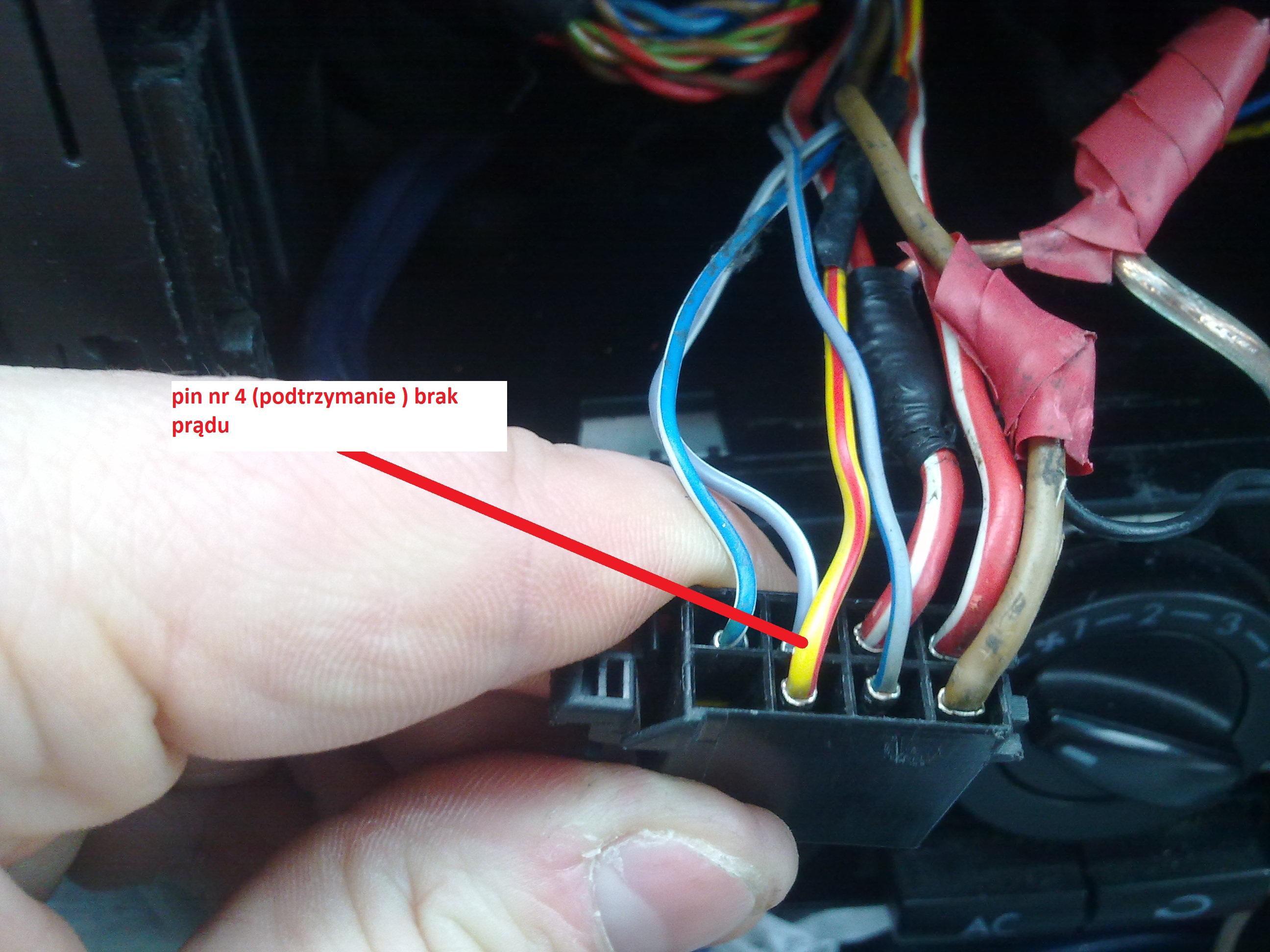

    I connect yes and the radio does not work.

    Yellow plus solid, red plus with ignition (or permanent if the radio has to play without a key) black mass.

    Neither does it, it does not work, and the radio bought new, do you need a can bus controler?

    The radio should work after connecting, just like a colleague wrote above. Although it should be included.

    Insert at least the ignition keys and turn the key.

    the key has been turned off, everything is connected as you write and the radio still does not work unless it's damaged

    Please, disconnect the mass from the power supply circuits. Yes for half a minute. Then connect to the circuit and start the engine. The next step is to turn on the radio panel ... Did it work?

    Later check to send a picture of the cube coming out of the radio
