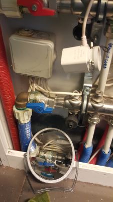

    #10 20265200
    takitamelektron
    mirrzo wrote:
    Or maybe the water is escaping through the safety valve.
    Thank you for all your comments because I have a similar problem as mlpmlp11 in the central heating installation [underfloor heating] and the Vitodens gas boiler.
    Water pressure drops of about 0.1 / 0.2 bar per day on the boiler pressure gauge.
    It turned out as above.
    Boiler about 10 years.
    After removing the housing, the leak from the safety valve is clearly visible:
    Underfloor Heating Pressure Drop: Urlich Oil Oven, Expansion Tank, Thermostatic Mixing Valve
    Greetings
  • #11 20265261
    piracik
    Posts: 4060
    Help: 557
    Rate: 1977
    This in the picture is a vent.
  • #12 20265795
    takitamelektron
    A vent, indeed.
    Nevertheless, thanks to this thread, it was possible to direct the search for a leak towards the furnace and not the central heating installation.
    Thanks again.
