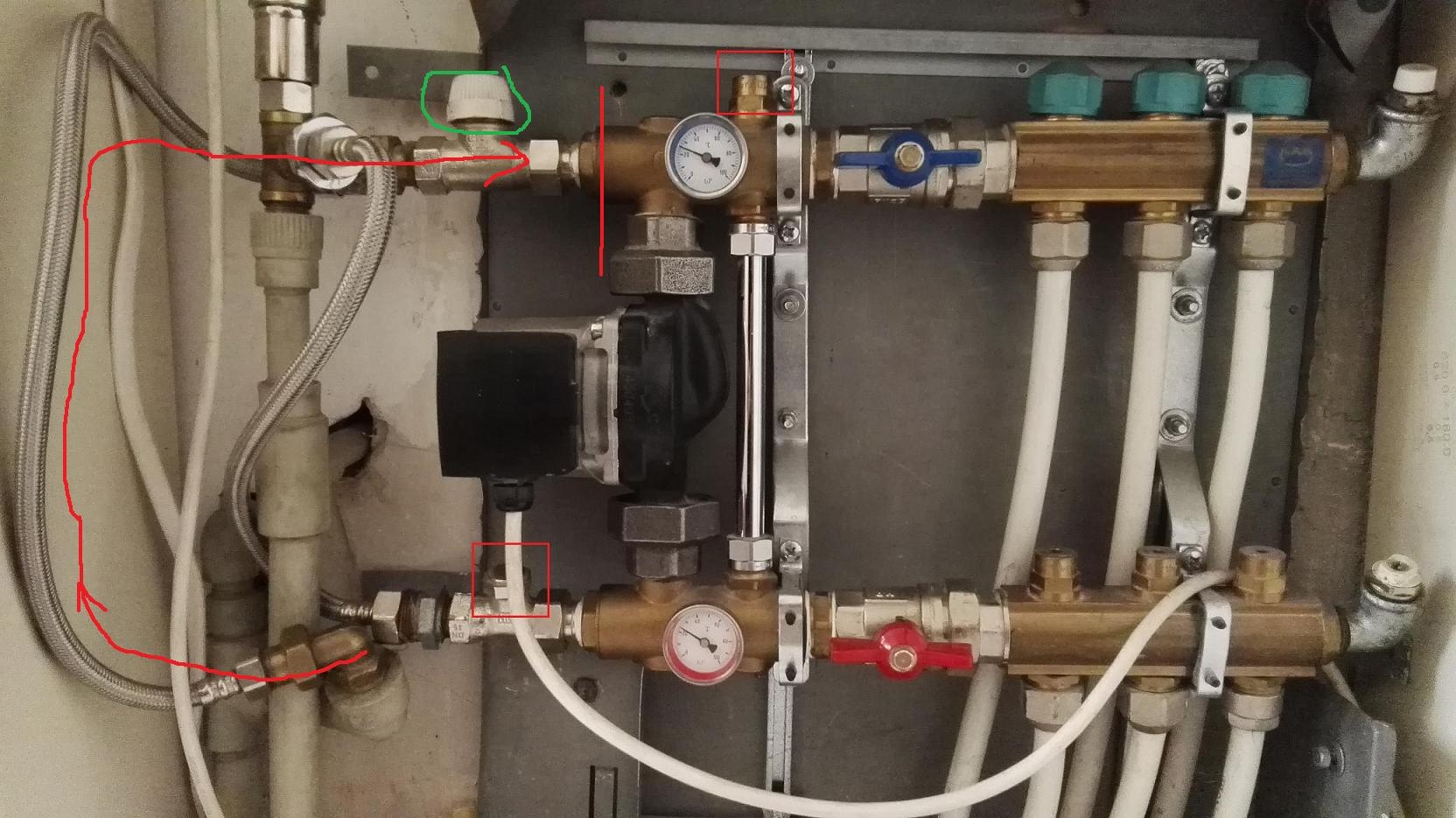

    I am renting a flat with underfloor heating and it will be my first winter so I would like it to be all as due.
    I put a bake on the test to check that everything works and I have the impression that the flooring can not do it. The flat is 40m2, so it is not a large heating surface, and as for my eye after about 10 hours should already feel a slight warmth.
    I am completely green in the subject. I called the owner and told me that the previous tenants were mixing something at the installation and will not tell me what to do today.
    The installation is from what I noticed 2 valves at which you can turn something (I marked on the pictures
    Underfloor Heating in 40m2 Flat: Setting & Troubleshooting Tips (Valves, Models, Brands) ).
    Do you need to set them properly to heat up as due?
    I will add the bake today is from 8:00
    I will be very grateful for the hints

    What kind of serpents was there? The feed pipe from the boiler to the distributor is what? I can see that someone has become alienated by pions. There is the floor mixer itself because the pipes are still going somewhere in the wall. What boiler - gas? No thermostat with capillary on the valve.

    It's not about the colors of the valves. The floor heating power supply is to be at the bottom but the distributor does not supply anymore. Should go to the top beam. That's why I asked for the boiler feed.
    Beretta dual-purpose boiler.
    When it comes to power, after hot water, the water has direction as the arrows are flying.The vertical line is the hot water cut, i.e. it is possible that the valve was said to be used by the arbiter The referee needs to be unscrewed.

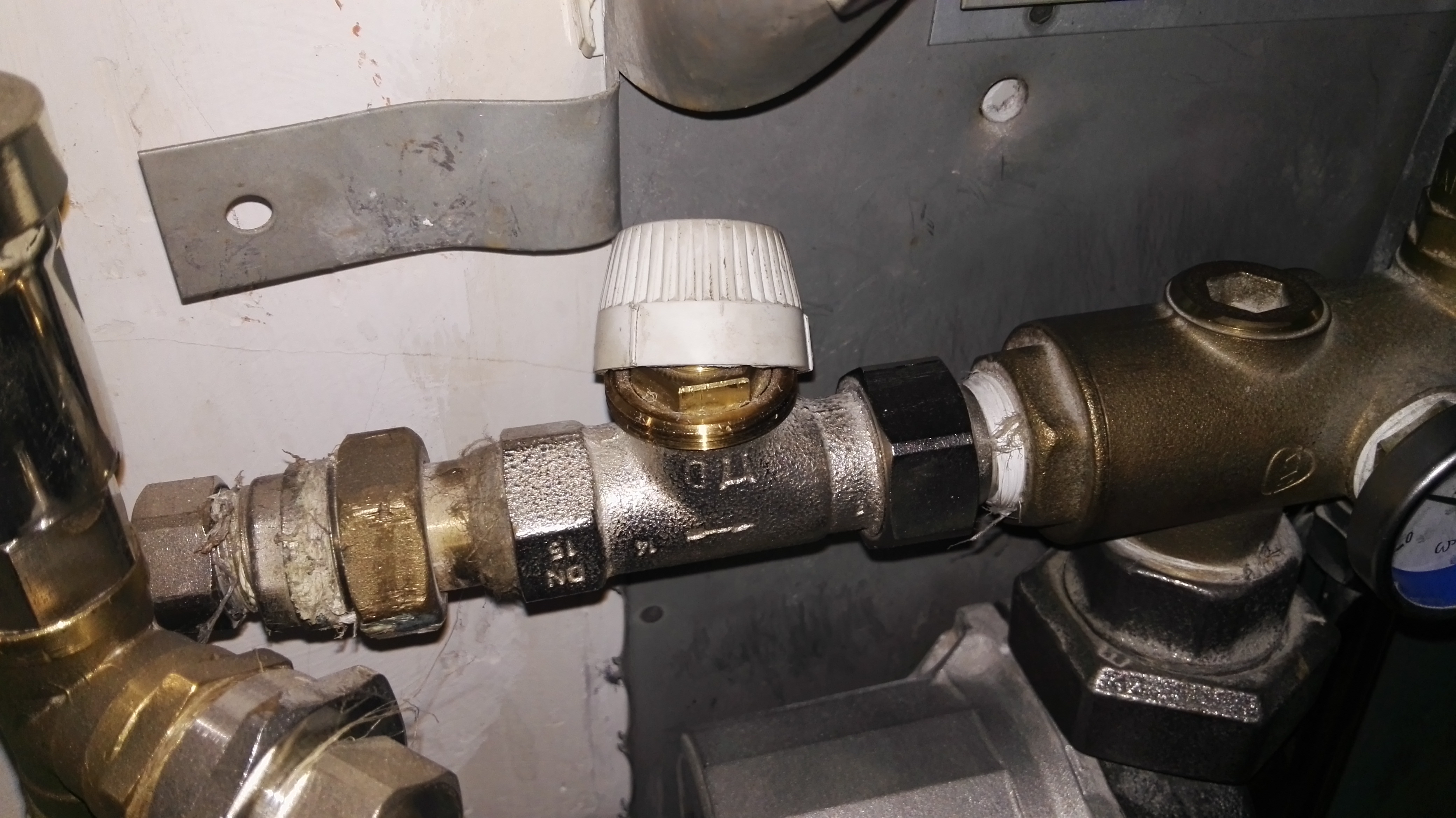

    Arbiter wrote:
    this valve with a white plastic mushroom on the left. Maybe something will move
    when it comes to this valve, white plasters are cracked and nothing can be done with it.

    If it's like you drew it, you should still have a thermostat. Do it this way. gently open the plastic knob and regulate the flow with the bypass valve (the one that you marked on the top bar) Remember that the temperature on the bottom bar is not higher than 40 ° C. If there are no radiators (you have not written) and the boiler is condensing, you do not need this type of lowering heating water temperature.
    At this point, you should have such a thermostat:
    https://obrazki.elektroda.pl/5222776900_1395689194.jpg
    See if there is any air on these manual vents.

    domel, if the plastic is cracked it does not matter - because by default, the valve is opened by unscrewing it. However, something may have been suspended, but you should try to squeeze this pip. Under normal conditions, this pip is controlled by a thermostat, or plastic is pressed in). If the button is knocked up, the valve is open to the max. Maybe I can not come back
    The valve which at the bottom you have marked with a square is probably blinded with a nut and after unscrewing it you get to the gusset. but I do not think anyone turned it down

    This is a valve. The thermostat is to be screwed into it instead of the cap.
    Added after 45 [seconds]:
    I showed in the picture.

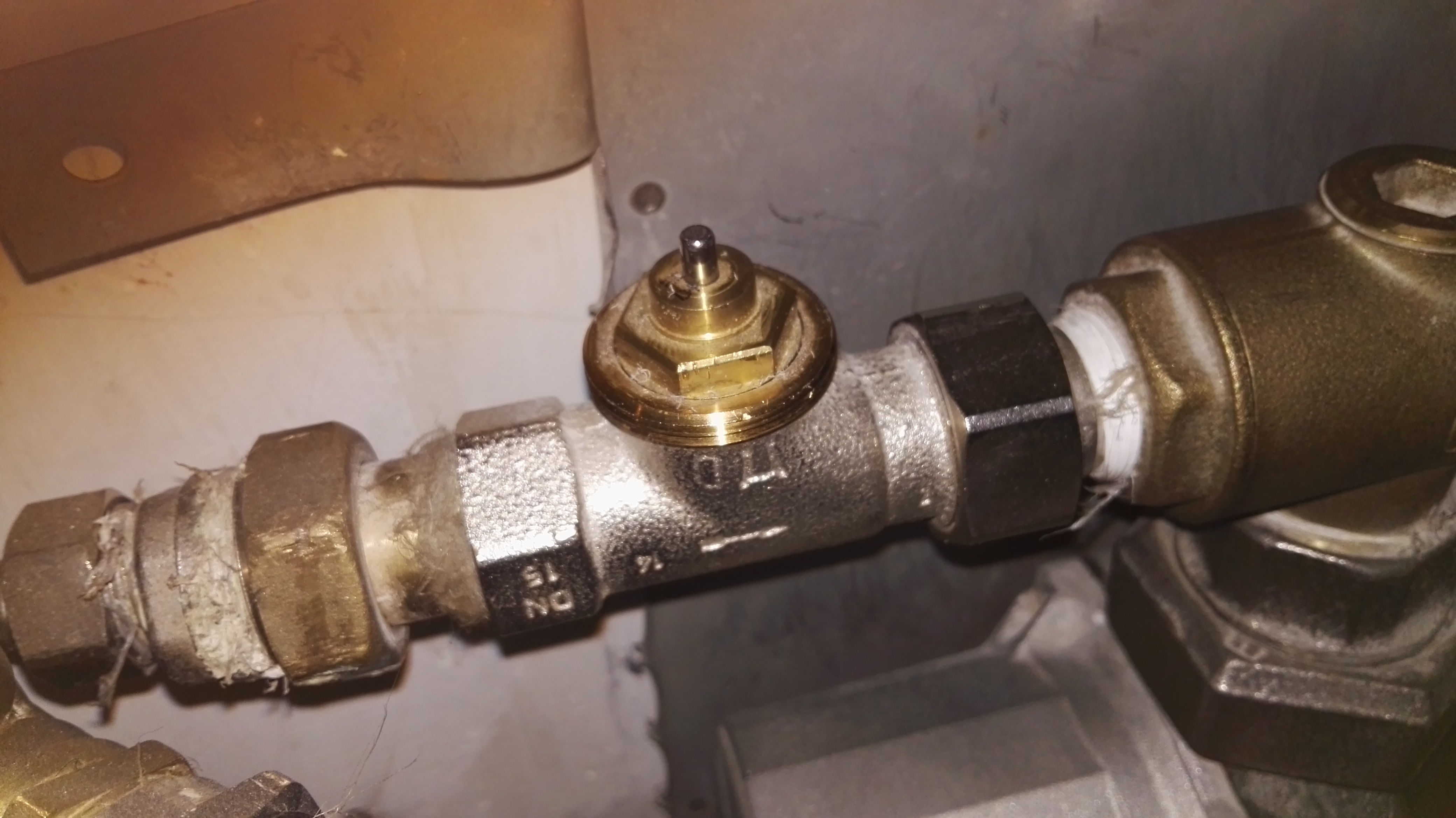

    there is no thermostat. The cap is cracked so the valve comes out of it being open to the max and the hot water stops at the place where I marked the yellow thick line in the picture.

    That this mushroom valve is warm at all?
    Did you check whether the pump is working and is it bled? (unscrew the cap on the left side of the pump from the forehead and check that water flows out and the rotor is spinning.
    Unscrew the breathers on the knees on the right side of the beams.
    Move the stem from the thermostatic valve violently up and down - perhaps the mushroom has stuck together when the cap has been screwed for a long time.
    In addition, these snakes have too small cross-sections for such purposes. Necessarily to be replaced with larger diameters.

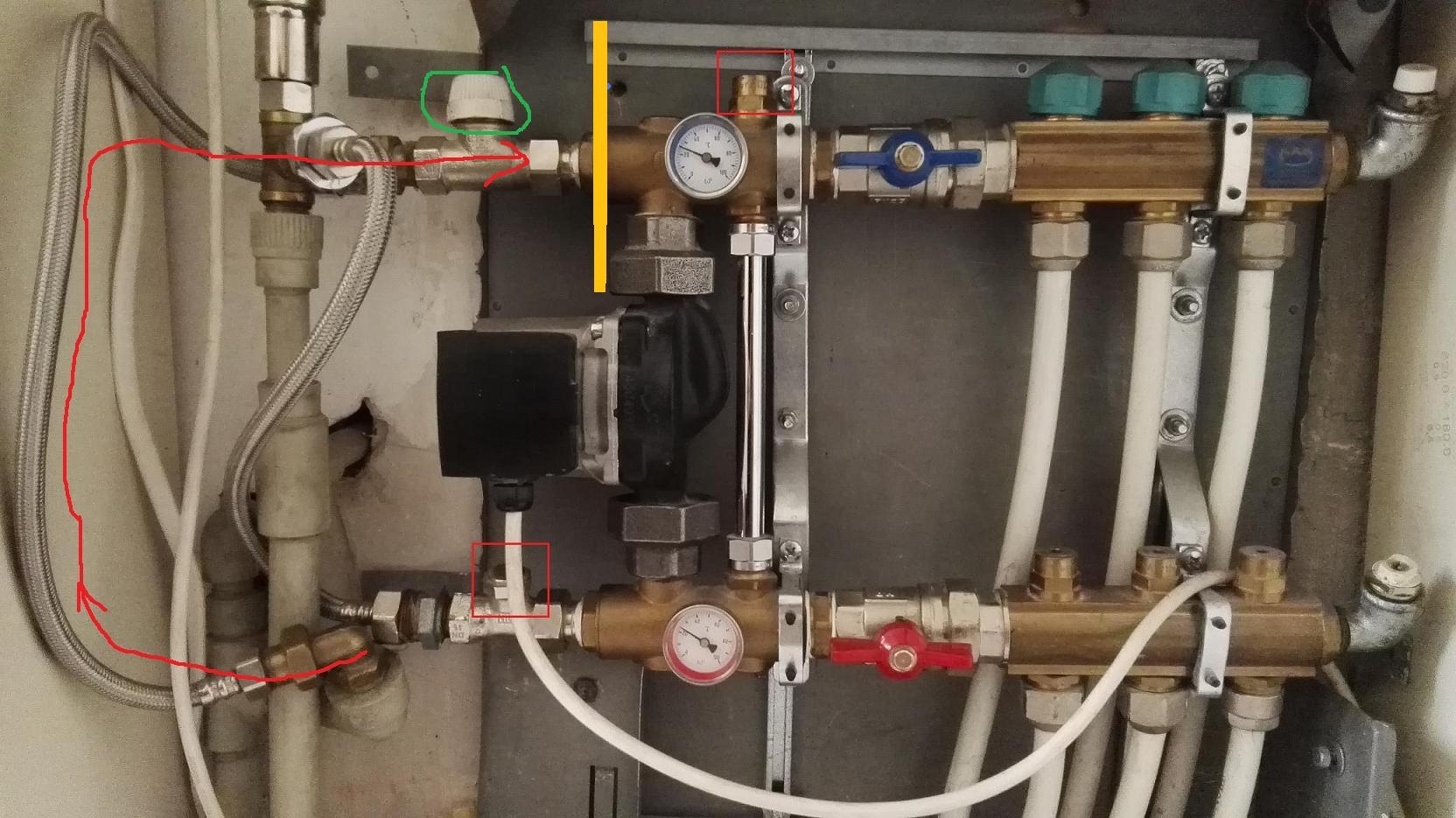

    it's so warm. I indicated the yellow line where heat water ends (that is before the pump).
    everything works, even today I unscrewed this valve and checked if something is not there - everything is ok

    RTL valve is mounted on the output not on the input - there is no such valve in the presented system.
    The layout of colleague domel.spi is quite strange, there is a restriction valve on the input, the pump mixes the liquid in the system and the other valve is on the output.
    To start the system quickly at full power, you must open both valves and turn off the mixing pump. if the general circulation is forced then it will start to heat. Provided that the inlet and outlet valves are unobstructed. Unfortunately, as in nature, everything uses the principle of "the least resistance line" - it may turn out that the flow will be through the pump because there is the smallest flow resistance. Unfortunately, the "installer" did not insert the check valve into the pump circulation.
    I am not an installer, but I would not come up with a solution like in the picture.
    Even this system has a chance to work properly - the condition of replacing the valve installed on the return to the RTL valve, which will introduce a simple temperature regulation, and the mixing pump will set the flow evenly.
