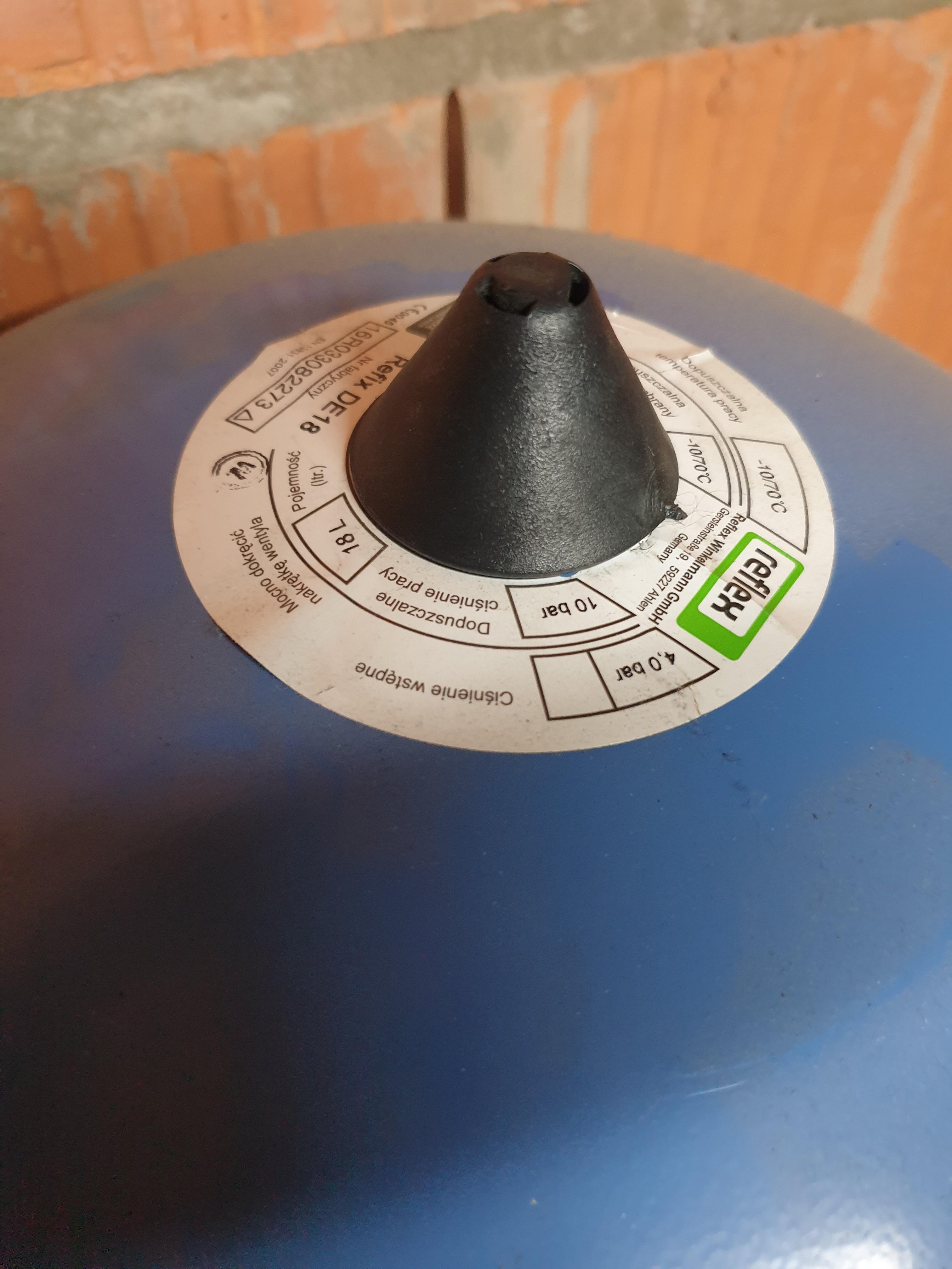

    As for the amount of water, I'm probably exaggerating about 2-3 liters because I run the tap for 1-3 seconds and I have 2 bars ...
    Water only leaked from this vent.
    How are these systems vented?
    As for replacing the breather, it's probably something to do...
    As for the diaphragm vessel, it is full of air because I checked if the vents were tight.

    If the pressure is zero and grows very quickly during tapping, the diaphragm vessel is damaged or it should be supplied with air.
  • #6 18967740
    xoree
    Level 30  
    Posts: 1558
    Help: 129
    Rate: 174
    There is air in this vessel I checked ... (I tried to pump it up but unfortunately I couldn't because the shading is too big ;) )

    Air doesn't mean anything. There may not be enough. The correct measurement should be made with zero water pressure or on a disassembled vessel, because the water pressure introduces measurement error.

    There is a sticker on the vessel with a description of the pressure that should be in the vessel. The rest I described in the previous post.

    So that's how I checked the number of bars in the 3.9 Bar vessel.
    I filled the system with water and it is 1.8 bar (the pressure holds).
    If there was a leak, I think it would be gone by now...?

    I checked the pressure in the vessel when the water in the system was not yet filled ...
    but this is a Refix DE 18 vessel for utility water, i.e. hot water if you have a hot water tank
    For the heating circuit there is a separate vessel, usually with a capacity of 6-10 l, it is built into the boiler.
    If someone has a large-capacity installation, an additional vessel is used somewhere outside the boiler, and then you have to watch the pressure in the built-in and additional vessel, or the built-in vessel is disconnected and one with the required capacity for a given installation is used.
    The vessel for the circulation which has, as I wrote, e.g. 0.75 bar, not 3.9 bar.
    This is how a layman deals with things about which he has absolutely no clue.

    You know, I understand you very well ... I try to help repair the motherboard in a laptop myself sometimes, but sometimes it's unrealistic and now I know why.
    Understatement barak knowledge etc ... no one told me that this vessel is in the cauldron ...
    BTW...
    How to check this vessel in the boiler?? ;)

    You need to determine where you have this vessel.
    It's best to download the installation manual for your boiler, then you will have a diagram.
    In my boiler, the vessel is on the back wall, i.e. from the side of the load-bearing wall on which the boiler is suspended.
    It can have a round or rectangular shape, I had a factory-made 10-litre cherry/red rectangular vessel.
    Currently, I have an 8l replacement vessel, round, gray in color, which hangs on the wall next to the boiler and is connected with a flexible steel hose to the place where the original vessel was connected.
    In my boiler, access to the original vessel was without removing the casing, but the valve is at the very top of the boiler, next to the flue pipe and so close to the wall that not every manometer was physically able to measure the pressure.
    I don't know about your boiler.
    Determine the location of your vessel and where it has a valve for making up air. Then you need to repeat the operation by draining the water from the boiler and check the air pressure in the vessel with the open drain valve for draining the water from the boiler. For the vessel what I take 0.75 bar as a minimum and 1.0 bar as a maximum for the initial air pressure.

  • #27 19016006
    xoree
    Level 30  
    Posts: 1558
    Help: 129
    Rate: 174
    The problem was on the side of the dish in the oven after draining the water and finishing the air the subject returned to normal.
  • #28 19016010
    xoree
    Level 30  
    Posts: 1558
    Help: 129
    Rate: 174
    Added after 41 [seconds]:
    Thank you all for your help
