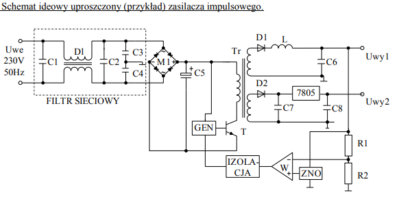

    Hello, could someone briefly explain the operation of this diagram? What is each component responsible for? Thank you in advance. Diagram attached.

    1. A network filter usually consists of coils and capacitors, the very purpose of such filters (another name for EMI) is to eliminate (minimize) interference emitted to the network. In short, so that your TV does not "snow" at home when you connect such a power supply to the socket.
    2. Bridge rectifier: https://pl.wikipedia.org/wiki/Mostek_Graetza
    3. Capacitor C5 smoothes out the ripple caused by the bridge.
    4. Tr is a transformer. But not the usual one used in typical power supplies, but a special one adapted to higher frequencies. Higher frequencies come from switching the transistor through the generator. The switching frequency may be, for example, several hundred kHz. (these are pulses, hence the name impulse)
    5. Read about error amplifiers (a triangle with the letter W inside, plus and minus).
    6. Isolation: read about optocouplers. By using such elements, you isolate one voltage from another. e.g. 230V from 12V.
    7. Resistors R1 and R2 are voltage dividers.
    I disagree with the first one. EMI is an abbreviation for electromagnetic interference, not a filter name. At most it can be an EMI filter, but that means a filter against EMI interference. Element D1 is the so-called common mode choke, i.e. a filter against common-mode interference.
    Generally, this is not the time for such interference to cause snow on the TV, but it may cause other devices around it to work incorrectly, just like snow on TV receivers in the past.
