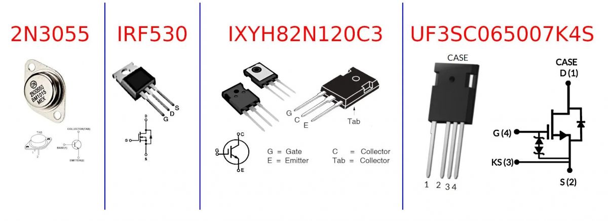

    For our tests and simulations, we have chosen some very powerful and robust electronic components (see Figure 1), real workhorses used massively in power projects and which are still widely used today. The following list also describes the most important characteristics:
    • Transistor BJT 2N3055: VCE: 100 V, IC: 7 A, P: 115 W, Tj: 200°C, beta: 70
    • MOSFET Si IRF530: VDS: 100 V, Rds(on): 0.18 Ω, Id: 14 A, P: 75 W, Tj: 150°C
    • IGBT IXYH82N120C3: VCE: 1200 V, VGE: 20 V, IC: 200 A, P: 1250 W, Tj: 175°C
    • SiC MOSFET UF3SC065007K4S: VDS: 650 V, Rds(on): 0.009 Ω, VGS: 20 V, Id: 120 A, P: 789 W, Tj: 175°C
    The image shows four different transistors: 2N3055, IRF530, IXYH82N120C3, UF3SC065007K4S with their diagrams.
    Figure 1: Electronic devices used for the efficiency test

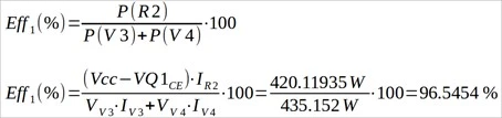

    Let’s examine the wiring diagram, which practically consists of four different sections. The first section uses a silicon power transistor. The base must be suitably polarized to be able to make a current equal to that of the base multiplied by the amplification factor (beta) flow on the collector. The base, therefore, is driven in current. The second section includes a silicon MOSFET, and to bring it into conduction, an adequate VGS voltage is required. The third section involves the use of an IGBT, while the fourth section uses a SiC MOSFET. To determine the real efficiency, the powers generated by all energy generators must also be included in the formulas. The four formulas, therefore, are the following. For the transistor stage:
    Mathematical formula for calculating circuit efficiency with example data.

    The efficiencies of the four circuits are as follows:
    • Transistor: 96.54%
    • Si MOSFET: 99.51%
    • IGBT: 98.68%
    • SiC MOSFET: 99.93%
