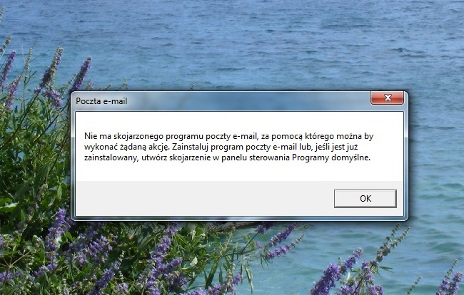

    Hey,
    I have a problem with me in the company
    First, the problem occurred on the Thunderbird, we switched to Outlok and ...
    After changing the mail program from Thunderbird to Outlook, most people still can not send files from the new e-mail program using the Send to-> e-mail addresser function.
    The default program in Windows is Outlook: /
    do you have any ideas or is it a bad mail configuration on all your computers or something with a server?

    An attempt to send a file in Win7 failed. such a message appeared. I did it according to the instructions, without success. Outlook and thunderbird - unable to send Send to-> mail recipient.

    Set in: Control Panel \ Programs \ Default Programs \ Set Default Programs.
    How does it work, which version of Outlook?

    Yes I did / as I wrote above. I did it according to the instructions, without success.

    If it does not work, what version of Outlook do you have?
    If you have a problem with setting Outlook, e.g. 2010, as the default client for sending a file,
    via the right click -> send to -> mail recipient.
    1). Go to the C: \ documents and settings \ Username folder \ sendto,
    or c: \ Users \ Username \ AppData \ Roaming \ Microsoft \ Windows \ SendTo \
    2). Right click in empty space -> new -> shortcut
    3). Location of the element:
    "C: \ Program Files \ Microsoft Office \ Office14 \ OUTLOOK.EXE" / a (quotes are significant)
    4). The abbreviation can be called "send to outlook", or you can delete the abbreviation "mail recipient" and call this new abbreviation.

    thanks to all for help, nwm which but it helped
