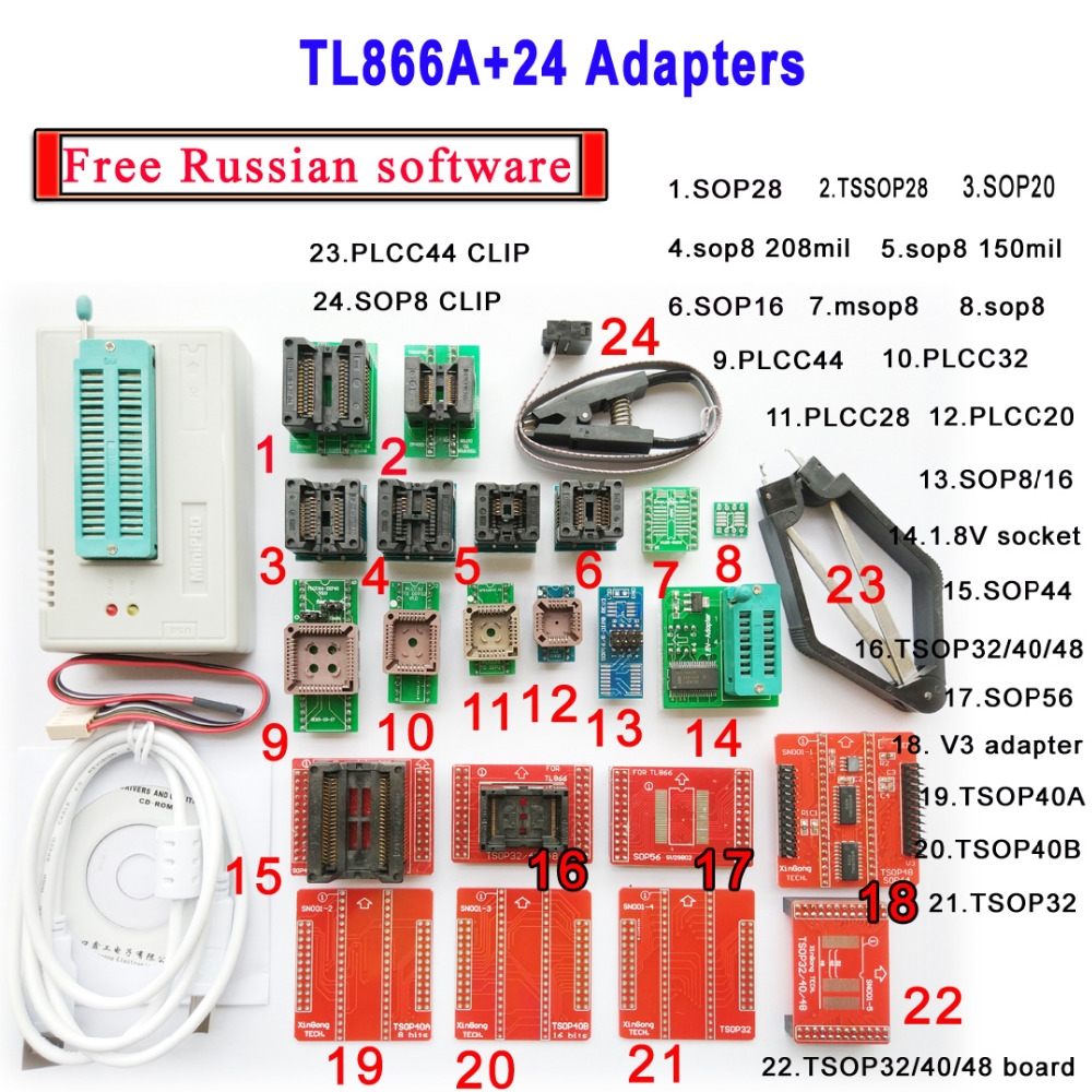

    I am asking because I would like to buy. It's a bit late to buy a NAND programmer, but maybe it's still worth the investment. I am looking for confirmation that Proman is also good at K9GAG08U0E.
    On Ali I found:
    NAND ProMan Professional Programmer TL866 PLUS Programmer
    Note: After we verify, this programmer not support chip K9GAG08U0E,
    description of supporting it on aliexpress are wrong.

    I have a different programmer, but there is a problem with K9GAG08U0E. That's why I'm looking for some NAND programmer. In the TL866 memory support list, K9GAG08U0E is among many others.
    All in all, are you sure the TL866 will not program K9GAG08UE correctly?

    lisek wrote:
    when you buy TL866 plus (TL866A +), you will forget about the problem (necks)
