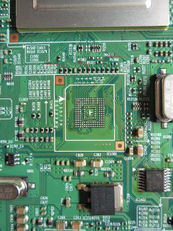

    Brand: Samsung
    Model: UE40D6000
    Chassis (motherboard or main components): BN41-01604C
    Matrix / Panel (if present): LTJ400HV06-C
    Other (Notes): OneNAND KFG1GN6W2D
    NAND SDIN5D2-2G.
    As in the topic you need a dump EMMC NAND SDIN5D2-2G OneNAND KFG1GN6W2D BN41-01604C you need a dump ...
    I will gladly buy.
    Thank you in advance and best regards
    Danao.

    firmware BN41-01604C /: Genoa_S_3D_EU
    Main with SDP1001, SDP94, SiI9489ACTUC, WT61P805, 24C512,
    - IC1302 KFG1GN6W2D KFG1GN6W2D,
    - IC1301 SDIN5D2-2G,
    K4B1G16646G-BCH9, RTL8201E, TAS5725
    SDIN5D2-2G EMMC stitched for BN41-01604C apply in Samsung UE32d6100, UE40D6100, UE46D6100
    - change when fault turns off after 30 seconds.
    The presence of firmware, firmware BN41-01604C
    - version v1007.1, v1008.0, v1009.1, v1010.3, v1011.5, v1012.1, v1013.0, v1013.1, v1014.0, v1016 is a.0, v1017.1, v1023. 0, v1026.0, v1027.0, v1028.0
    Chip SDIN5G2-2G is not very efficient when soldering ....., the overheating is often out of order, the replacement of analogue they KLM2G1HE3F-B001, KLM4G1HE3F-B001 or a ny other emmc version 4.41
    Of course, the WT61P805 and its 3.3V stabilizer are working ?!
    As it does not enter the Service Menu for Exchange: OneNAND + eMMC

    Na tej płycie o pcb:BN41-01604C
    During fault restart, and shuts down after 30 seconds, fail chip BGA EMMC ( moviNAND ) SDIN5D2-2G, oneNAND KFG1GN6W2D processor SDP1001.
    .... If the fault does not turn on and the indicator marks 2 short means a short 3.3 volts, a common cause is the failure of the processor HDMI SIL9489.
    If damage does not turn on and the indicator no flash > fail weltrend IC1203 WT61P805.
    * new chip and SMD 3.3 volt - IC204 MCP1700 3.3 V 0.25 A SOT23-3.
    Zależnie od "bogactwa i kraju przeznaczenia " TV Samsung UE32D6100, UE46D6100, UE40D6100... potem ta płyta przyjmuje kolejne nr.
    BN94-05368B, BN94-05367X , BN94-05370F, BN94-04726X, BN94-05367P, BN94-05118C, BN94-05118K, BN94-05118N, BN94-04626U, BN94-04726K (UE46D6100SWXx) , BN94-04973D (UE46D6100SWXXC), BN94-05370H, BN94-05370G (UE37D6100SW)
    Podaj pełną nazwę modelu (np UE40D6000TW )lub opis BN94- ?
    jaki miałes objaw uszkodzenia?
    :idea: :idea:
    Firmware version BN41-01604C , you need to look not at the label , and in service mode.
    TV during operation could not just update the firmware after the factory.
    :!: Enter the service: in the standby mode, dial Info - Menu - Mute - Power with the remote control.
    The firmware version will be written in the top line.

    UE40D6000TWXXH version: 05.
    A symptom that turns on fully and runs normally for 30 seconds. After this time, it works but stops responding to the remote control. After another 15 seconds, it restarts. A red dot indicates that the remote is being sent, but tv does not execute the commands.
    The kfg1gn6w2d with DUEC 1014.0 is definitely damaged because I can't read it completely. Stops in one place:
    024: VCCIO: 3.3V
    025: eMMC OCR: 80FF8080
    026: eMMC CID: 45010053454D303247900447B95BAE
    027: eMMC CSD: D00F00320F5A03A5FFFFFCFF924040
    028: Chip ID: 00010045, Chip Name: SEM02G
    029: Chip Size: User = 1868MB, Boot1 = Boot2 = 1024KB, RPMB = 128KB.
    030: C: \ Users \ Danao \ Desktop \ EMMCcrash bn41 01604c 1031 b 1014.10 restart 1014 \ EMMCcrash bn41 01604c 1031 b 1014.10 restart 1014
    031: Start reading chip ......
    032: .EXT_CSDRead successful, file saved.
    033: .BOOT1Read successful, file saved.
    034: .BOOT2Read successful, file saved.
    035:. Start to read the user area data and save, large capacity, please be patient ... ...
    036: Read timeout.
    037: Read timeout.
    038: Read timeout.
    039: Read timeout.
    040: CRC error @ 0: 0xD62E - 0x35F8
    041: Error code: 1
    042: Read error, operation aborted.
    However, I have the second MAIN the same. The symptom on it is that the tv only turns on with the backlight. and also restarts after 30 seconds. I do not know if there is a logo and, apart from the flashing of the diode, I do not know what the reaction to the pilot's orders is. However, I read eMMC fully from DEUC 1017.1.
    Sometimes RT809H crashes when VCCQ is 3.3V, change to 1.8V.
    You can read the sectors one by one.
    I have a BN41-01604C board fully working, you can figure it out, I just need a pinout.

    But he reads the second disc and writes it to the end in this configuration
    I re-uploaded what I read after the previous deletion and it did not change anything. Behavior as before. TV will turn on, only lights up and restart after a few seconds. Over and over again.
    Thanks and I will try only with this 1.8V VCCQ.

    If you are one of the "unfortunate" ones who had a breakdown (those 30s)
    estimates say (about 80% of records), count economically how much it will be:
    1.Purchase and replacement of damaged ones: BGA EMMC chip (moviNAND) SDIN5D2-2G, and BGA processor SDP1001.
    * because they usually fall on this pcb
    the price of SDP1001 from China is around $ 15-17
    price 2 pcs. X SDIN5D2-2G (excluding shipping from ebay.uk) is around ? 25

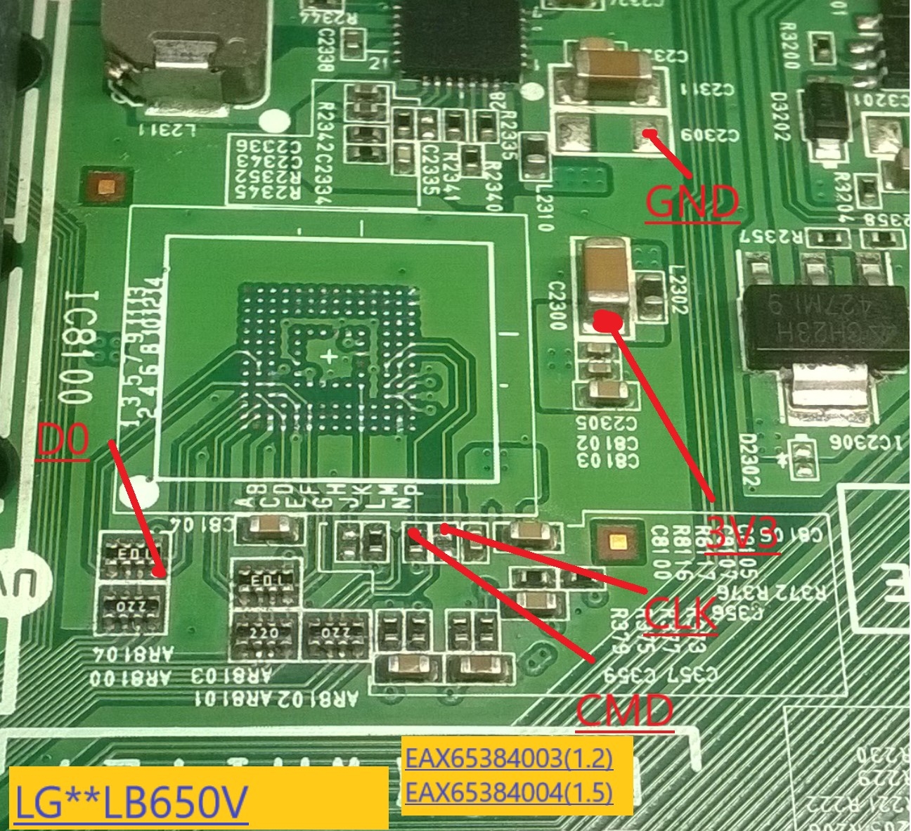

    As we already send you, read from the specialists Link
    - use in the search the phrase: BN41-01604C
    e.g. eMMC breaks out from the model described in the photo (LG_ LB650V EMMC Points)
    Seeking EMMC NAND SDIN5D2-2G OneNAND KFG1GN6W2D BN41-01604C Dump for Samsung UE40D6000 TV
    LG_47LN5700, LA33, LB33B, LJ33
    apparently from bn41-01604cc , incomplete connection of pins

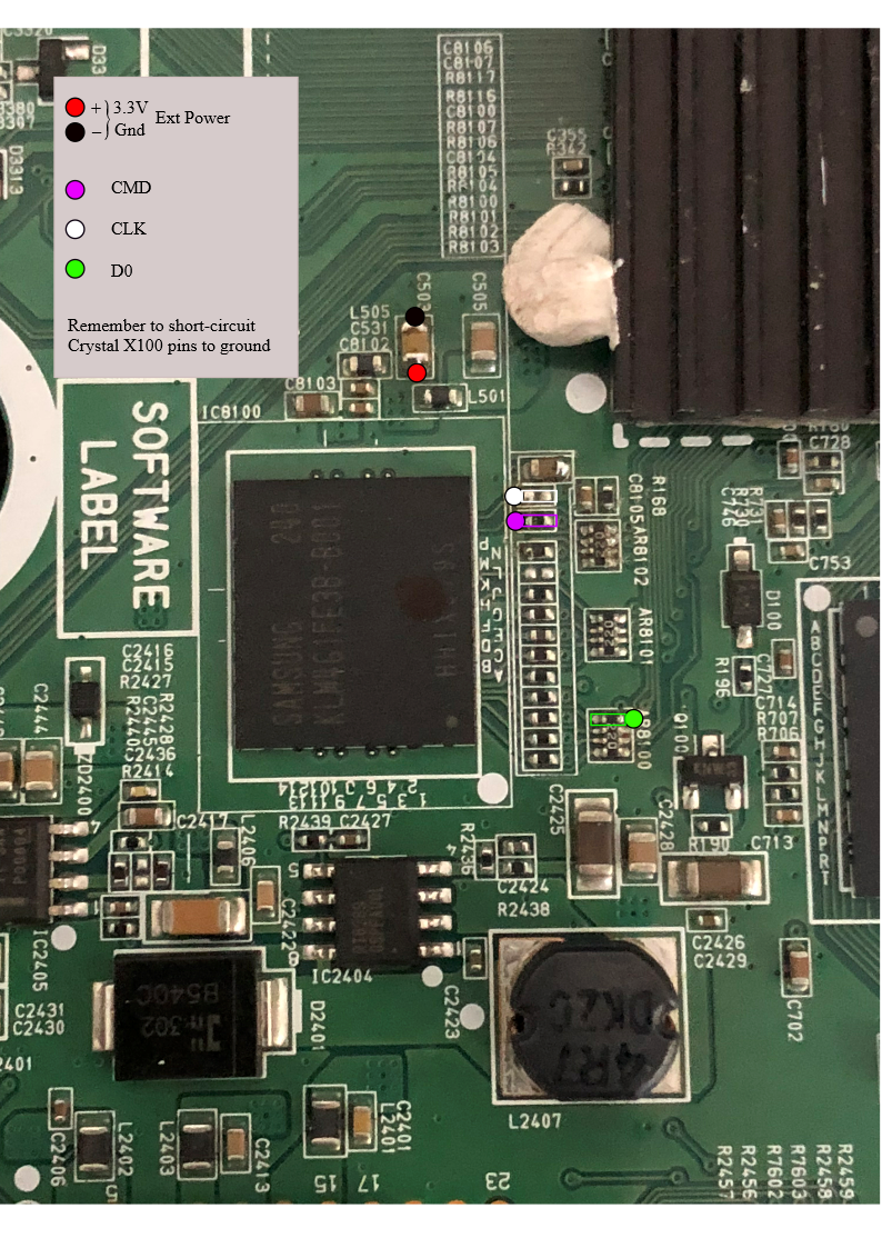

    In one of the topics I mentioned the work layout of probably that eMMC
    :idea: :idea:
    :!: b defective also eMMC, as I wrote and prone to damage ... even when soldering into the board
    - VCCQ and VCC powered by 3.3V (look at the board, pins in eMMC sa tightly together , They are powered by the same single voltage ), remove the system> you will see the connection (photo on the left)
    VCCQ - power of IO lines (a reference voltage to the transistors of the lines D0..D7 CMD CLK) Valid values 1.8 ... 3.3 V
    :idea: you have the SDIN5D diagram ..., the meter in your hand and you will find ... the eMMC points you need

    lisek wrote:
    apparently from bn41-01604cc, incomplete connection of the pins
    Why incomplete? According to me, everything is and correctly marked, I also added RST for TNM5000 users:
  • #22 17455460
    lisek
    Service technician RTV
    Posts: 39995
    Help: 6352
    Rate: 6883
    Incomplete, because the RST on the R1346 / 1346 resistor was missing
    Then it was completed below.

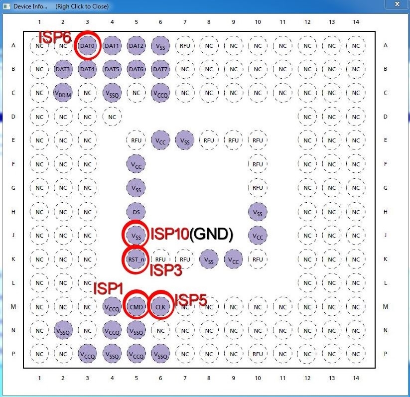

    lisek wrote:
    Incomplete because RST was missing
    Full, my master ;-) for owners of e.g. RT809H who do not use RST:
    However, as you rightly noticed, "incomplete" for owners of e.g. TNM5000:
