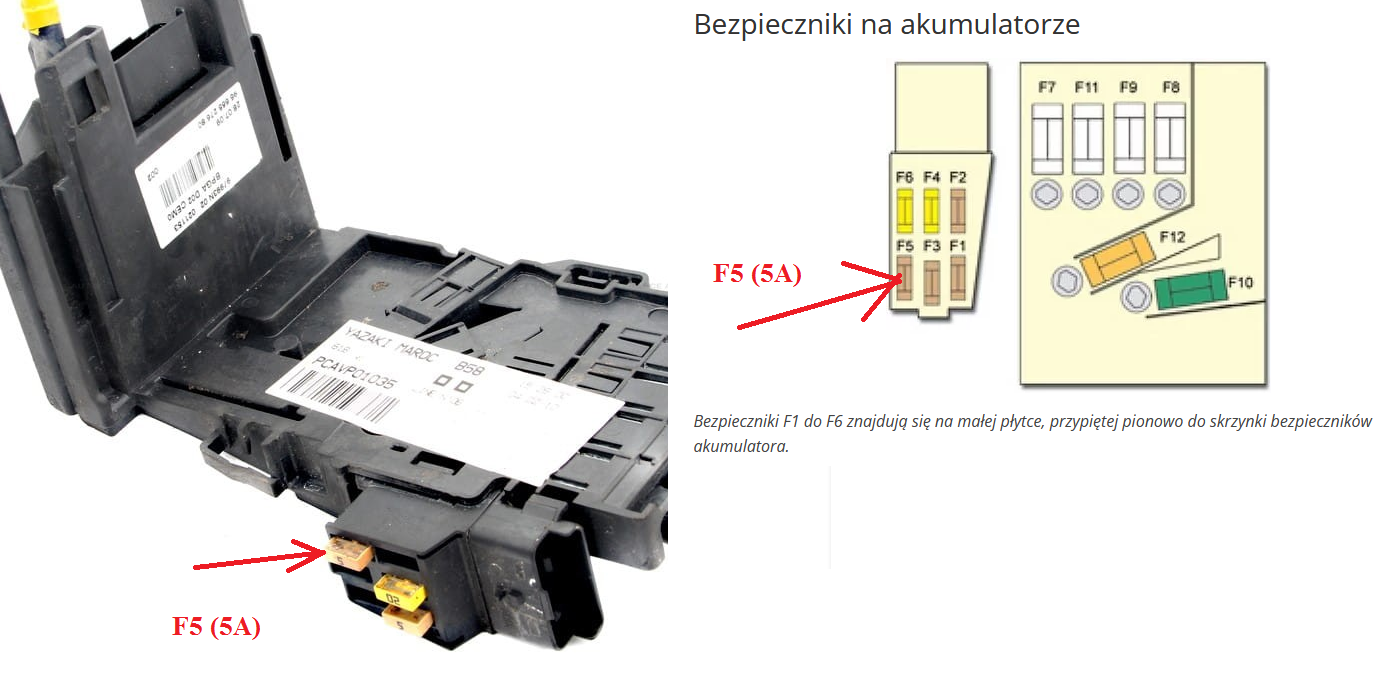

    Hello, I have a problem with my Citroen C4 Grand Picasso, I do not have power on the obd2 diagnostic socket and I can not connect to the car with any computer, my question is if anyone knows where the OBD fuse is located in the C4 Grand Picasso?

  • #5 17721155
    romuald-f
    A/T specialist
    Posts: 2046
    Help: 407
    Rate: 1551
    As the picture shows: Citroën C4 Grand Picasso OBD2 Fuse Location: Power Issues & Diagnostic Socket Troubleshooting

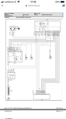

  • #6 17721460
    Damian19771231
    Rate: 11
    Thanks a lot
    I also add the installation diagram
    I think I found a fault. Tomorrow I will share information
    Thank you
    greetings

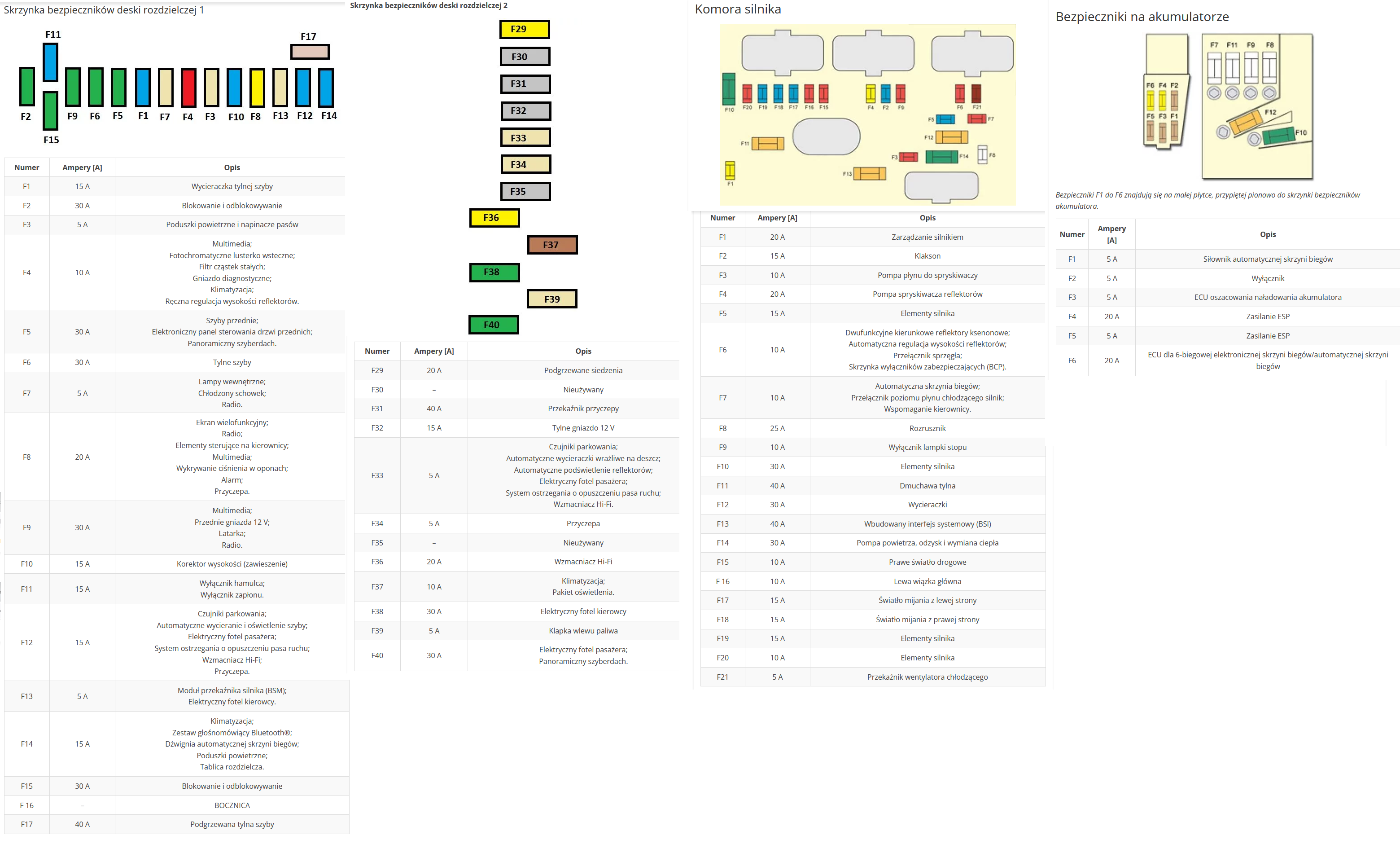

  • #7 20525244
    korsarz50
    Posts: 160
    Rate: 108
    Maybe the C4 Grand Picasso 2008-2012 fuse table will come in handy
    From what which fuse.
    BSI fuses
    BSM fuses
    Battery fuses

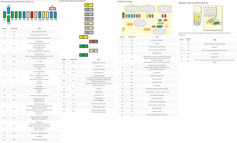

  • #9 20532914
    korsarz50
    Posts: 160
    Rate: 108
    Have you checked the fuse on the battery F5 (5A)? It may be burnt out. Some fuse slots may be empty.
    Manual and automatic transmissions have different fuses.
    Check F2 on the battery.
    In the engine compartment, check F13.

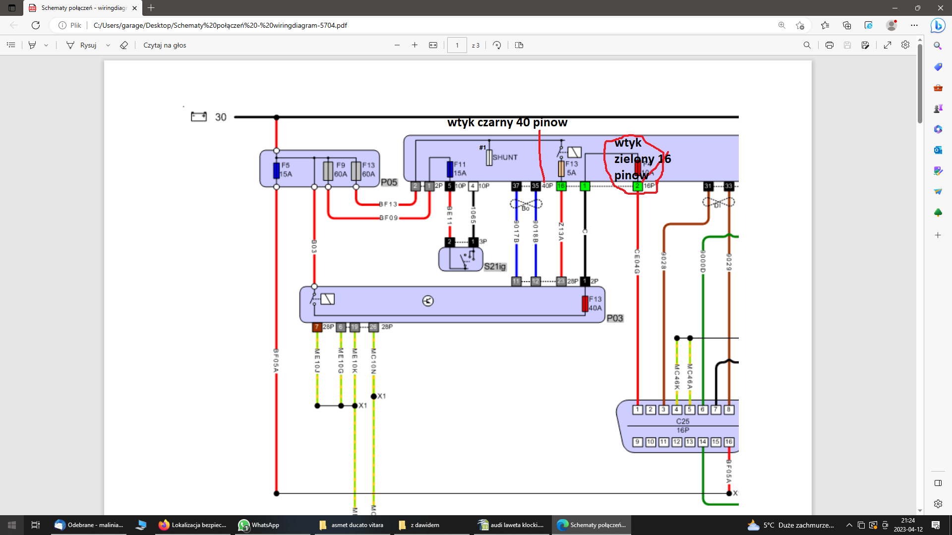

    radoslawdojlidko
    I rang all the fuses I could find and still nothing. The voltage on pin 16 of OBD2 is 0.2V instead of 12V.
  • #12 20535379
    Maliniaktg
    Posts: 51
    Help: 8
    Rate: 18
    from bsi green plug pin no. 2 power comes out? either this green plug or the bsi itself since the rest has been checked
    • Schematy połączeń - wiringdiagram-5704.pdf (99.65 KB) You must be logged in to download this attachment.
  • #13 20536536
    radoslawdojlidko
    Do you mean a plug like in the picture?
    • Citroën C4 Grand Picasso OBD2 Fuse Location: Power Issues & Diagnostic Socket Troubleshooting IMG_20230412_174806.jpg (6.01 MB) You must be logged in to download this attachment.

    #14 20536840
    Maliniaktg
    Posts: 51
    Help: 8
    Rate: 18
    there you have everything described which plug color as you can see and how many pins it has, which would be easy to recognize if it enters the bsi and has 16 pins, then pin 2 should come out plus on obd 2 without any indirect connections on the way
    in this diagram above it is the same, only it seems to me that mine are more readable, that's why I gave it
    additionally fuse f5 fuse box in the engine compartment it goes out on the way there is a connection somewhere but where it's hard for me to say then it goes to obd on pin 16
