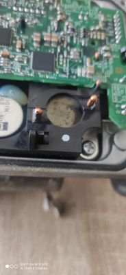

    Hello. I have a problem with electric power steering citroen c3 picasso 2011 1.6 vti. The problem appeared from nowhere, namely while driving the message fault steering appeared and my assistance turned off. I went aside the station, disconnected the battery for 5 min and nothing. Somehow I got to I changed the fuse at home and everything was ok but only apparently because after 5 days the same. again the same process and I thought it was ok but I barely drove a bit to the store and the support disconnected again ... I did a little shopping and everything ok. after driving a few hundred meters again disconnected, I pulled aside I turned off the engine and again everything ok ... ... what could be the reason for this problem ??? if anyone had a similar problem or knows what it can be, please help. Regards

    I understand that it doesn't burn a fuse.
    Read the errors and you will know what is missing.

    I am after a visit to the mechanic and it turned out that the computer does not read the driver driver at all .. any suggestions ??

  • #15 20219312
    blankchoice
    Rate: 11
    Sent for regeneration. The cost of PLN 600. Repaired, checked, programmed from scratch and with a guarantee. You put on 2 screws, 3 plugs and a hula.

    You have to unscrew it, throw it, bend the heat shield of the exhaust pipe and bend the pipe to the side by force and it will come out. 2 mechanics pressed me that the engine must be pulled out or the sledge should be knocked down.
